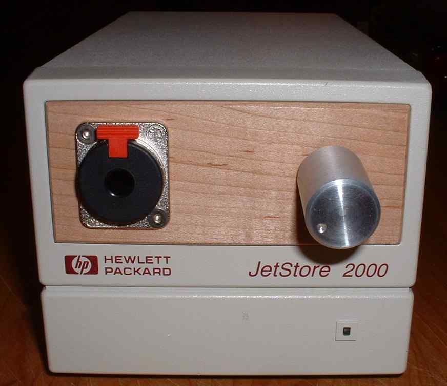

I removed the tape unit and put the Neutrik jack and volume pot on a little maple wood plate. I'll put a piece of aluminium over the HP lettering later. There is an already built-in led. I'll replace it for a blue led.
Thanks Tortello for your nice desing and sharing your PCB's and thanks Mr. Pass for letting us using your ideas.
Here the front panel.

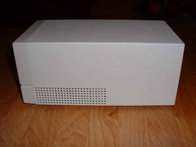

This is a view of the case's inside. It is divided in two main sections. On the back they are already built-in EMI filter, main power switch and a nice little 12Vdc fan running on ball bearings, the HP way 😀
I'll keep the fan running at low speed if I need it. On the bottom I'll mount the 2 channels PCB's. The two IRF610 FET per channel will be mounted directly on the case bottom plate to use as an heatsink. The case has plenty of ventilation in this section that use to have a power supply. The fan is designed to cool this section in particular.

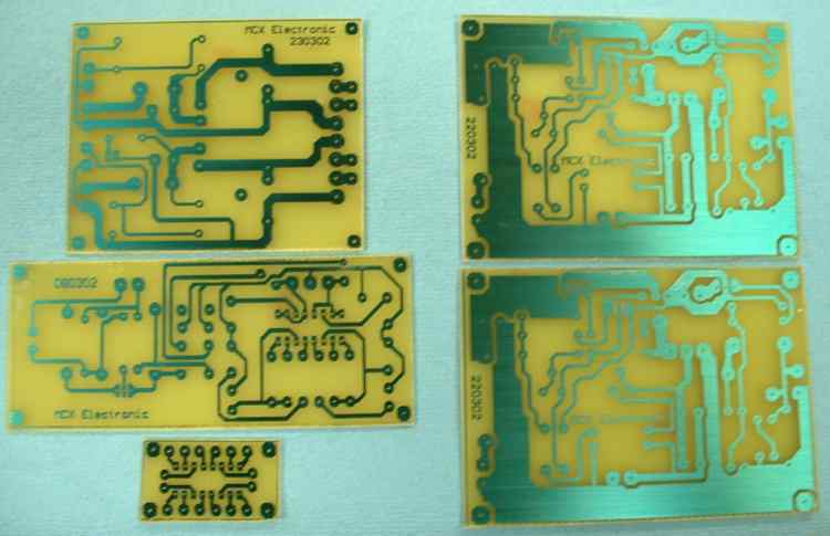

The project wouldn't be complete without some nice PCB's. Tortello did the original desing, Thanks to you. Since I had only the PCB images, I used PaintShop Pro and cut and paste, to do some slight modifications to the PCB's.
I increased all main supplies traces on the Supply and Amplifier PCBs. To the Supply PCB, I replaced the rectifier diodes by bridges, I increased the filering caps to 10,000uF, added the option of adding an other R-C filter to the already built-in C-R-C supply filtering. I plan to remove all supply noises as possible, since headphones are very sensitive. I also added a drop-out voltage resistor and a connector for the fan supply, if needed.
On the Amplifier PCB, I increased power traces width, added an other input cap in parallel (if I want to try different input caps, with or without bypass) and I increased some pads dimensions.
On the EQ-Timer PCB, I increased some pads dimensions, reduced the PCB width (to fit the PCB in the case top section) and added the option fo connect a multipair cable to mount the DIP switch remotely. I did also a small PCB for the switch.
Here the etched PCB before drilling and assembly. I got all the parts in stock and should start to assemble the PCB this week.

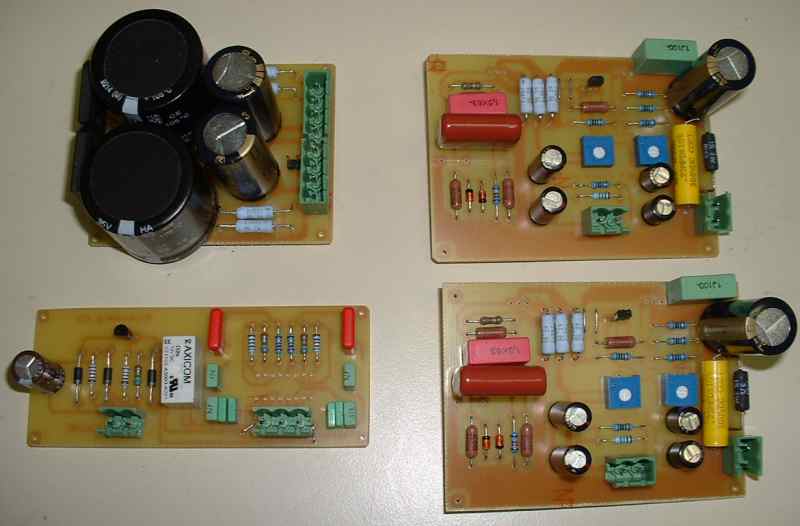

All the PCB are completed and working perfectly.😎
I installed matched IRF610 FET. They are mounted under the amp PCB and will be mounted on the case's bottom plate.
I checked them using a square wave and they seems OK.😀
I'll do measurements in a few days. Here the PCB view.

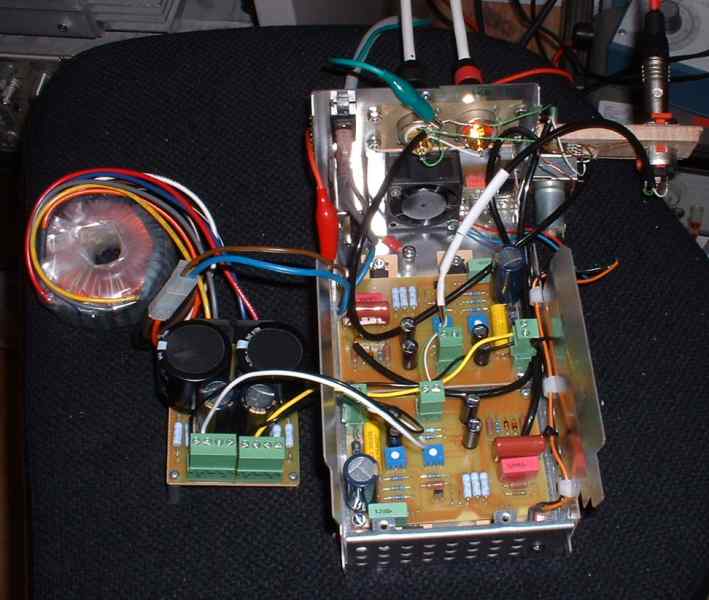

Thanks for your good words. No listenignsession yet. It is almost 36C these days and I'm spending my days in the pool. I'm working a to mount the PCB in the case for the moment. Maybe, by monday, I'll have some impressions.
First measurements and listening test of my prototype. Sounds superb, big and fast bottom end, sweet hights. The female voice just stand in the air. And this is a brand new one unit, not even burn in. There is no noise in the background with volume at maximum. The CRCR supply filter seems to work Ok.
I'm using rather standard input coupling caps and pot. Input are Panasonic metalized polypropylene (2.5uF) with ERO polycarbonate (1.5uF). Pot is a standard plastic film and output caps are Panasonic FC. I'm using a pair of Grado SR-125. The Equalizer is not connected yet.
Bias is set at 200ma for now. At this bias the FET are at 50 deg C
I'll let it run for the night at that bias, then if it survive, I'll increase to 300ma tomorrow 😉
Here a few measurements (bias 200ma, in 33 ohms load):
Supply Volt (At the amp): 22.2Vdc, ripple 1.5mv
Bandwitdth: 5Hz to 22Khz
Harmonic Distorsion (1Vrms output): 0.3%
So far my first impressions are very good indeed. A very nice little project. I'm feeling I'll like this amp a lot.
Thanks again Marcello Pellerano and Mr. Pass.

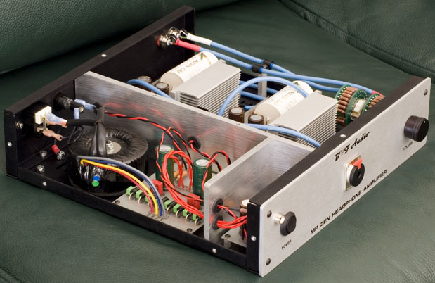

I almost completed the complet assembly of the amp. A few days ago, I completed the supply and transfo mounting. I also installed external wires that connect to the input caps PCB junction points.

Bryan, that amp of yours, wow! Really nice work
IMHO, one of the most beautiful!
Marcello
