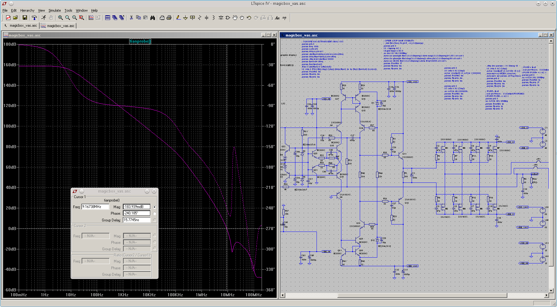

Loop unstable
Dear Magicbox,
very interesting design.
Loop is currently unstable due to phase shift > 240 degree.
Hope you get the loop stable. Attached the current schematics with "TianProbe()" function in "plot.defs". Initial asc file was from post #83.
I have added my functions so you are able to do many measurements with a simple "uncomment/comment" a block. For more information about
SOA, OLG, LG, PM, GM, FFT have a look at:
http://www.diyaudio.com/forums/soli...ormance-class-ab-power-amp-200w8r-400w4r.html
There you can find many design hints which may help.
BR, Toni

In my opinion MagicBox did loop gain correctly. If done in that way it looks like TPC loop gain(as it should be). Certainly local loop gain plot could help too.
I never have stability proble with the real amp after this kind of TMC loop gain simulation.
By the way if MagicBox activate grid and Anravel Branch Wrap in his Waveforms it'll be more readable.
