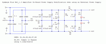

Hi Marc,
The board was designed with the on-board capacitors and rectifiers to make it easier to wire without the wiring clutter of an external PS. Take a look at post #32 to see what I mean. You can see how clean it all wires up, hook up the transformer and your ready to go.
If you would like to use external PS (illustrated in post#34) the on-board capacitors will provide 9400uf of extra AC filtering per rail. You can even use a 0.1ohm or 0.2ohm resistor in place of one of the rectifiers on each rail to provide some additional filtering. Keep in mind that for most applications 9400uF per rail is enough. Now If your using the DTV version driving speakers with 4ohms consistently at high volumes or running the amp with a an Iq of 75mv or above across each transistor pair then an external PS makes sense.
I’ve attached a schematic to illustrate how to configure the on-board PS when using an external PS.
Al

Ok Al than no need to reroute. I love the idee of the aditionnal CRC filtering and possibility to mount double rectifier bridge.
Marc
Marc
That's good but 2x6800uF per rail for a 60 watt amp is overkill. The rule of thumb is 1000uF for every 10 watts of power. Lets leave things the way they are. Trust me I put a lot of time into this design, some of it dating back to 2006, to make sure that everything is just right.

Even i want to drive or expected to drive 4ohms or near 4ohms speakers? The power i expected is 70w/8ohms and reacheable 140w/4omhs for home application.
Marc
that's where we disagree.That's good but 2x6800uF per rail for a 60 watt amp is overkill. The rule of thumb is 1000uF for every 10 watts of power.
I recommend +-20mF per 8ohm channel or +-40mF per 4ohm channel.

Hi Andrew,
I don't disagree with you; you’re basically doubling the rule. What really matters is what sounds best to you.
But there are some commercial designers like Randy Sloan, and Hugh Dhein that pretty closely follow the rule of thumb. In the case of Randy Sloan he states in his book that the rule is overindulgent and goes on and says that 6800uF per rail will provide excellent results from a 100watt RMS amplifiers.
It's a matter of preference.
Al
Al
