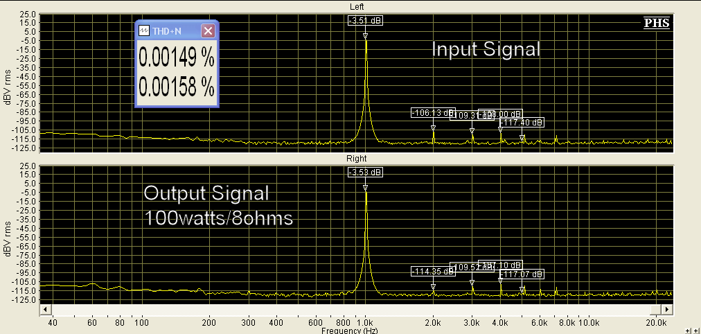

I'm away from home for the Thanksgiving holidays, I'll run the IMD test this weekend when I get back. Do you have any specific frequencies that you'd like me test?

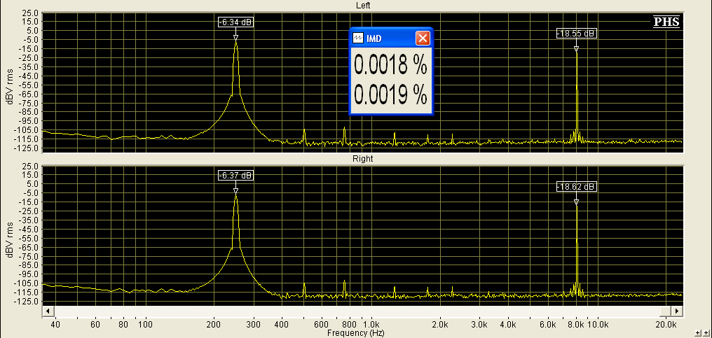

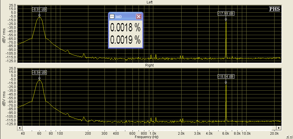

Hi Al,

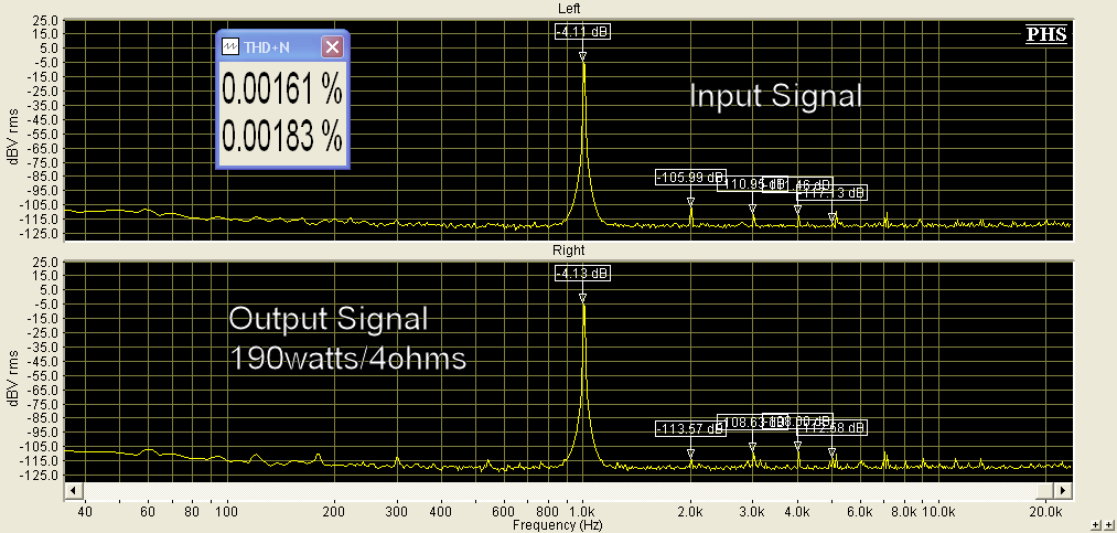

Please use: 60Hz/6kHz and 250Hz/8kHz
Amplitude ratio: 4:1
I am confident that this IMD measurement will also show fine results.

Hi Piersma,
Attached are the IMD plots you requested. For each picture the top plot is the IMD of the input signal, the bottom plot the output IMD. Each was taken using an 8 ohm load.

Hi Al,
Thanks again for doing the IMD measurements, I am satisfied by now 😉

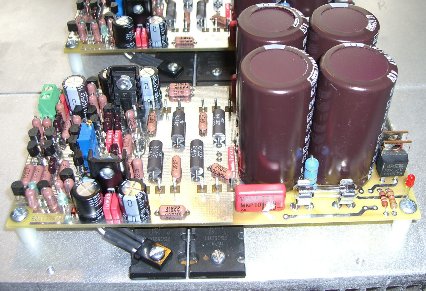

Hi All,
Here a pictures of the dual pair transistor version of the design. I added 0.865" to the length of the board to accommodate the extra pair of output transistors. The board now measures 5.865" x 2.95" including the power supply. The new design does require a heatsink with a 4" height instead of the 3" like the single pair.
Al

Have you proceed to transistor matching (front end or output devices)?
Marc

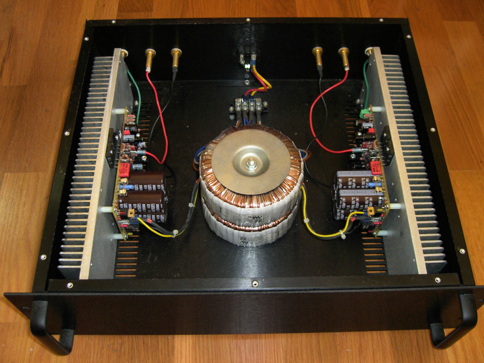

Here's another picture of the dual transistor version (DTV) using a single transformer and my external PS. The on board PS rectifiers are bypassed. This is a nice option to have if you have a single transformer with at least 450 to 500VA and would like to beefen up the power supply reservoir capacitance.
I get absolutely no AC hum even with the inputs floating and my ear nearly touching the dust caps. Pretty amazing! The sound just blows me away.
The question for those interested in the group buy, which amp would you prefer? I like the (DTV) because of the extra power, and the way it handles the low end of my MTM speakers.

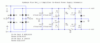

It can depend on the need or not of output device matching, the possibility or not of using MT200 (Sanken) output device. I suppose that the DTV can switch to MTV by ommitting some parts. Why do you bypass the on board PS rectifiers? If it's necessary why implement it on board?

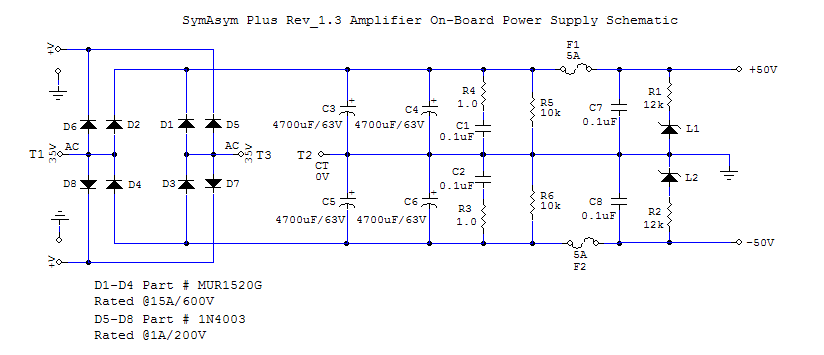

Hi Marc,

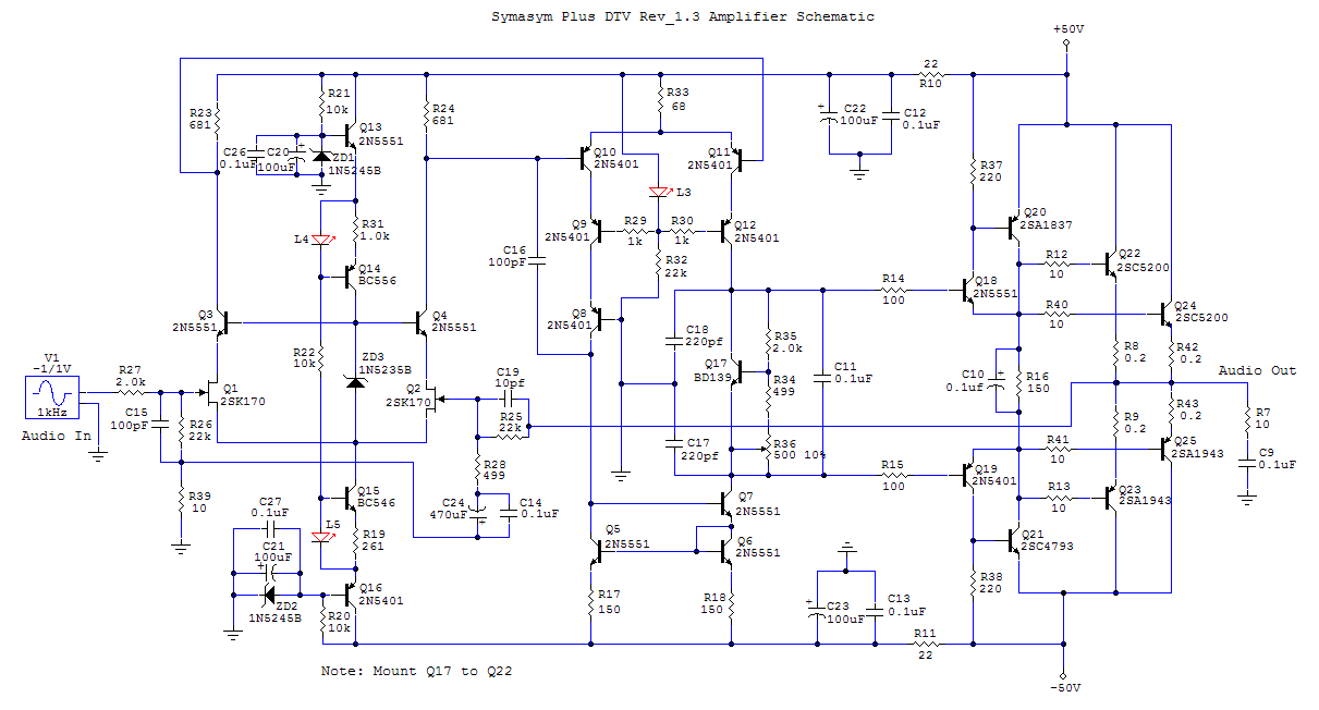

This amplifier requires more transistor matching than most because of the cascodes. But you do have the option to bypass cascode Q3,Q4 in differential section, and Q9,Q12 in VAS section if you'd like. In the differential section without Q3,Q4 you'd have to drop the rail voltage to under +/-40V, +/-36V being optimum, or you can replace the 2SK170's with 2n5551 keeping the +/-50V rails but you would have to add an AC input coupling capacitor in position C25. I left out C25 on the schematic but it's on the board. You also don't need to match the output transistors if you use a single pair. The other transistors that need matching are Q1 and Q2, Q10 and Q11, and Q5 and Q6.
I'm not familiar with Sanken devices but I would be happy to provide you with a set of new Toshiba 2SA5200/2SC1943 for about two bucks a piece, and match all the small signal transistors for a small charge.

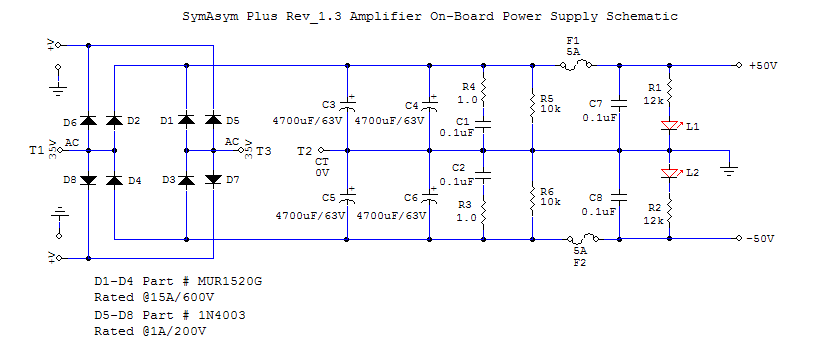

I've attached the on-board power supply schematic, and the DTV amplifier section schematic.
Al
P.S. I'm calling this new version of SymAsym, SymAsym Plus. If anybody can think of a better name please enlighten me.

On seeing the cap filtering value i understand why you upgrade the filtering cap. With 25,4 mm i don't have in mind filtering cap with over 4700 value, May be 6800 panasonics...
