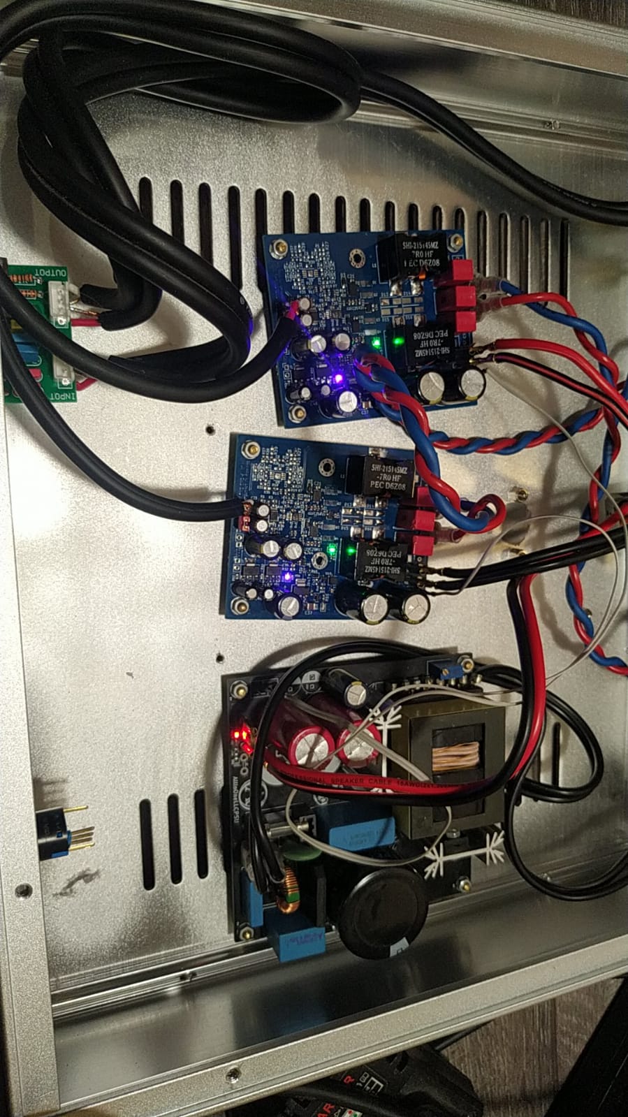

What are your plans for this design? Will you start a business, or is it just a hobby? Have been reading about GaN amplifiers, and I am interested in getting one, but they are more money than I want to spend. It seems that the parts cost is not so much, and the price is due to low volume.
Hi amigos,
I asked DrMordor to provide a dual Mono Gan Amp with his last SinchroRec PSU.
I will make soon a review VS Purifi amplifier.
I also have the attention to expose the Gan amp to the "La Maison du Haut Parleur" shop during January, to have the advice of expert ears in their show room.
It is a reputable store in Lyon and Paris.

Most likely I will sell several, maybe in the format of a group buy.
