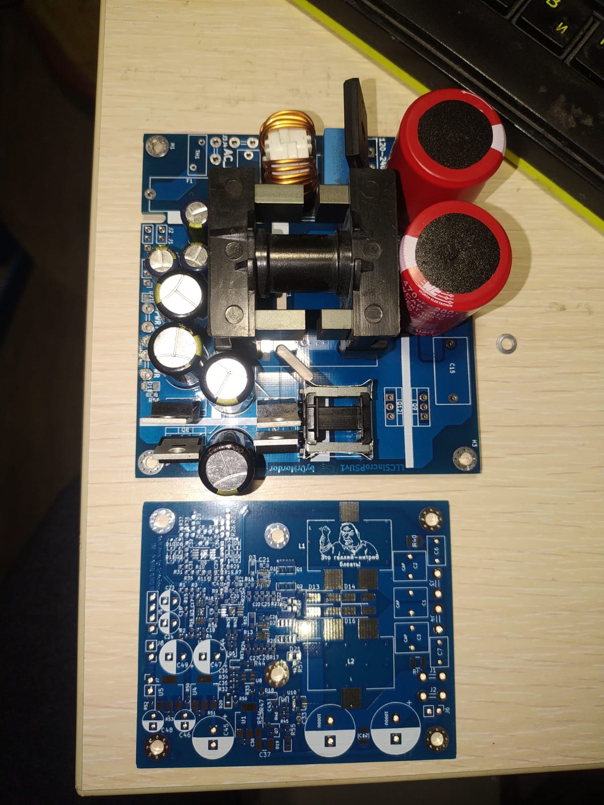

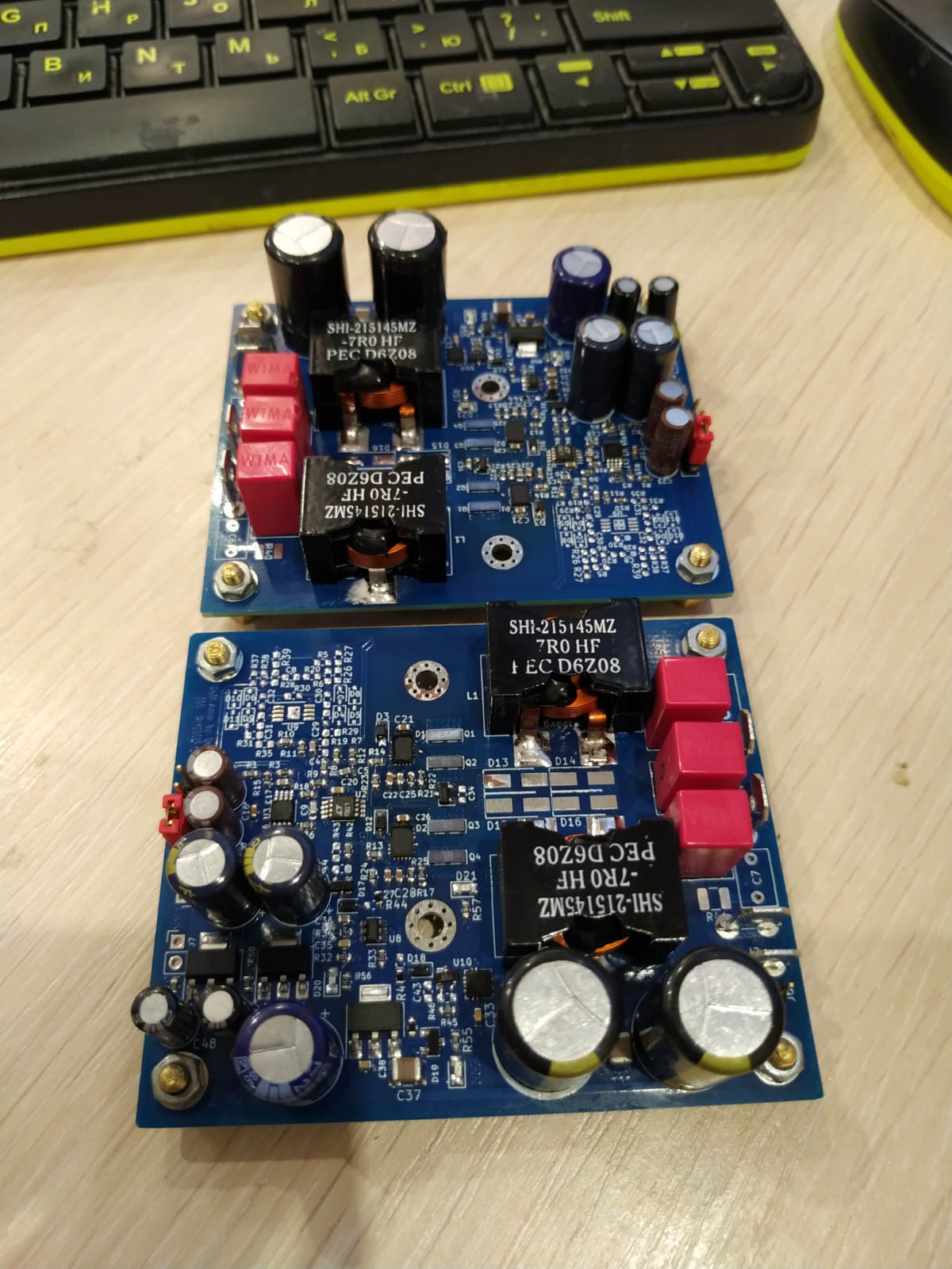

The design is actually not very complicated.
Comparator and 3 gain loops

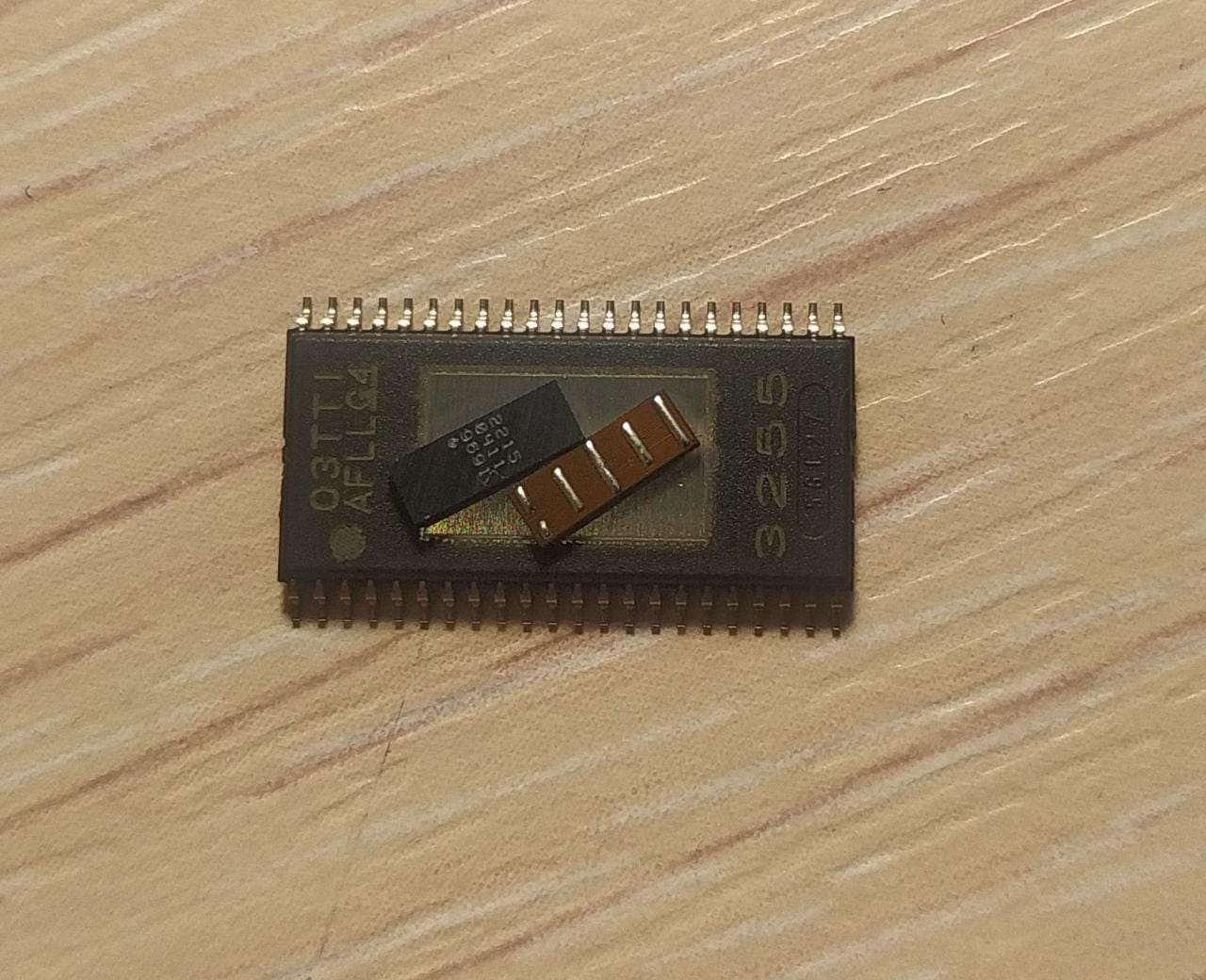

The choice is based on availability.
Russia is under sanctions, the choice is not great, even these components had to be bought through intermediaries.
But in fact the LMG1210 driver and Fet EPC2215 are very good for building an amplifier up to 600 - 800 watts of power.
There is also protection against overload and overheating. And DC-protection if use my SMPS

Nice built. It's because there are people like you that make this site popular😀
