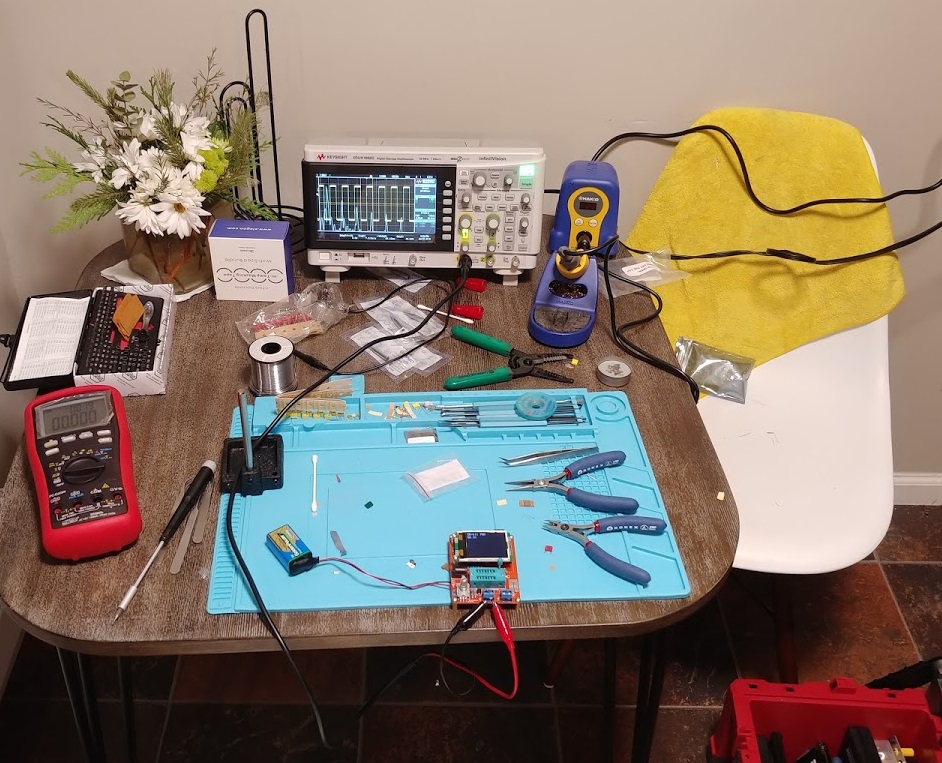

My new Oscilloscope Keysight EDUX1002G
My current scope is the same as OP and I absolutely love the thing. Honestly, at US$647for the model shown above, it is a VERY high value scope. While you can get more features for the price from some of the Chinese OEMs, typically the quality isn't as high. Don't get me wrong, both Siglent and Rigol are making some solid stuff for the hobbyist with features at a performance/$ which are unmet. That being said, normally, both build quality and firmware robustness are much lower than Keysight. Additionally, frequent updates to the Keysight firmware have fixed a few bugs that slipped through and added some additional features (like the free DMM software option). Attached a picture from my analysis of my $20 component tester build, the Keysight was damn easy and enjoyable to use.
As an aside, to some degree this scope IS hackable to the DSO versions by changing a couple of resistors. This gives you the extra (2GSa/s) sample rate, memory depth (1MPt), 70MHz bandwidth, and segmented memory. That being said, the additional trigger functions and changing the frequency bandwidth to higher freq such as 100MHz or higher requires a lot more work (though is possible).
See this thread: EEVblog #978 - Keysight 1000X Hacking - Page 1 for more details.
As an aside, something that I have found funny is that Keysight's own employee Daniel Bergdanoff chimes in from time to time in several of the hacking threads. In this one, he just comments that Keysight did not give any information to Dave about how to hack. In others, he has clarified points about hardware or Keysights position on something, giving historical data about products being hacked, and a few times to give actual insight into weird results that were found via hacking.

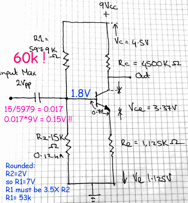

It’s seems that my calculations work but I have to raise the Vcc by 1 - 2 volts. The circuit I posted ....
Don't compute 4-digit precision before you work it out on two thumbs. It is FAR too easy to slip a decimal place. They pile up under both sides of your desk.
Your drawing has a 100X error. chip_mk has already called it out, but here's my fumbled attempt to confirm your calculations (attached). 2-thumb figuring gives "about 53K", NOT "5979K"... error of 100. Using more fingers I like "60K" better.
The input overload will be very-nearly the drop in Re, unless Rc swing bottoms the transistor first. With Re a not-small part of Rc, 4.5V is not the optimum center point.

Thanks very much for taking time to look over my attempt at calculating the circuit posted. I appreciate your knowledge of what is still new territory for me.
I also realise I have strayed from my original post and rather than discussing my new DSO I’m also getting lessons in circuit calculating.
Rather than continuing off topic I’ll leave this thread to the Keysight EDUX1002G
And start another thread based around basic amplifier stage calculating for beginners.
I’ll go do some work on the common emitter circuit then open a new thread, titled “basic amplifier stage calculating for beginners” If yourself and or any others members are interested in offering your assistance that would be great.
Thanks again
The circuit I posted works at 9 Vcc but the input range is 300 - 550 mV. I’m trying to work out how to raise the input voltage without it clipping. Simple beginner mistakes, No formal training, just a desire to learn.
