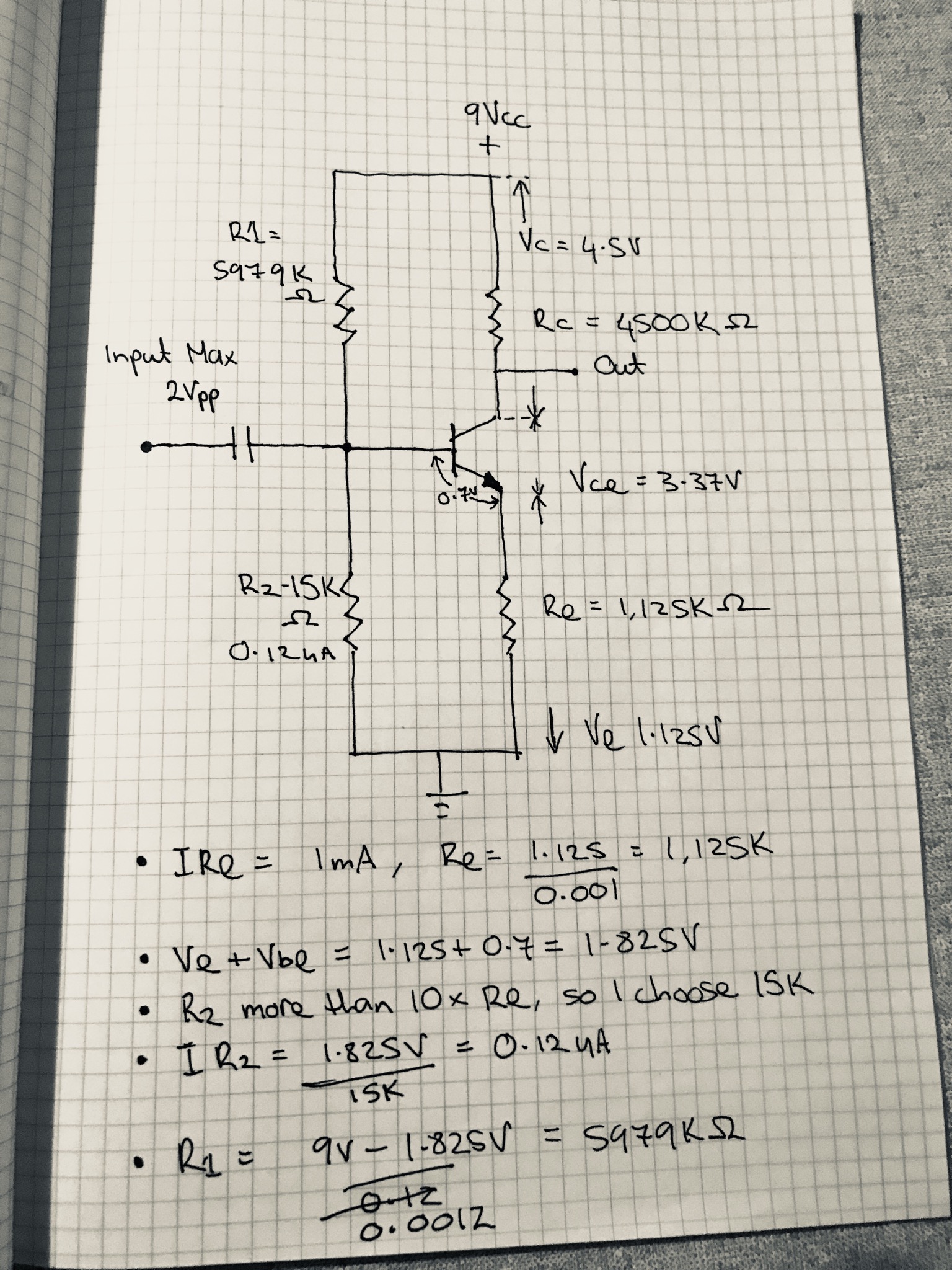

Which happens a lot as I’m still wrapping my head around calculating a voltage devider common emitter circuit. I manage to get them going eventually but only after tweaking the Vcc and input signal Vpp. This is where the scope saves the day. It seems I’m always off by around 1 - 2 volts Vcc.
Any suggestions for the beginner friendly method for calculating, would be appreciated. Thanks gang, you’re all great 🙂

We would have to see the circuit to see what it is you are trying to calculate 🙂
Thank you, here is the latest circuit.
Thanks. When you say you are always off by 1 to 2 volts, what parameter are you looking at ?

It’s seems that my calculations work but I have to raise the Vcc by 1 - 2 volts.
The circuit I posted works at 9 Vcc but the input range is 300 - 550 mV. I’m trying to work out how to raise the input voltage without it clipping. Simple beginner mistakes, No formal training, just a desire to learn.

Approx. calculations with assumed Ib ~ 0
I * R2 = 1.825V
I = 1.825V / 15000 = 0.000122A
Also
I = Vcc / (R1 + R2)
R1 + R2 = Vcc / I
R2 = Vcc / I - R1
R2 = 9V / 0.000122A - 15000ohm
R2 = 58770 ohm (the closest standard value is 56k)
Next
(Vcc - Vc) / Rc = Ve / Re
Rc = (Vcc - Vc) * Re / Ve
Rc = (9V - 4.5V) * 1125ohm / 1.125V
Rc = 4.5 * 1000ohm = 4500ohm (closest standard value 4k7)
I guess OK res values for Vcc = 9V would be:
R1 = 56k
R2 = 15k
Re = 1k2
Rc = 3k9

Thank you very much🙂

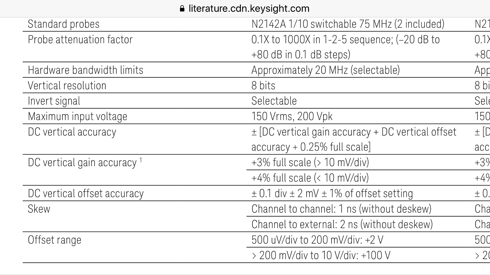

Analogue measurements. Your voltage readings should be pretty close. I think it uses an 8 bit word to determine the voltages. Early analogue scopes were not very accurate, maybe 2% for the best ones, like a Tektronix 2465A or B, or the 465's. Your scope is accurate enough for most measurements. Look up the voltage measuring accuracy in your manual. Please post it as I'd like to know as well as many others here.

Yep I’m a happy Chappy, very lucky to have this scope.
Heres a screenshot from the spec sheet.
