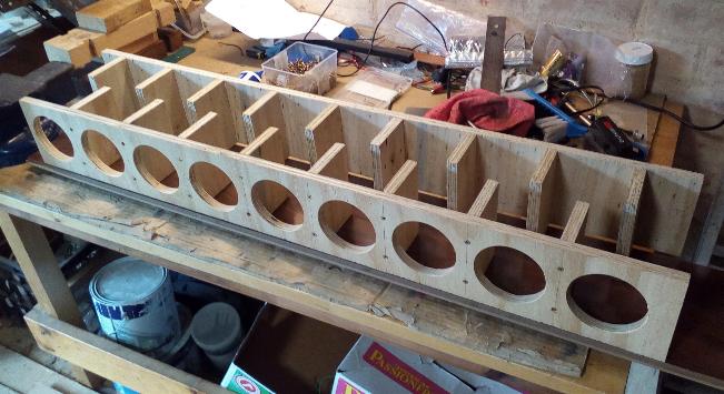

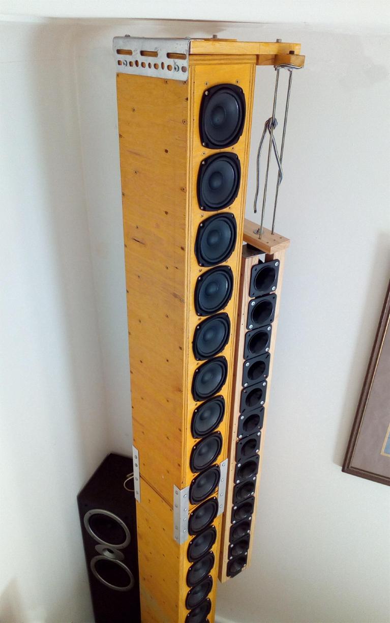

I feel compelled to join this forum, as I have just completed a system with arrays. I have followed the rules and advice set out by Jim in his ‘white paper’ and read also about Roger Russell IDS-25 and his work with McIntosh.
I have also read a lot of pros like the dynamics, the wide soundstage; and cons, like the comb filtering, the lack of lows, the cost. I had to find out for myself, and this is the result below.
The main arrays go from floor to ceiling, are made of heavily braced 16mm plywood and use 18 GRS 4FR-8 full-range 4-1/2". The tweeter arrays are 1.2m long, use 12 (similar to) GRS BT2-8 3-3/8" Horn Loaded Bullet Tweeter and are suspended from the top of the main arrays for alignment and uncoupling.
The subwoofers use 4 7” drivers each.
It looks rough but the whole thing is concealed behind a light curtain.

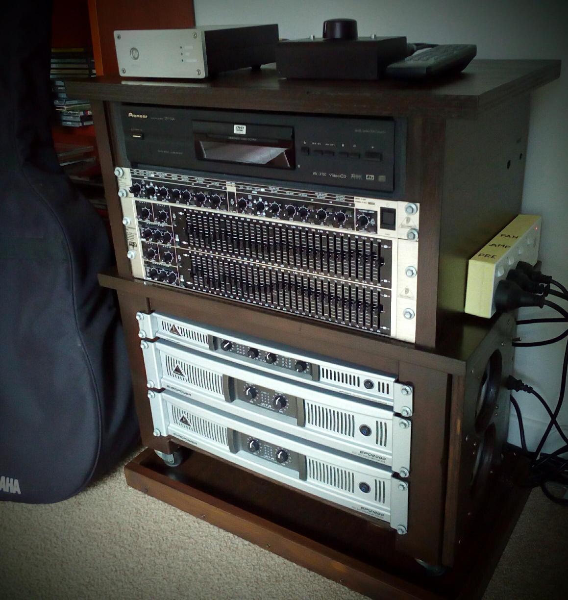

To run all that I have: DVD player as transport, DAC, pot, EQ if necessary, 3-way electronic crossover, and plenty of cheap watts: 2x250W lows, 2x500W main, 2x60W treble.
The cutoff frequencies are currently: 90Hz and 4500Hz, giving ranges of about 2, 5.5 and 2 octaves.
I have tried using the main arrays as full range, and it’s not bad but some EQ is needed in the highs. A subwoofer is necessary below 100Hz.
I am very happy with the result, and as Jim says (Roger Russell too), the comb filtering is negligible/inaudible from the listening area.

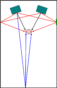

It's easy though to get sharp pin pointing with CBTs too if that's a desire. You simply add two absorption panels on each side walls. No vertical treatment is really needed. The benefit of ceiling treatment is mainly below the schroeder frequency.
hello I am in the process of preparing for a build in about a years time. In your post you mention adding two absorption panels on each side wall. Am I correct in thinking you are referring to the side walls of the curved array cabinet? Thanks.

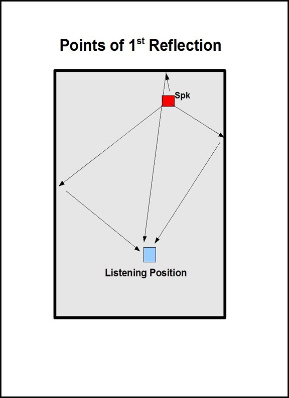

Absorption panels should be at reflection points of each speaker. You can also consider to absorp (or diffuse) the opposite side wall, depending on the distance.
You'll find them with a mirror (mirror image of the speaker at ear height).
Ideally treatment should be broadband, meaning highly effective down to the Schroeder frequency. With traditional absorbers this requires 5" (15 cm) depth. Or RPG sells Broadsorbor which absorps lower in frequency with less depth and you get away with 3" thickness with quite equal result.
You should considering treating the rear wall as well. Type of better treatment will depend on distance.
