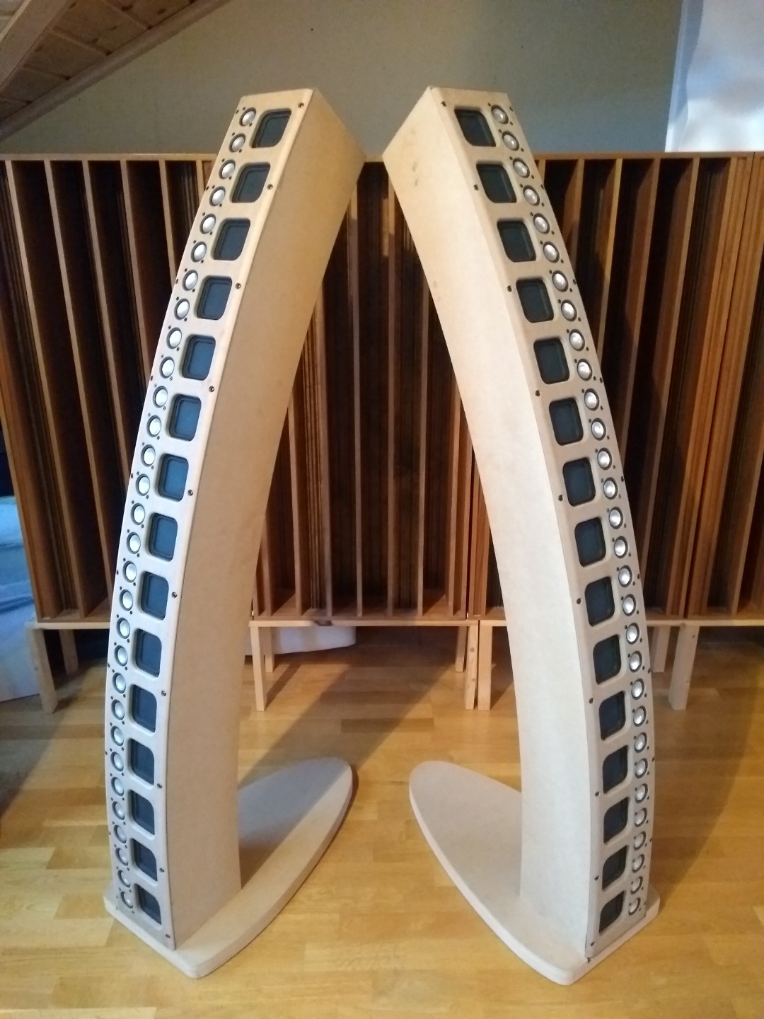

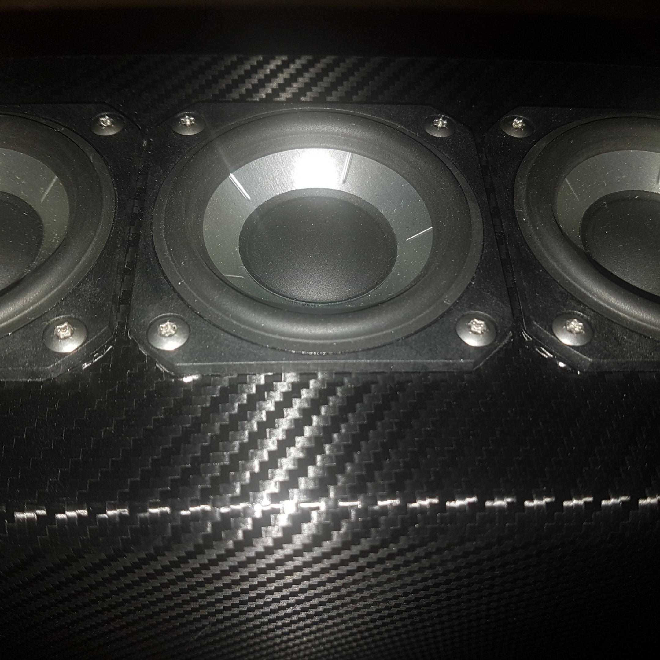

If you study commercial line array designs, you can consider the AudioMachina XTAC floor to ceiling line array project. The XTAC individual modules have 6 drivers and are listed as 15.625" long. Hence, their c-t-c spacing is 2.604".
The XTAC drivers appear to be slightly smaller that the 2.5" SB65 units so they are likely in the 2 to 2.5" diameter class units.
Compare those dimensions to the c-t-c spacing for the Modified CBT24 which is 2.625".
AudioMachina >> XTAC

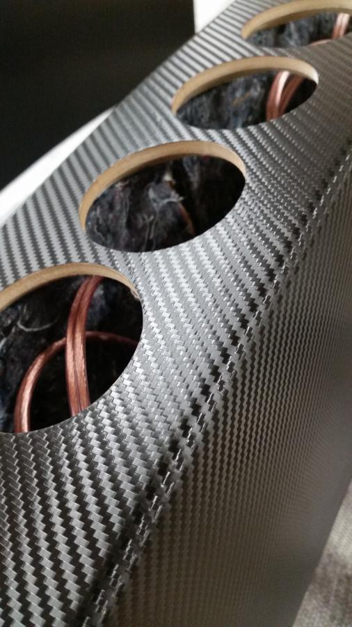

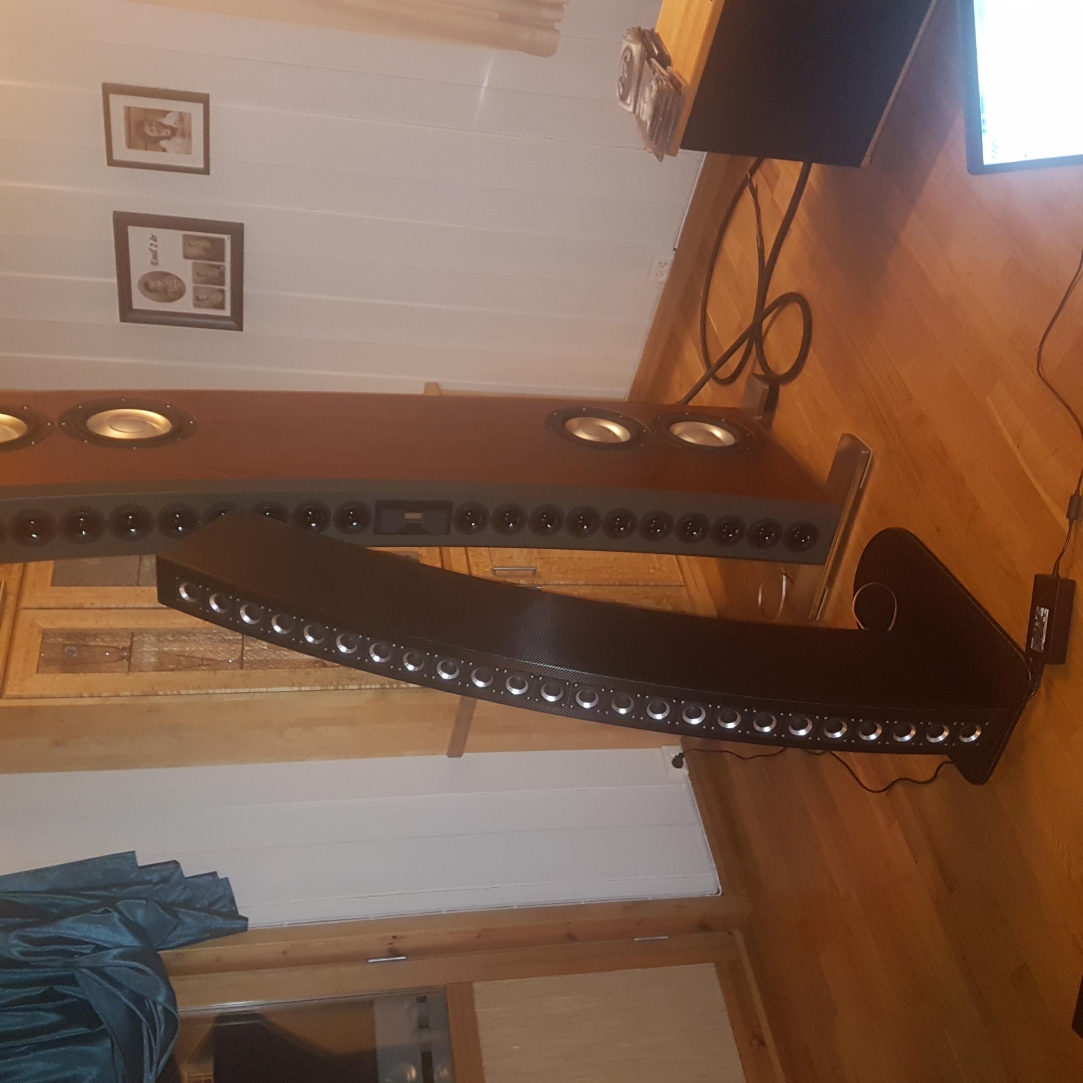

Those are beautiful! Is that a carbon fiber wrap?
You will like the sound as well.
Jim
Thanks on the behalf of the builder/owner (Overn) !
Yes, we did like the sound which is all over the room. We "borrowed" subs (16 X 10") from the "Bendits" (concave 3-way line sources).
These wonderful small dynamite drivers may be useful for any array. Wrappings are carbon fibre wrap from car pimpers workshop.

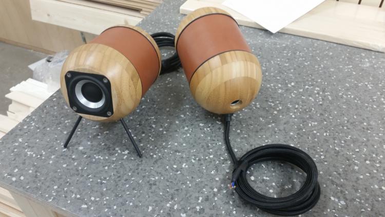

Pictures of your creations (and the IKEA-coconuts from last year):

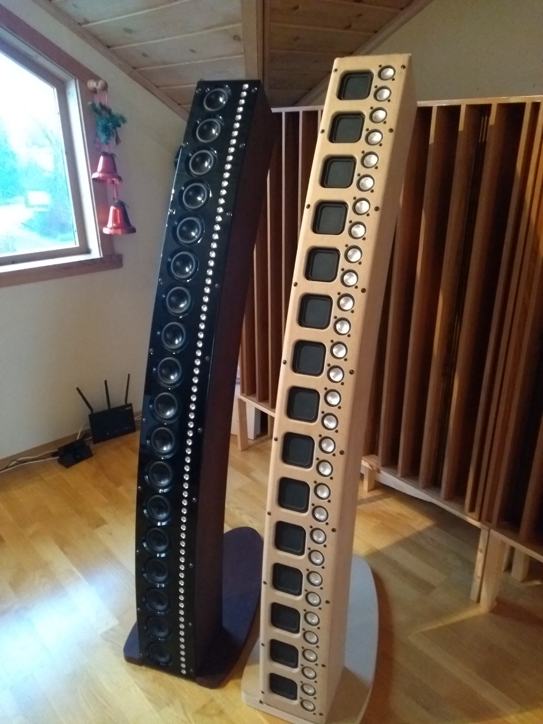

Again this confirms Don Keele's comments about the coverage of a CBT. Constant beamwidth, constant directivity, constant coverage, constant radiated power/"

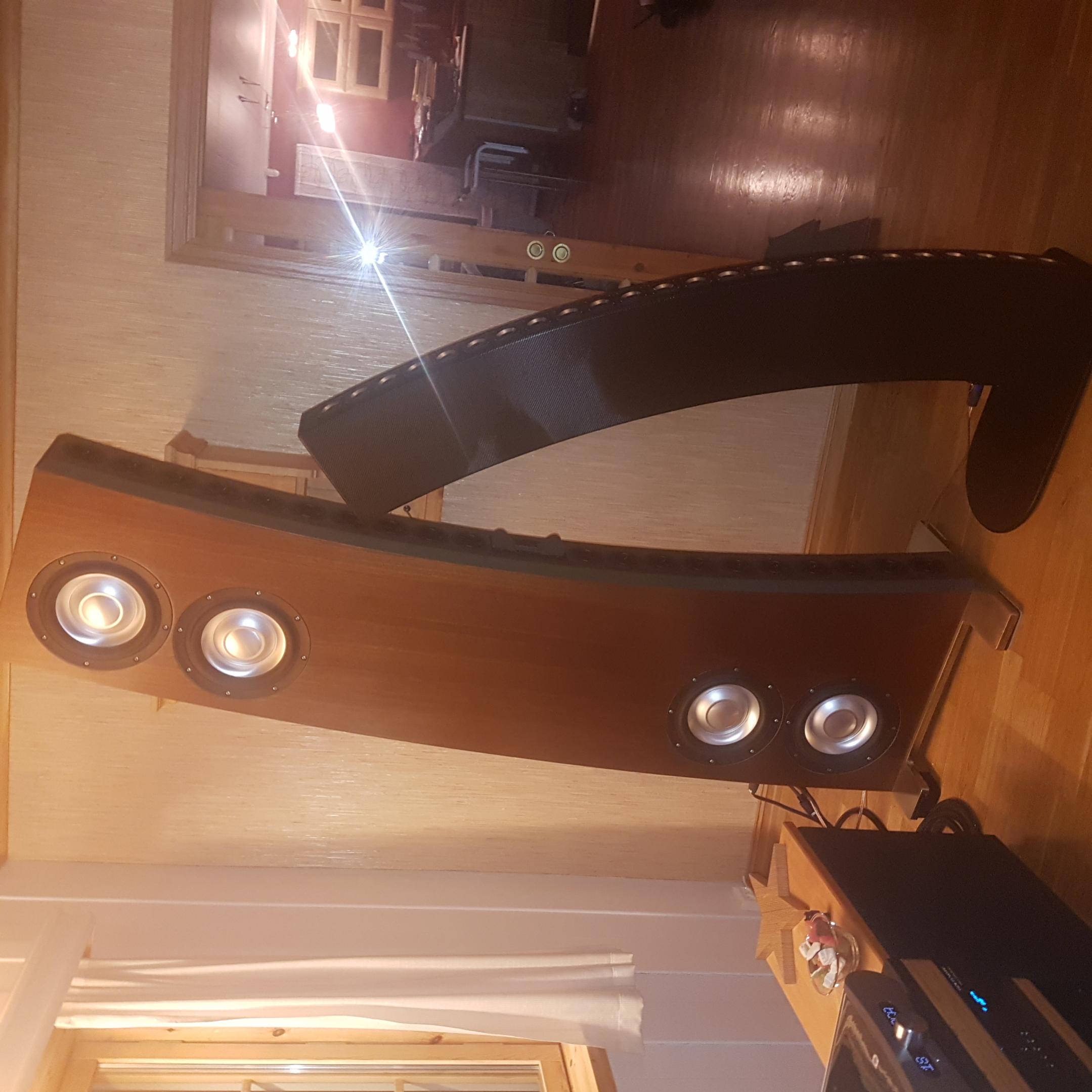

I'm hearing the same sound in my listening room with my CBTs. Your CBT creates a 'sweet room' effect versus just a 'sweet spot'. That is direct contrast to your concave 3-way line source project you pictured which yields a focused sound.
Omholt's two-way CBT is a great solution if you wish for robust full range bass coverage in a single enclosure. I suspect that the new two-way design is superior to Keele's earlier CBT36 arrays which adapted small metal cone computer speakers as tweeters.
I have compared them neck to neck. The CBT36 kit was a great offer (the kit being sold now has a poorer cabinet construction than the former unfortunately), and the small tweeters pushes lobing so high in frequency that's never an issue even near field. However, I personally find this prototype CBT some steps above the CBT36.
