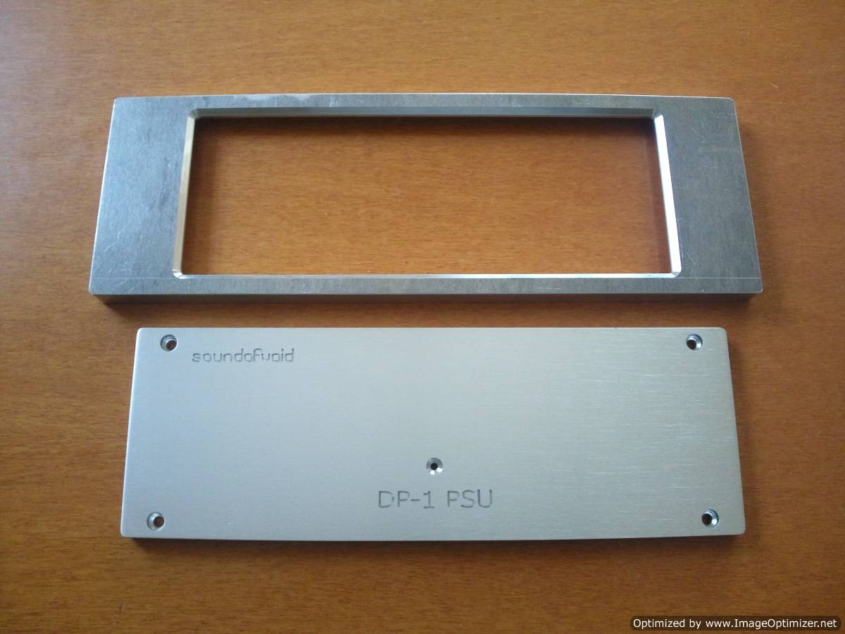

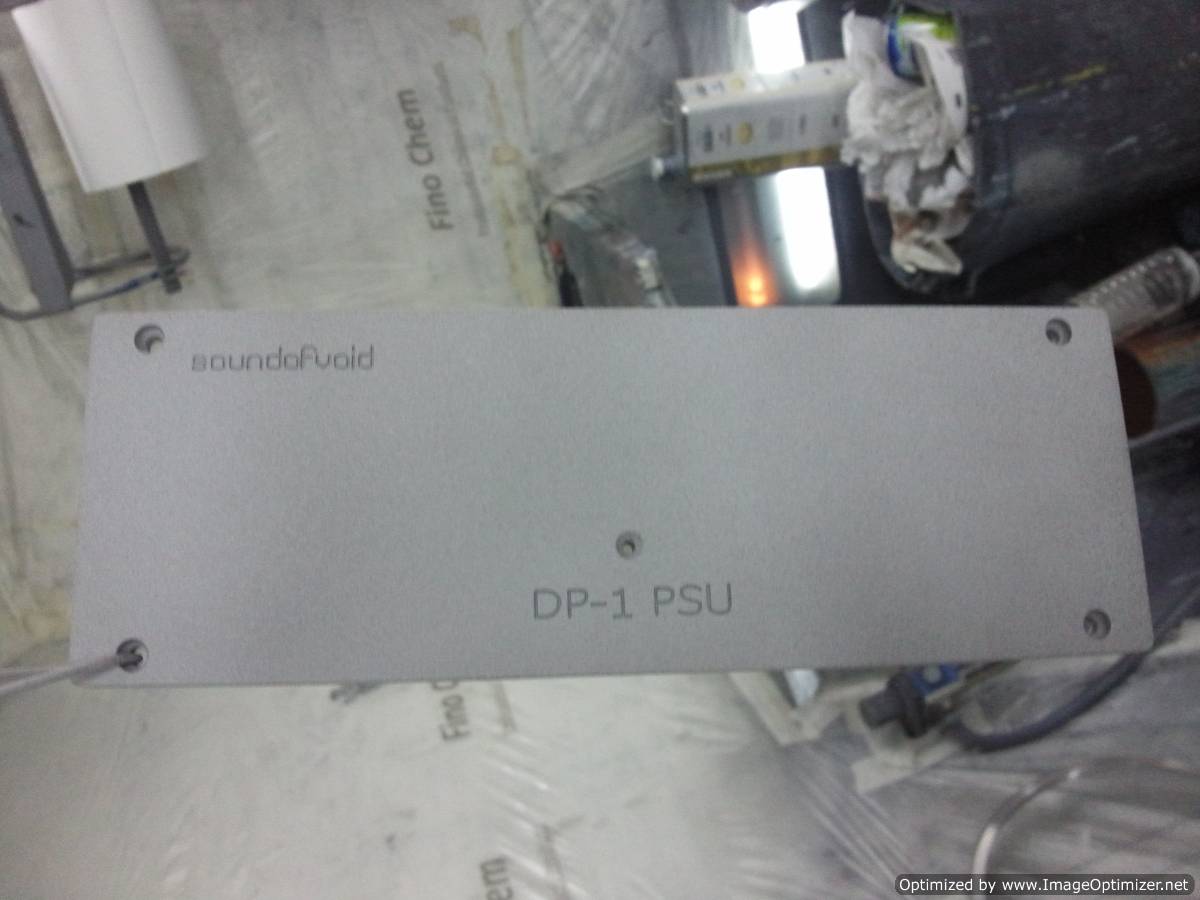

My new effort on making the ultimate DP-80

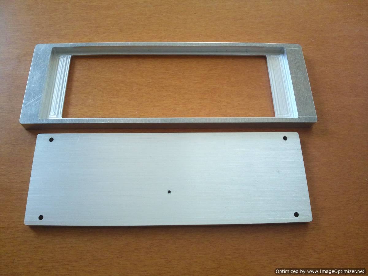

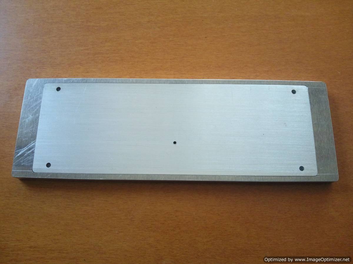

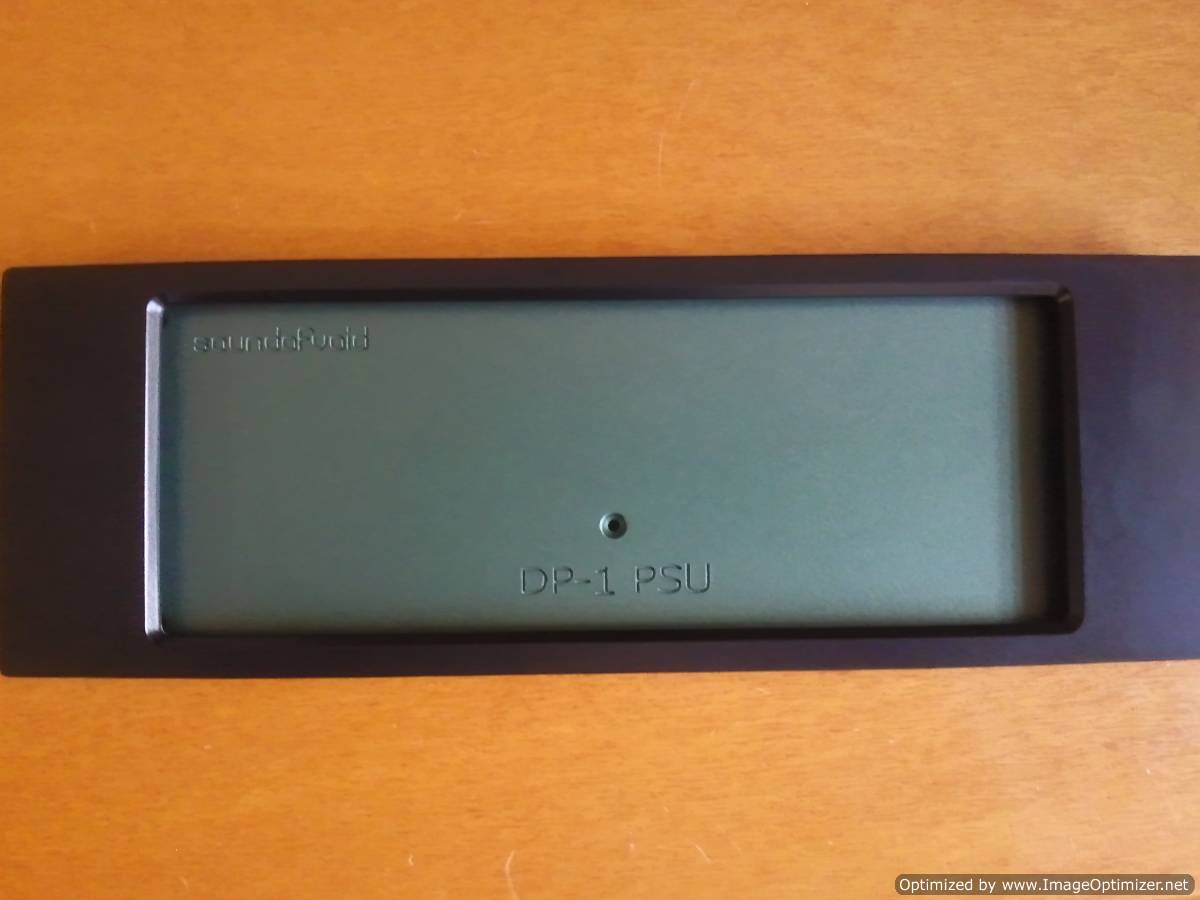

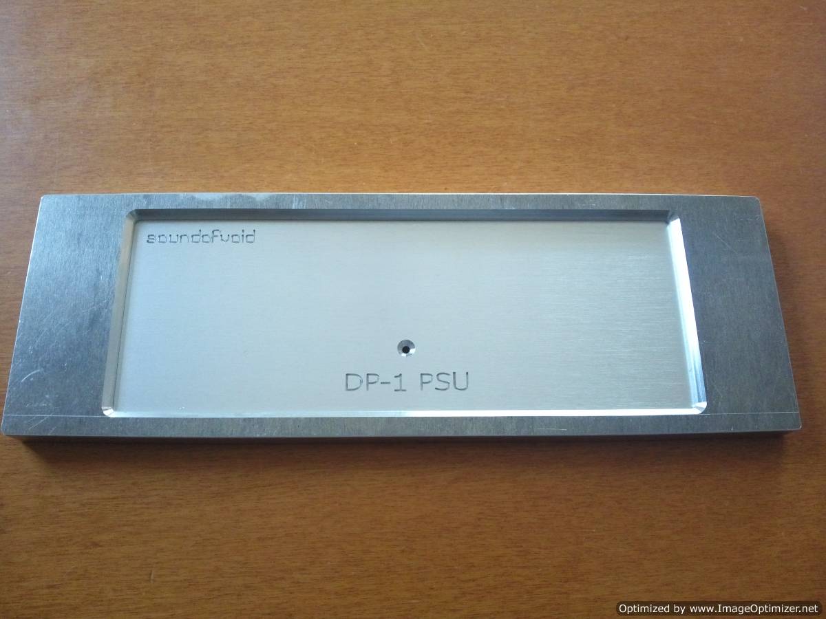

Time for the last parts being machined.
A "frame" was made from aluminium for the faceplate of the power supply unit.
Cut from a 12mm thick plate it made possible to conceal the fascia screws of the PS/control box.
And was cut a bit wider (30X10 cm) because i like that style...
It will follow the same bi-color theme that the turntable is going to have.
I'm thinking something like grey and black...

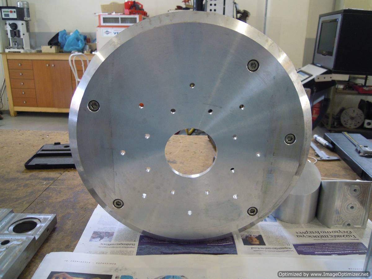

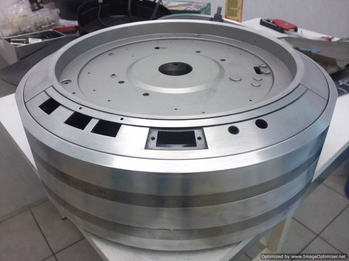

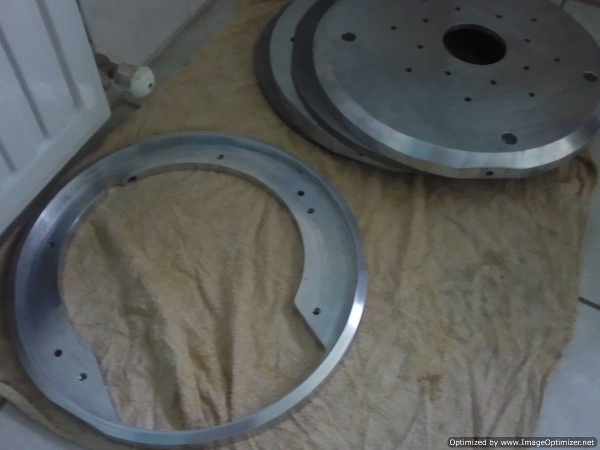

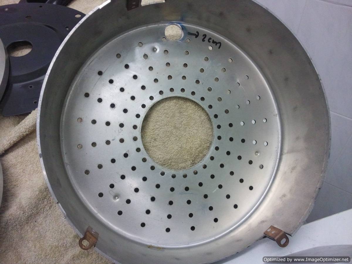

Looks like you will have a considerable air pocket right under the platter when done.
You might want to fill this with closed cell foam of some sort.
Bass frequencys could excite this area and find its way thru the platter since it looks like
you have a rather tight close fit around the platter making a resonant chamber for low frequency excitation.
Awesome work either way and look forward to how it sounds after your done.
Regards
David
That's a good point David!

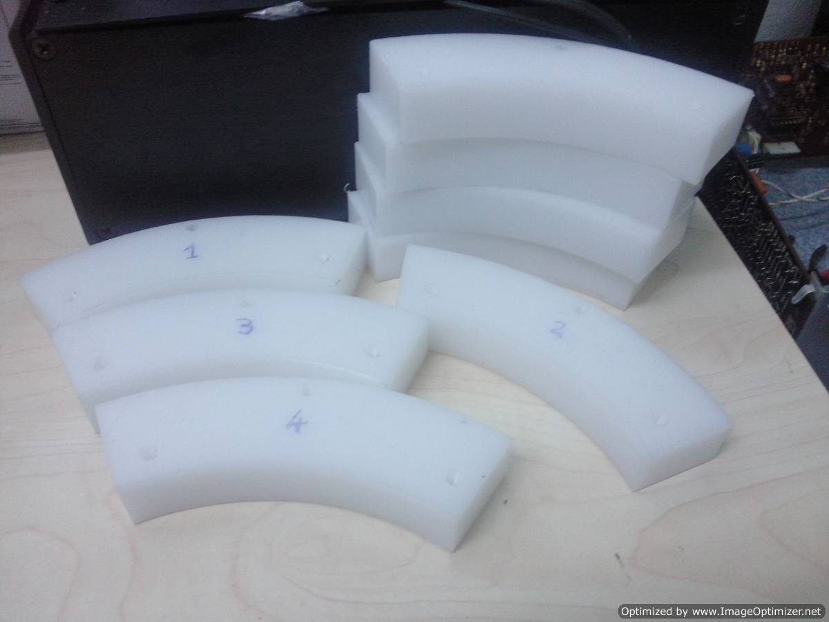

I knew i was going to have this, since i take out of the turntable chassis all the boards regarding power supply, electronic speed control and the transformer.
However i am keeping the underside aluminium "bowl" that protected all these parts for the reason you just described.
It separates the space under the platter into two and helps me with use of specific sound absorbing materials to "tight fit" the turntable into the massive exoskeleton.
In the place of the lost boards and transformer i will use "barriers" out of teflon and leaded iron in the form of four arcs surrounding the motor to help me damp the resonances in this chamber even more.
The screwing points for these have been created and will help me pack sound absorbing material BETWEEN them and the "bowl" leaving clear space just for the motor.
Plus the area around the motor is vented through a lot of small holes that will help me control this phenomenon.

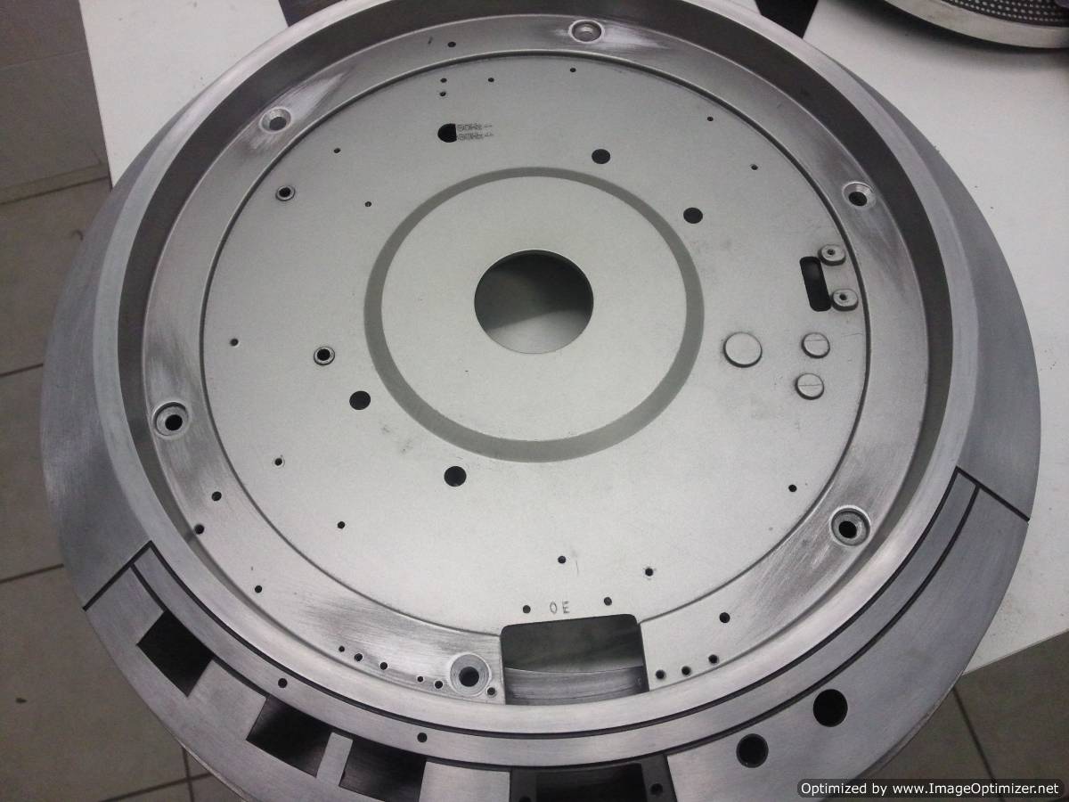

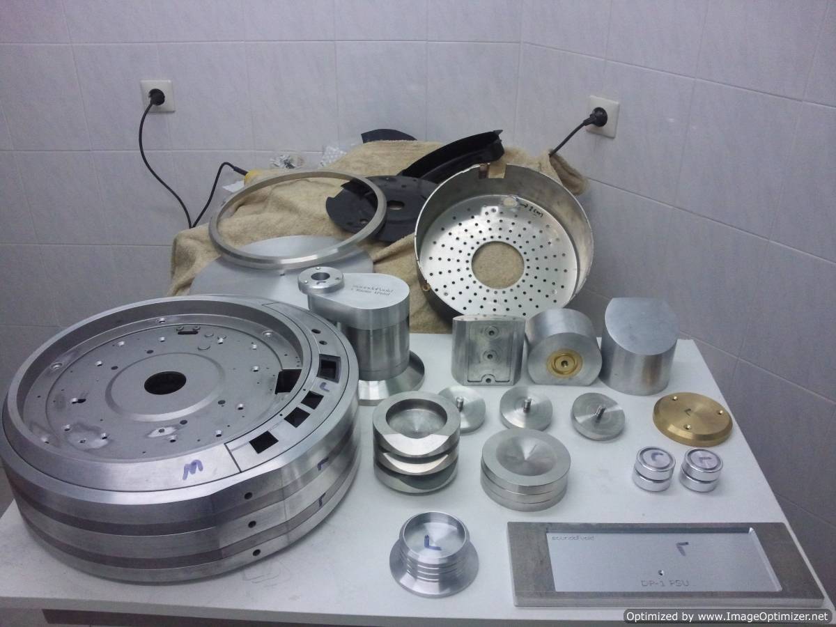

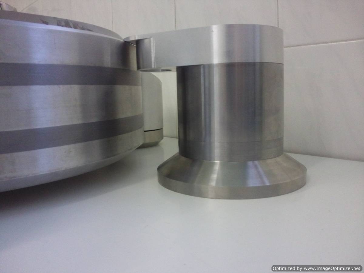

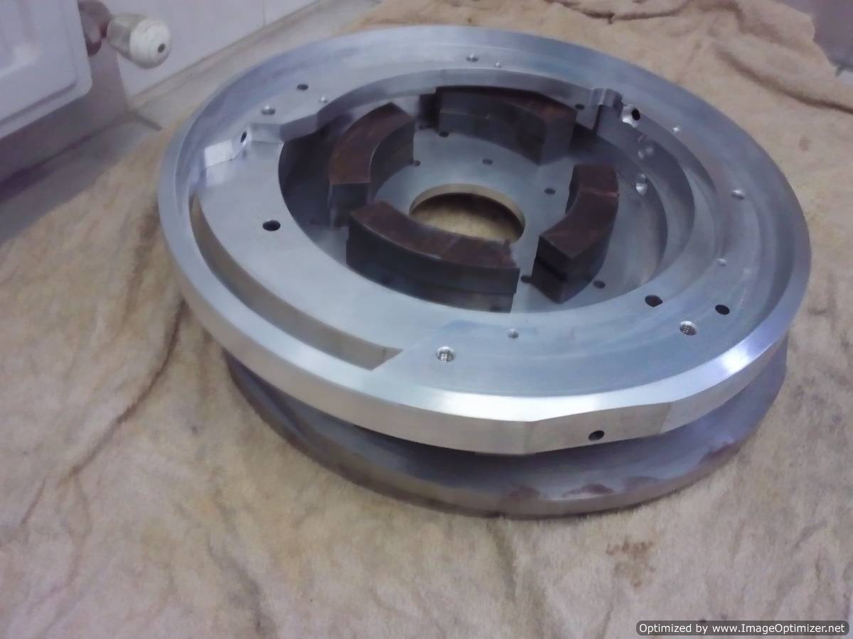

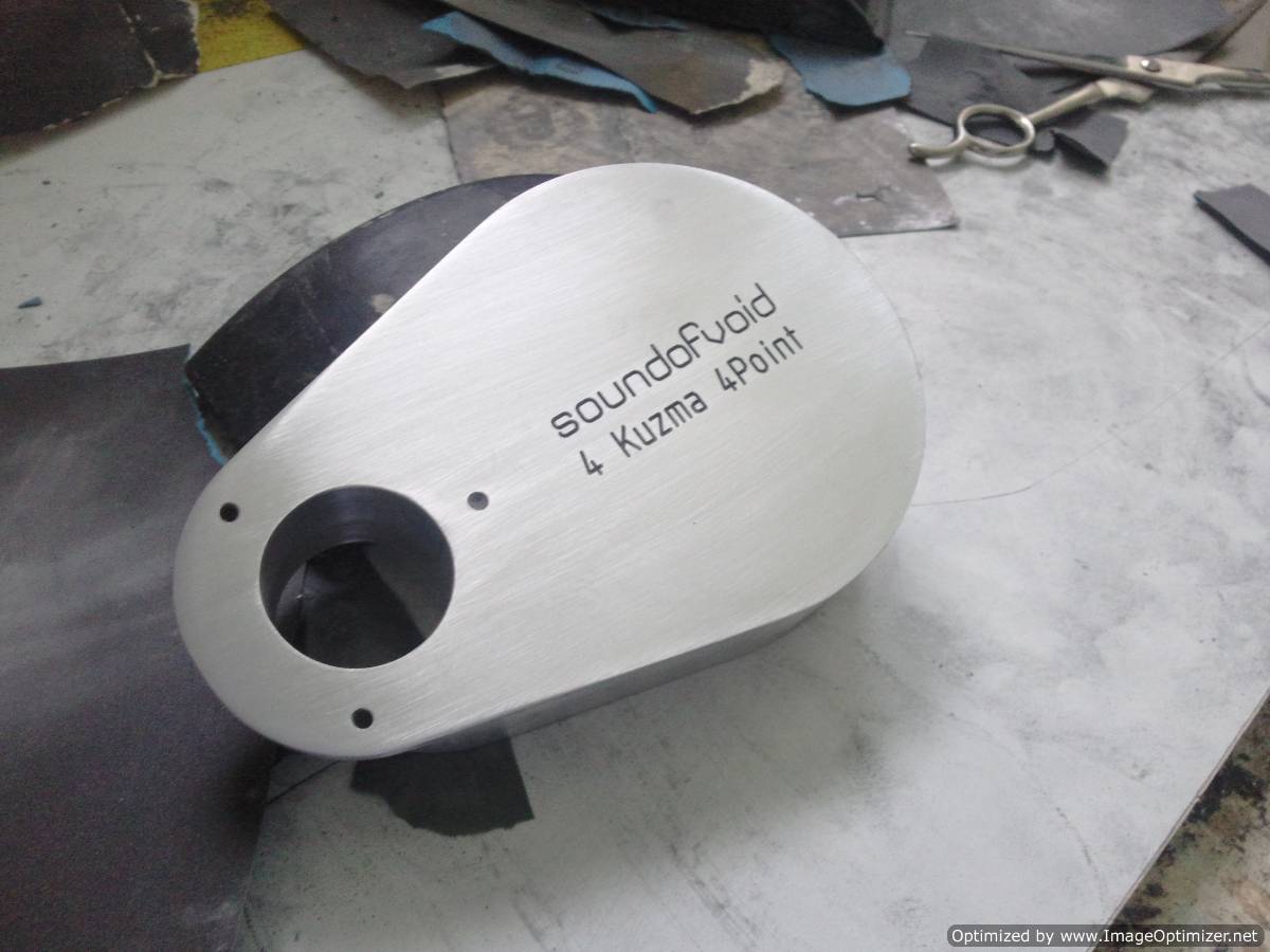

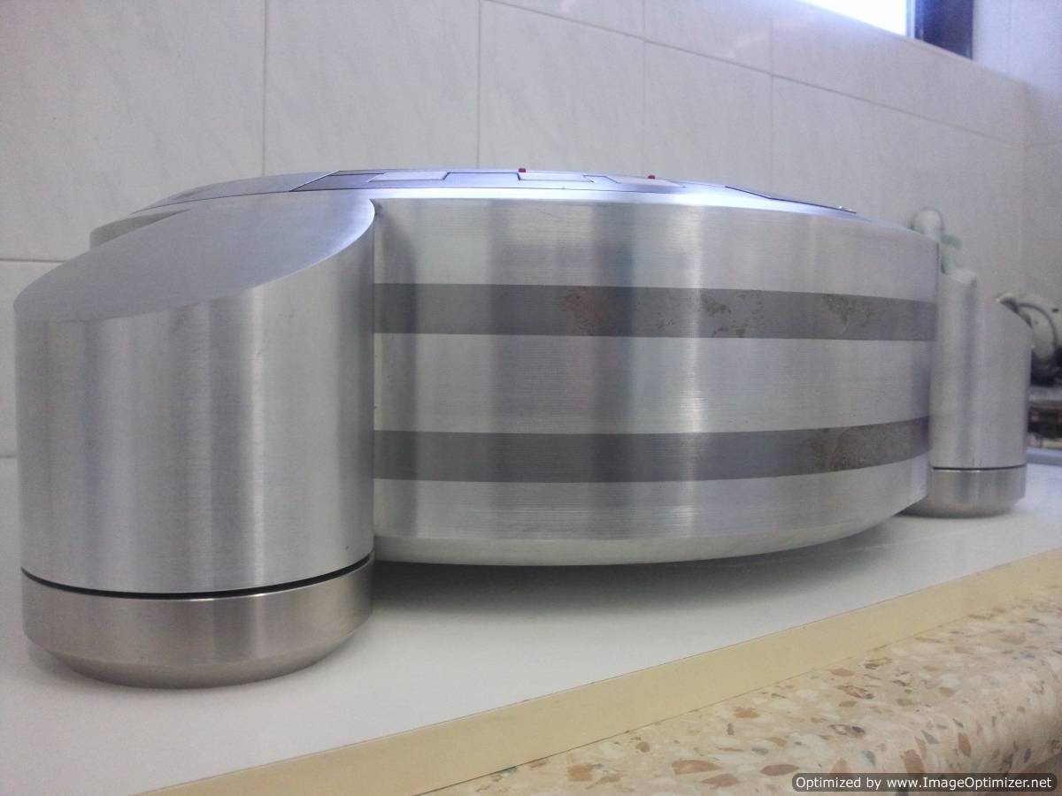

A last fitting session was done prior to sending the parts out for automotive paint.
I had to check the distance and height of the tonearm tower to the DP chassis
so that it was within specs of the Kuzma 4 Point arm.
All measured well.
Also the original cast chassis of the DP was sanded down to bare metal and i had to be sure that there was a good 1.5mm gap between CNC cut pieces and original chassis as paint does add thickness!
I have learn this the hard way when painting my Mitsubishi and paint ate away
the 1mm gap between moving parts and i had to re-machine a bronze plate to
save the day...

The whole thing was disassembled and a final inspection of the parts was made.
A little more spit 'n polish and the parts where moved to my friends paint shop.
It took ages to get to this point...
I've have started working on this project since last August.
It's very hard to design so many pieces that fit or interact with each other.
There have been many ups and downs, recalculations, pieces recut, afterthoughts added to the original design etc etc.
Let's hope that the final finish will justify my efforts!

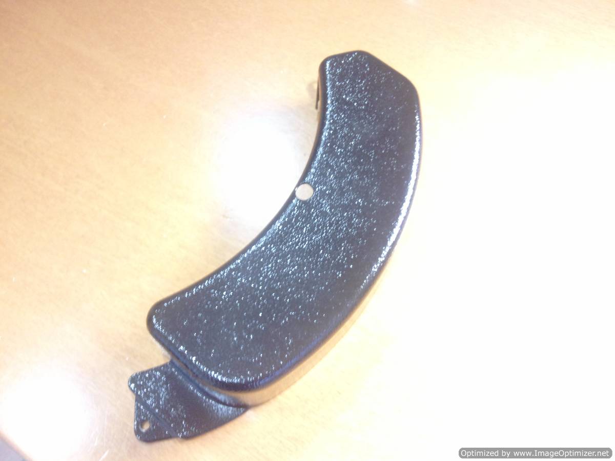

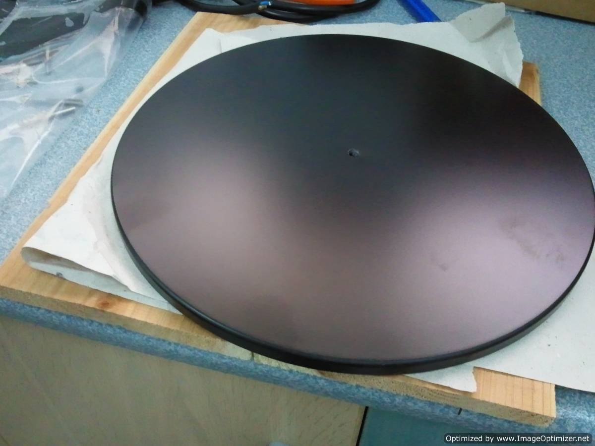

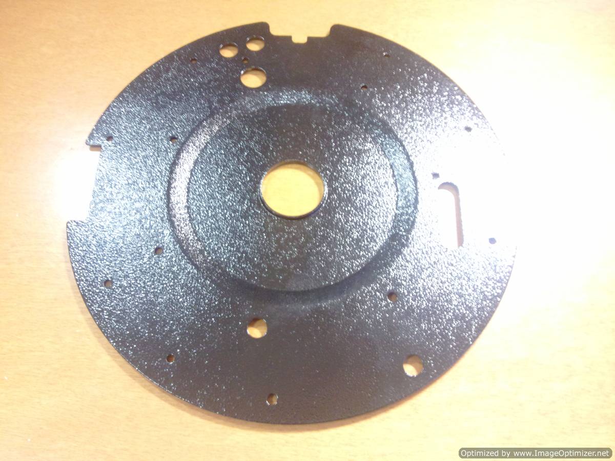

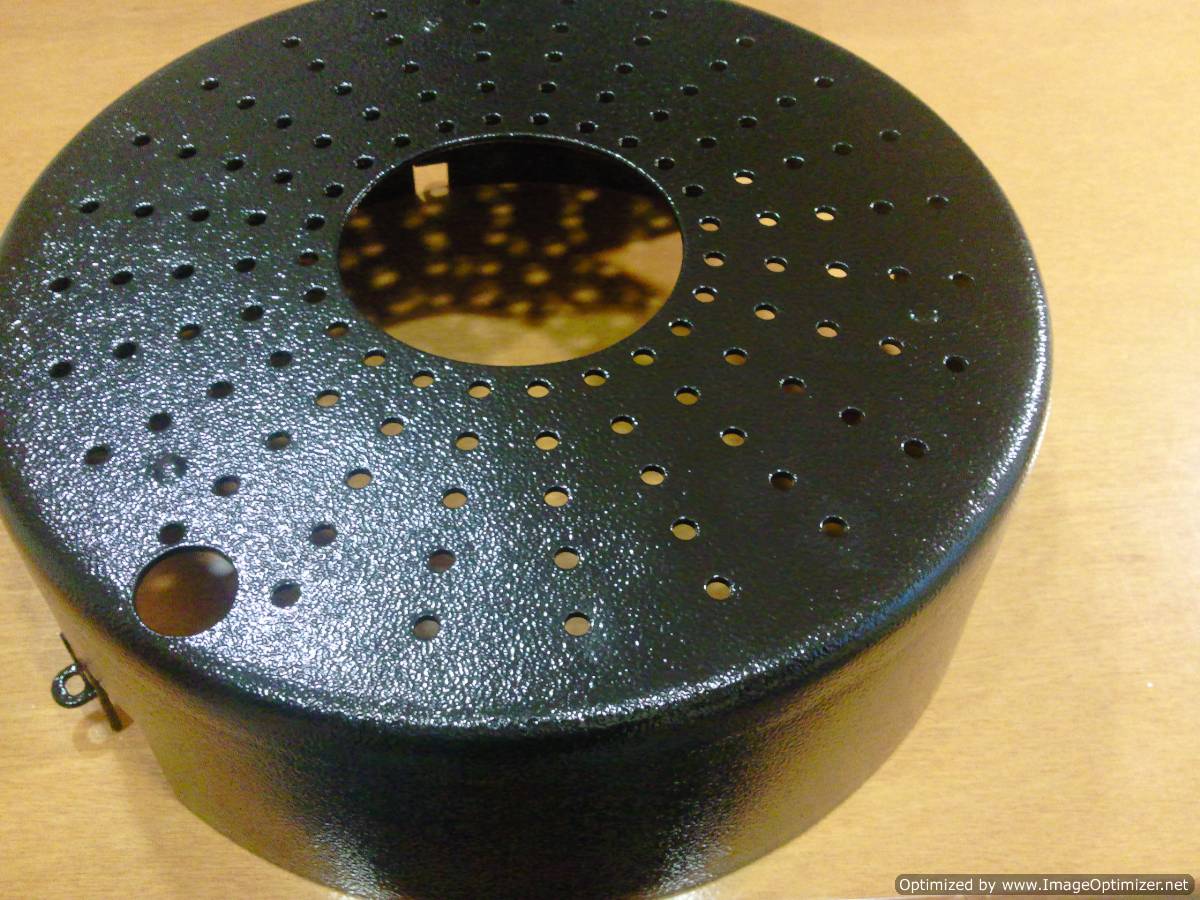

Some three of all these parts have been sent to an electrostatic paint facility.
They are the parts under the original chassis that used to protect the electronics and the metal shield that is used used to prevent the motor magnetism from reaching the platter.
I 've just received these parts today.
I asked for a thick "relief" type of paint in an effort to dampen things down as much as possible.
They showed me a Nextel-like type of paint and went for it...
I am very happy with the outcome!
I'm not sure the pics do them justice...but they do look like new from factory!

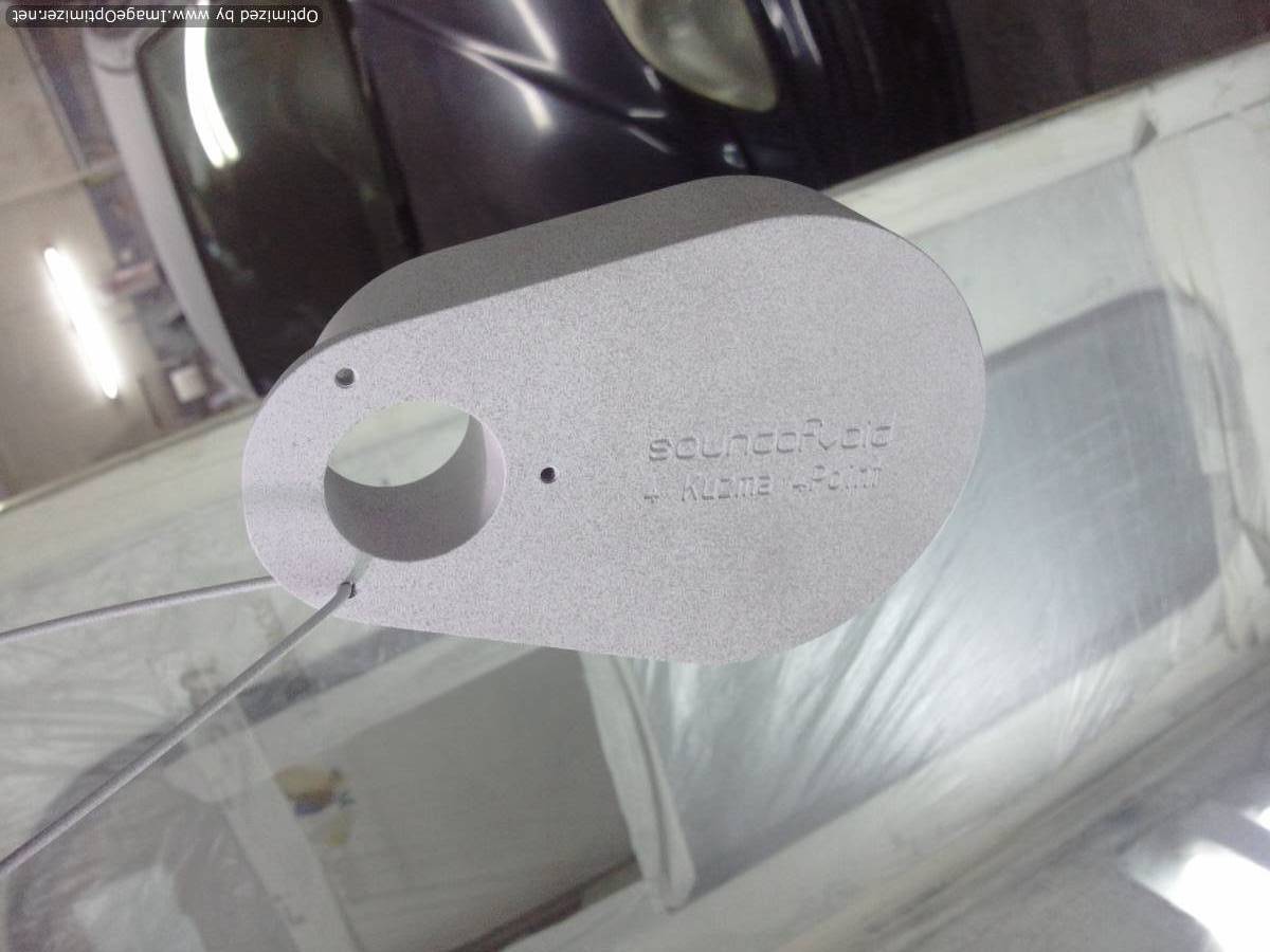

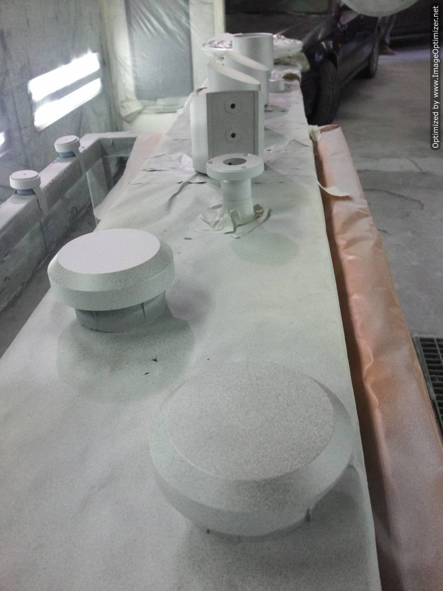

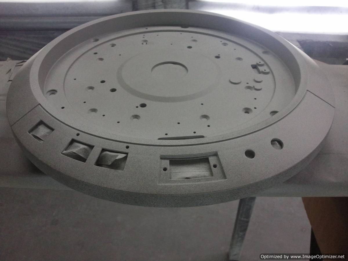

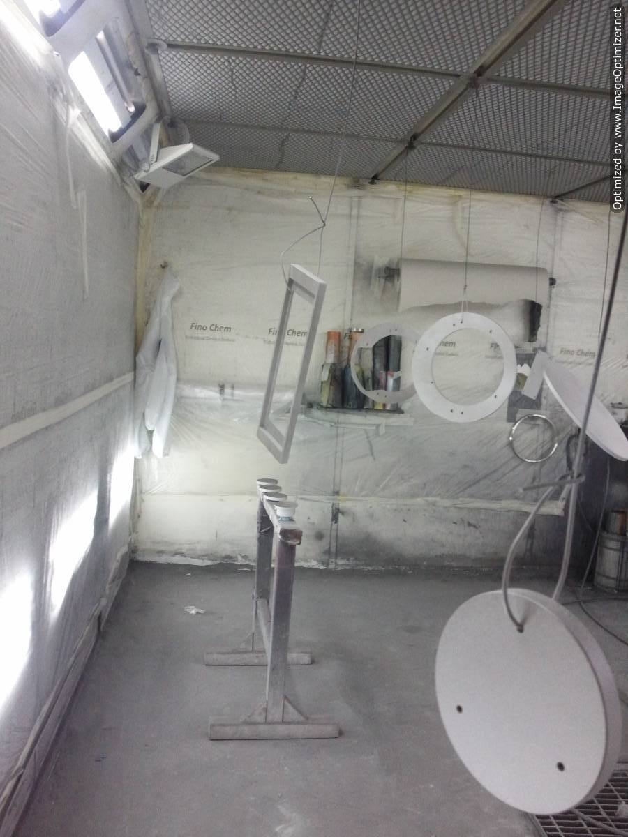

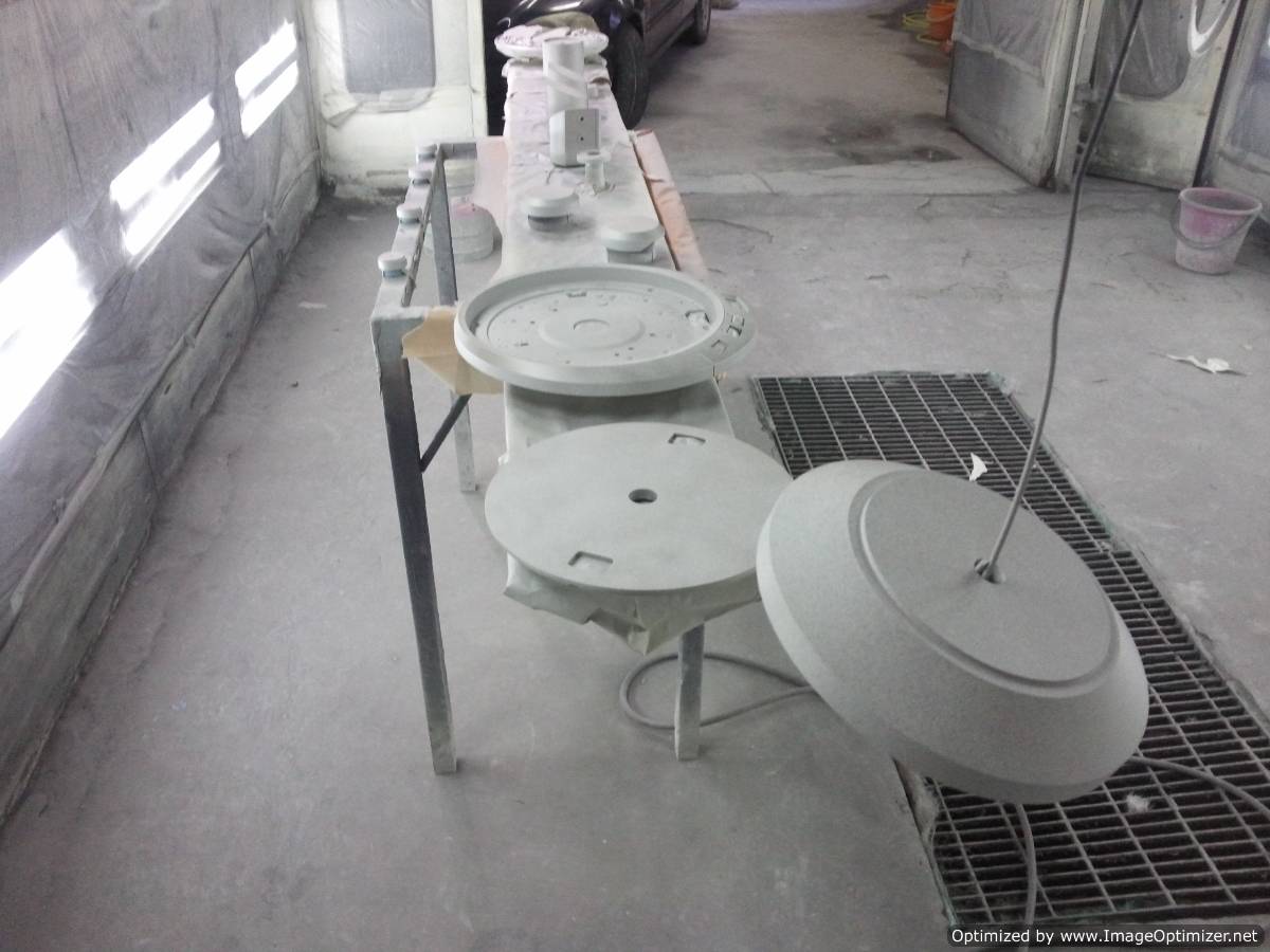

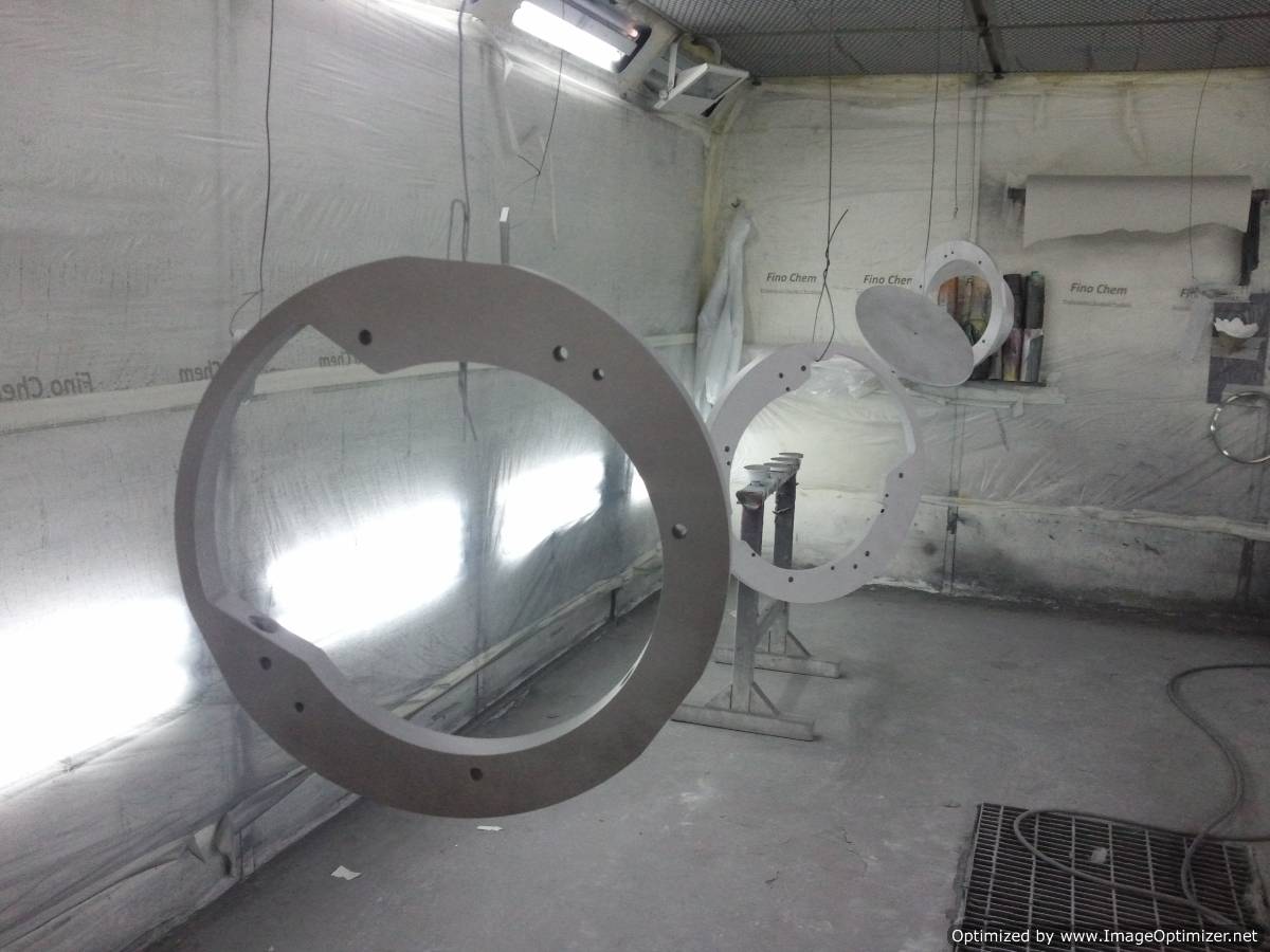

We've had some problems with the adhesion of primer onto polished aluminum.
After some research we've ordered a Sikkens product used as a primer on airplane aluminium panels.
It arrived on Friday and today i've been to the paint shop to see how things are going.
Here are some pics of what was hangin'...
And some more from other stuff, not hanging!
Now it's going to be sanded down to perfection and painted.
I've already chosen the colors...A BMW metallic black (BMW 181) and a Nissan metallic greenish grey (D 14)...to pay homage to the original olive/dark grey
color used in the original.
And then it's going to be finished in semi-gloss to make it a bit immune to finger oil smear...

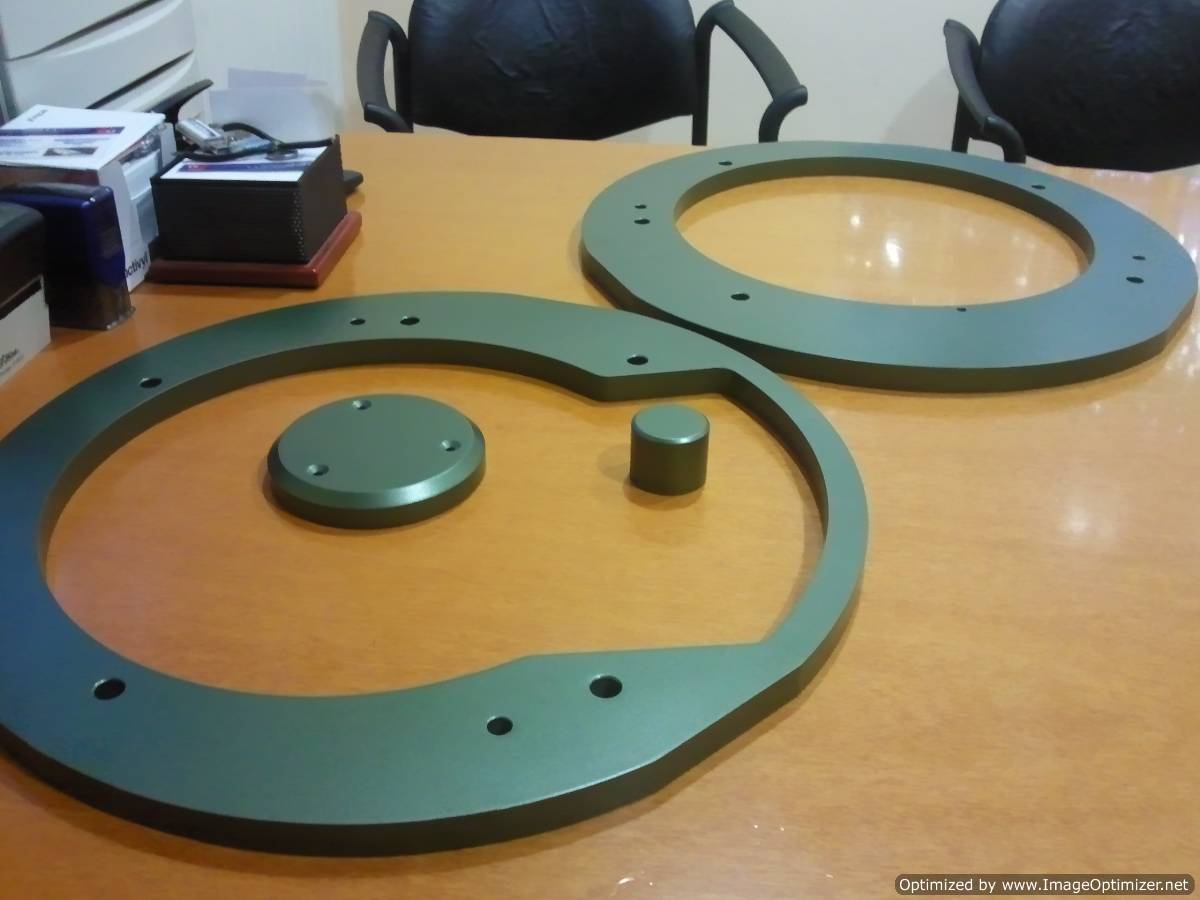

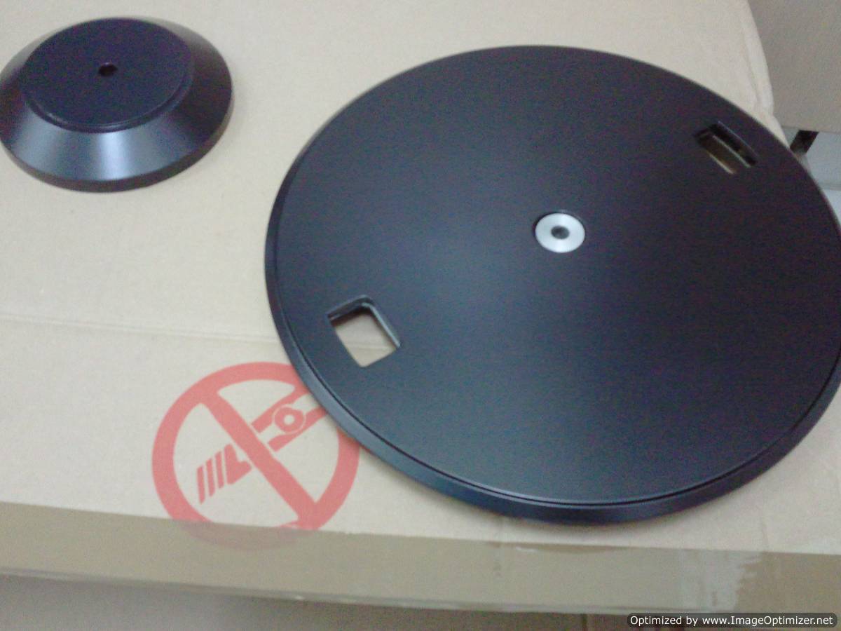

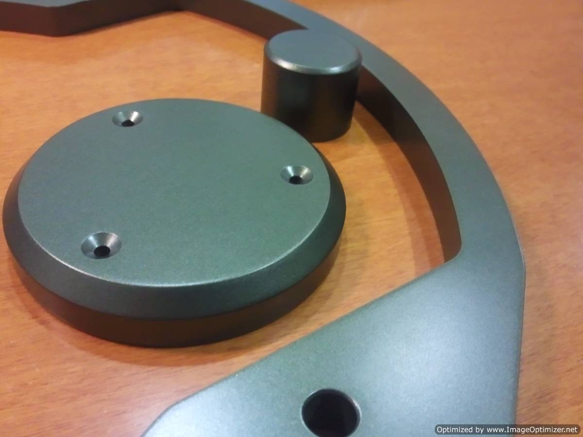

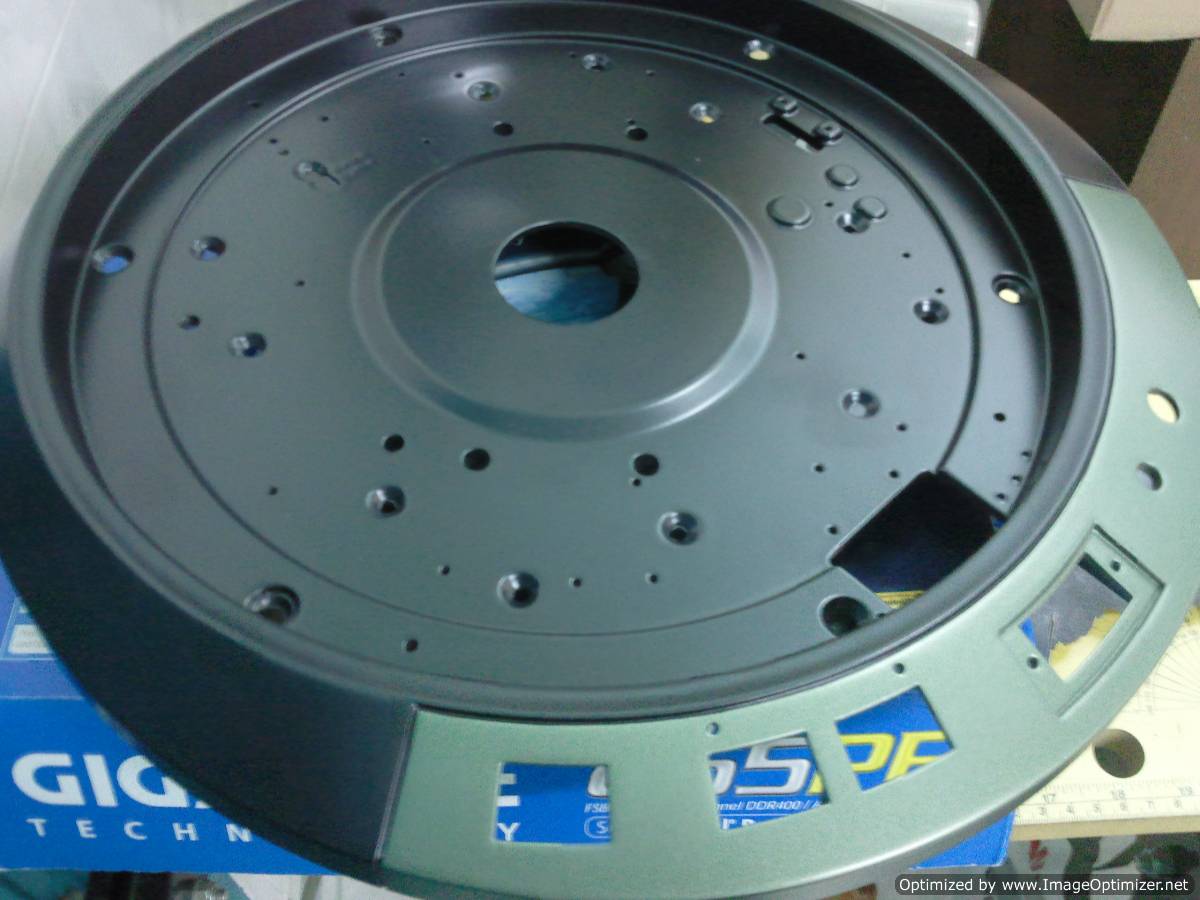

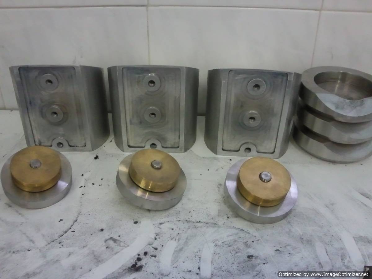

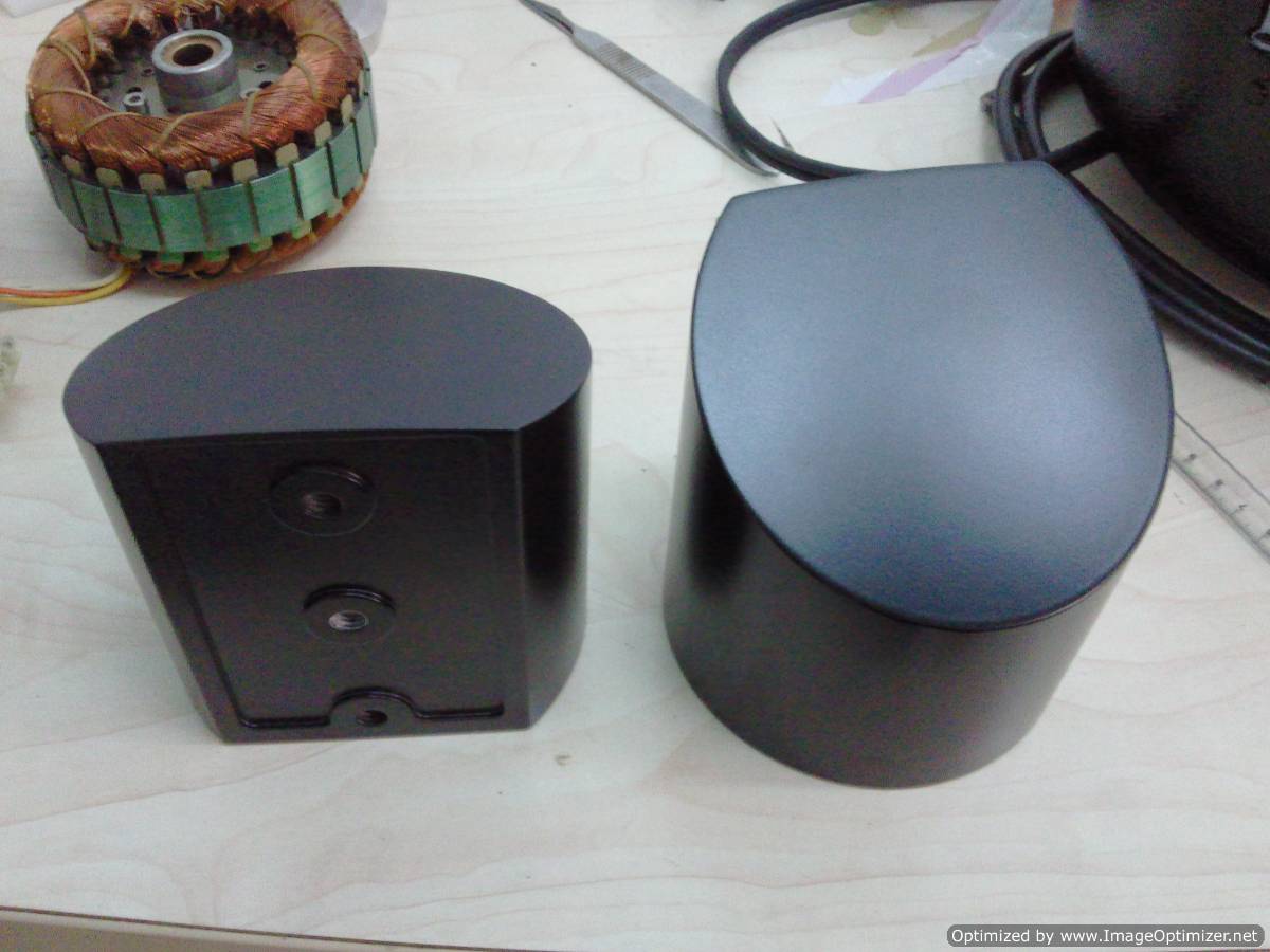

Just picked up the first parts from the paint shop today.
All in the metallic green i chose:two layers of leaded iron from the chassis, one of two bronze ballast weights under the thrust plate and the bottom cover for the Kuzma's 4P axle.
All look excellent and i am particularly happy with the satin like finish...
I took some pics that i hope do them justice.
In the last one you can see my custom ordered N45 neo magnets for my effort to maglev an even more massive version of the platter...around 13 Kgs!
Something very difficult because of the proximity of the motor but i will give it a try...

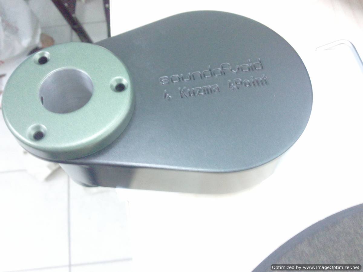

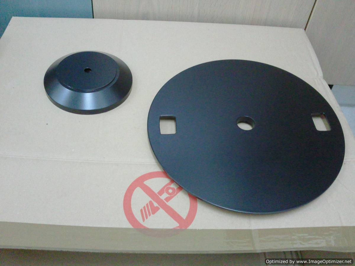

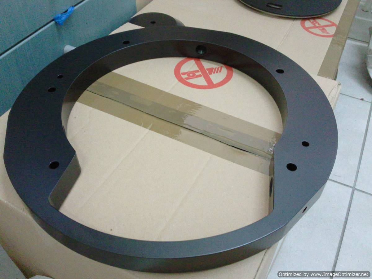

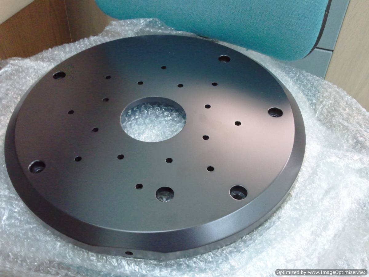

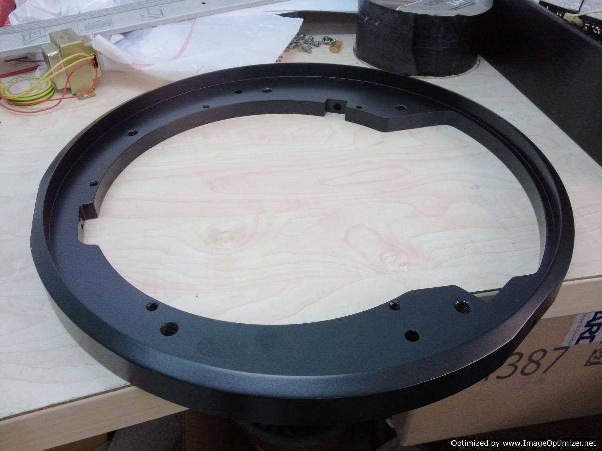

...and yesterday afternoon i was called to pick up some more painted parts.
Painted in the BMW 180 "diamant swartz" metallic black.
They look great...i'm not sure it shows but it has a small metallic flake in it.
Now i'm expecting the final batch of painted pieces and i'm done with painting.
I have to wait for a week before assembling them together as the paint has to "breathe" and the varnish has to harden up a bit...

I've got the last painted parts...
It's in all in my hands now...besides the lettering on the button area...any ideas there?
It will be a long week waiting for the varnish to settle...
