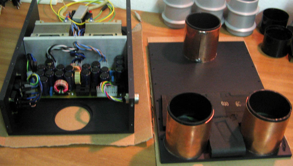

Just another picture of the big psu black box:

materials
My choices about materials and components:
DARK THICK ACRILIC - heavy and damped plastic, veeery beautifull!
THICK ALLUMINUM - heavy and robust, brushed and anodyzed (black and silver)
MAGNETS used in the suspension - from little stock speakers (mostly used in pc chinese speakers)
COPPER FOIL - to build shields underneath the main board, above its digital section and around the display board
FEET DAMPING - sand, various types of rubber and a soft ball (those used on the beach to play a sort of tennis)
EI TRANSFORMERS with added copper shield (have better isolation than toriodals, magnetic fields are not a problem in a separate box)
PANASONIC FC caps in the first stage of supply, SANYO OSCONs, VISHAY MKP and X7R SMD MULTILAYER caps in other supply stages and for decoupling, X7R SMD MULTILAYER caps for DC blocking on digital signals
LOW NOISE METAL FILM 1% toll - 15ppm/degree C resistors in critical positions (super-regulators - signal path), the others are 1% 100ppm
LM317-337 for the first regulation
SUPER-REGULATORS FOR: 5V supply of CDPRO, 5V supply of reclocking section, 5V supply of XO - They use a MAX6225 low noise voltage reference for both two NE5534A and a AD797 opamps which drive shunt regulation bipolar transistors
A HCT series D-type FLIP-FLOP reclocks the spdif signal (VHC type doesn't work because SAA7324 output a 3.3V ebu signal, so a ttl input is imperative)
A DS26LS31 RS422 driver feeds the Balanced digital output through a SS22133 low-capacitance shielded digital transformer
A 74HCU74 feeds the unbal 75OHM-BNC and RCA outputs through two SS22133 transformers
The clock generator is a low-jitter TENTLABS XO 8.4672 MHz damped with a 4 silicone o-rings suspension
The main pcb is double side with top layer used as ground plane
The lid is moved by a BELT (from an old printer), the relative gears and a little MOTOR (from a old cd-rom drive) – operations are directed by a MICROCHIP PIC 16F84A (reliable and easy to use) which drives a H-BRIDGE for the motor and some leds
CDPRO is TWEAKED: army greeen mat enamel on the pick-up body and on the side of the lens (very dangerous!!), blue-tac on smd electrolitic capacitors, damping material on the metal parts, both onboard oscillator and spdif output attenuator removed and connected to dedicated circuits with short twisted cables
Anything else?

Hello Roberto
Question: How did you manage that the unit does'nt roll off the magnets and keeps itself stable?

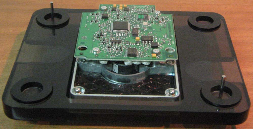

cdpro suspension
Tubee 😉
The support is free to move only vertically, two iron axles in the center of two opposite magnets slide into teflon bushes (or bucklets 🙄 )
Low frequency vibrations (the worse ones) are not transmitted by the axles thanks to teflon!

Here's a picture of CDPRO on the support (before circuit mods):
Tubee 😉

Thanks Roberto, i thougt allready there must be a fixing pin or something.

You're right!!😀
They use neodimum magnets, very effective but hard to find! However the cd gear is light, so small ferrite magnets are enough!
..I think teflon is better than ball bearings as far as it concerns the range of vibrations we've to fight!
