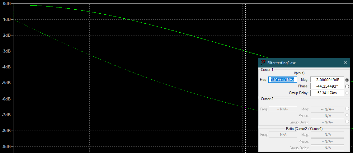

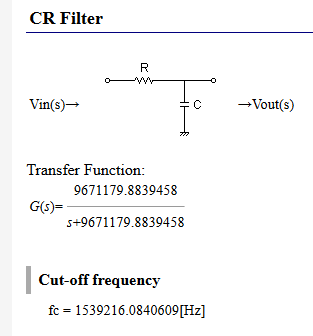

avtech Member Joined 2017 2024-11-20 10:45 pm #21 2024-11-20 10:45 pm #21 That one is set at around 1.5MHz which isn't going to keep the RF out:
