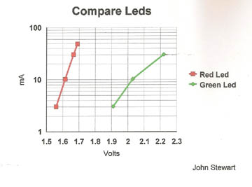

The way I understand it is in order to get the benefit of LED bias, with the lowest possible dynamic resistance, you want to select the "cheap red" LED. Going to special types like low current or exotic colors tends to increase the resistance. It's a tradeoff; I'm sure it would work, but would it work as well?

Zigzag: Looking at the graph of voltage vs. current for these low current diodes it looks to be even more straight up and down than the cheap red ones I can find to look at.
Not that these low current ones are off the charts expensive ~ $.50 each.

All common LEDs exhibit Curvature on the EI plot.
Attached are a couple of HP production from about 35 yrs ago.
As an aside, first LED I ever heard of was around 1960.
Experimental sample, $60 US while I worked on core memory research at U of T Physics. At HP we had Military grade red LEDs for about $10 by 1968.
The price came down very quick. By 1968, 7 or 8 cents in quans of a million.
