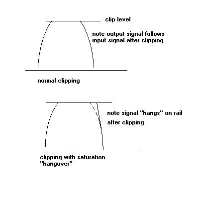

another problem with tweeters and clipped amps, are bad clipping behavior. in many amp designs the outputs and/or the drivers go into saturation, and the transistor can hang on the rail, even after the amp should be off of the rail. see the pic below for an illustration. this type of clipping behavior is very bad for tweeters, especially if the slew rate at the end of the "hangover" is very high, as this generates large amounts of high order harmonics.
with NAD soft clipping, this should never happen, since the soft clipping circuit is supposed to clip the input signal at a level slightly lower than the clipping level of the output stage. the amp never gets enough signal to actually clip the amp if the soft clip circuit is adjusted properly. the soft clip circuit is supposed to act as an input limiter
even soft clipping will modify the shape of the music envelope and pull down the peaks.
This has a similar effect in that it generates a higher proportion of harmonics in the output signal.
I guess the predominance is 2nd and 4th rather than the very high and many odd order harmonics.
The NAD will still send extra HF energy to the speaker if it is clipped whether soft or hard clipping.
The same advice as always:- avoid clipping (unless you're earning a living at reproducing bad music for a disco).
