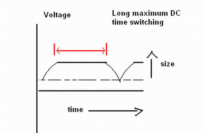

My imagination is telling me that your output waveform may be extremelly distorted.
If you play Rock, for instance, heavy metal...where the audio is already hardly distorted....and including that your amplifier is producing its own distortion because overloaded.... this way you
will have enormous DC....switching DC having also the standard reference ground floating too....this signal is able to cross the tweeter passive crossover capacitor...and this is more destructing than everything.
My suggestion is to include more tweeters, using series and parallell connections to produce a more strong load for those distorted signals that can represent many times more energy going to your tweeter.
Or...to include protective resistors in series with the tweeter, accepting the loss of treble level.
To reduce the amplifier's power..... using the volume knob till you have no "soft clipping"...may be helpfull too.
If you are NOT using Heavy metal, distorted tones, or overdriven amplifier system...well.... under that sittuation i have any idea related what is going on....only the same ideas our friends already published in this thread...anything more than that.
I have friends that do not perceive clipping...and they are not idiots...they just apreciate that distortion...the same distortion is beeing used..long time ago, by guitar players....they say that sound turns more loud and agressive.... that's it...distortion listeners...and they are many!
To include an extra Zobel filter...soldered directly over the speaker terminals is not a bad idea too...because some oscilation ...dinamic oscilation may exist too.... standard 10 ohms and 100N (250V) will be a guarantee of oscilation supression...or... at least, will reduce its amplitude (voltage)...one to each speaker...it can be soldered over the woofer terminals....if this will turn not helpfull..... also will not be any devil to your sound system too.
