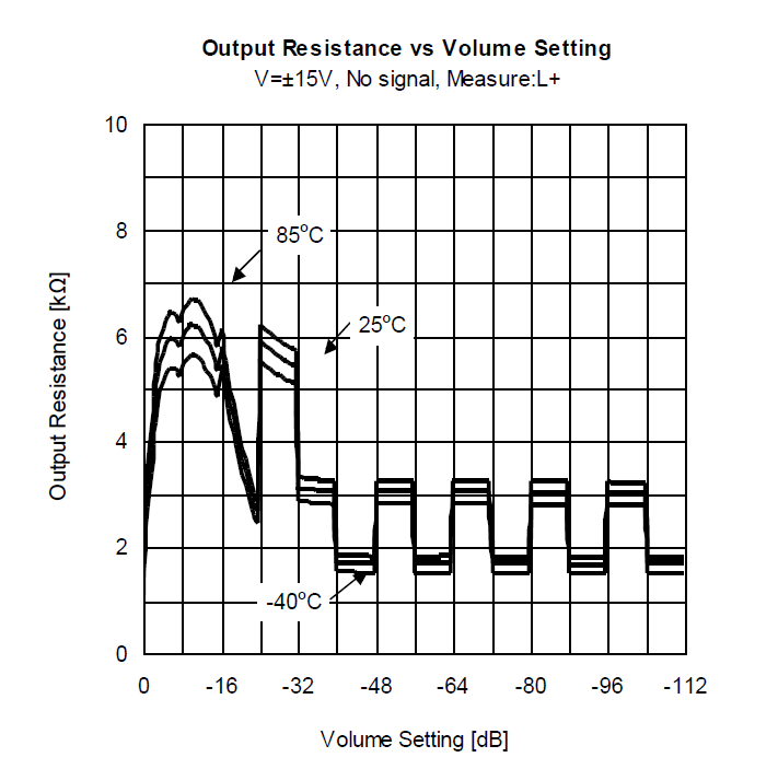

But I think that for the aleph P1.7 , it is better to put the volume controller in the output and the MUSES is not made for that.
Are you sure to put it in the input ?
Note that the MUSE need an high inpendance input for the preamp.
The output impedance of the MUSES is high.
The note in the datasheet
Rbias is the input impedance of the follower.
But you can try, there are no risk if the muses is in the input

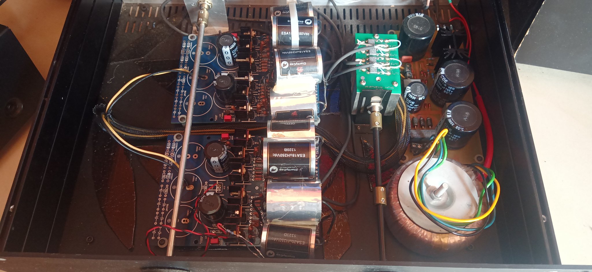

i have built an apleh P and I use an KHOZMO shunt attenuator in the output.
I'm planning to built an digital relay based output attenuator for my alehp when I have alittle time.

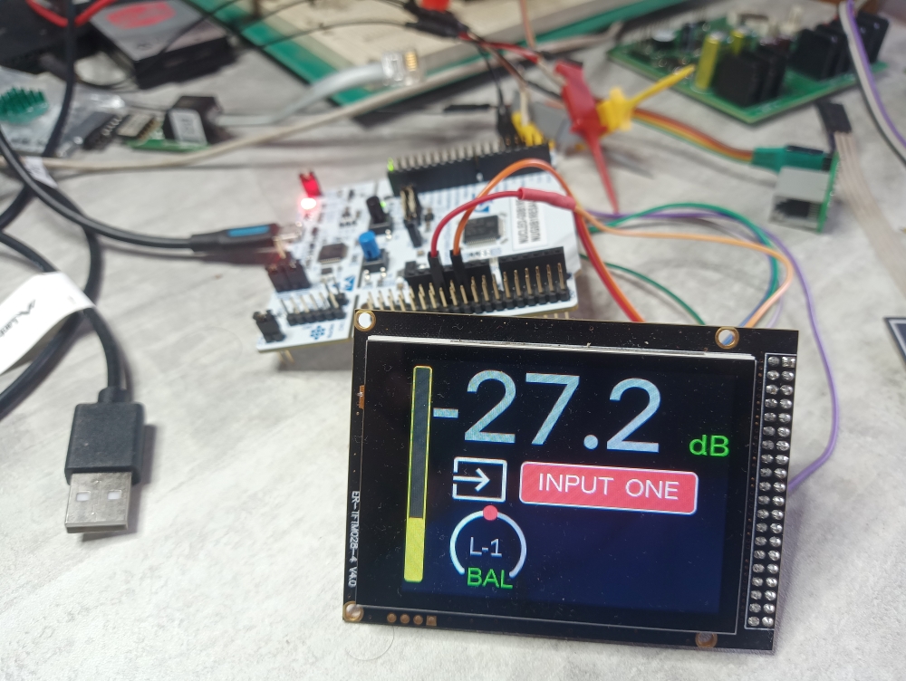

gretting from MADAGASCAR 🙂
Working on the new MUSES 72323 new volume kit.
I really like these new IPS LCD (not the TN old one with bad angle vision), their contrast is very good. I like when the back groubd is really black ( that' why I used OLED before)
I'm new in the STM32 world, it took me long time to learn the CUBE IDE STM32 dev tools.
still long to do list........
I really like to put color every where 😉
Well done. This screen already looks very good.
We are also waiting for a light, laconic version, just some numbers from 0-100%
