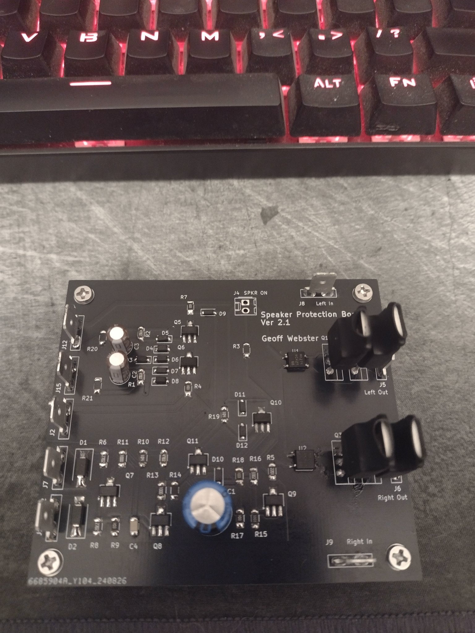

Just built two of these but messed up the diodes on one and I think I took out a FXC596 diode. Built the second one using the picture provided by Geoff.
Any advise on testing these boards? Just hook up the +-43 volts dc from the psu board and then one of the 32 volt ac secondaries. After do I just look for continuity between left in and left out? I tried doing this and I dont have any continuity between the speaker inputs and outputs.
Firstly, connect a moderate load resistor (1K say) between left output / ground and between right output / ground.
  1. Power on/off test
    Connect a tone to the left input. With no power applied to your PSU, you should see no tone at the output. Now turn on your PSU and you should see no tone at the output for a few seconds then the tone should appear. Turn off the PSU and you should see the tone immediately vanish from the output. Repeat for the right channel.
  2. Voltage offset test
    To verify correct function of the dc offset voltage shutdown, maintain the tone input and output load as for the previous test then power up the PSU. After the turn on delay, the tone will appear at the output. Now apply around 4-5Vdc to the output and verify the tone disappears almost immediately (remember there's a time constant on the voltage offset circuitry). Do this for both a +ve and a-ve dc voltage. Do this for both channels.
