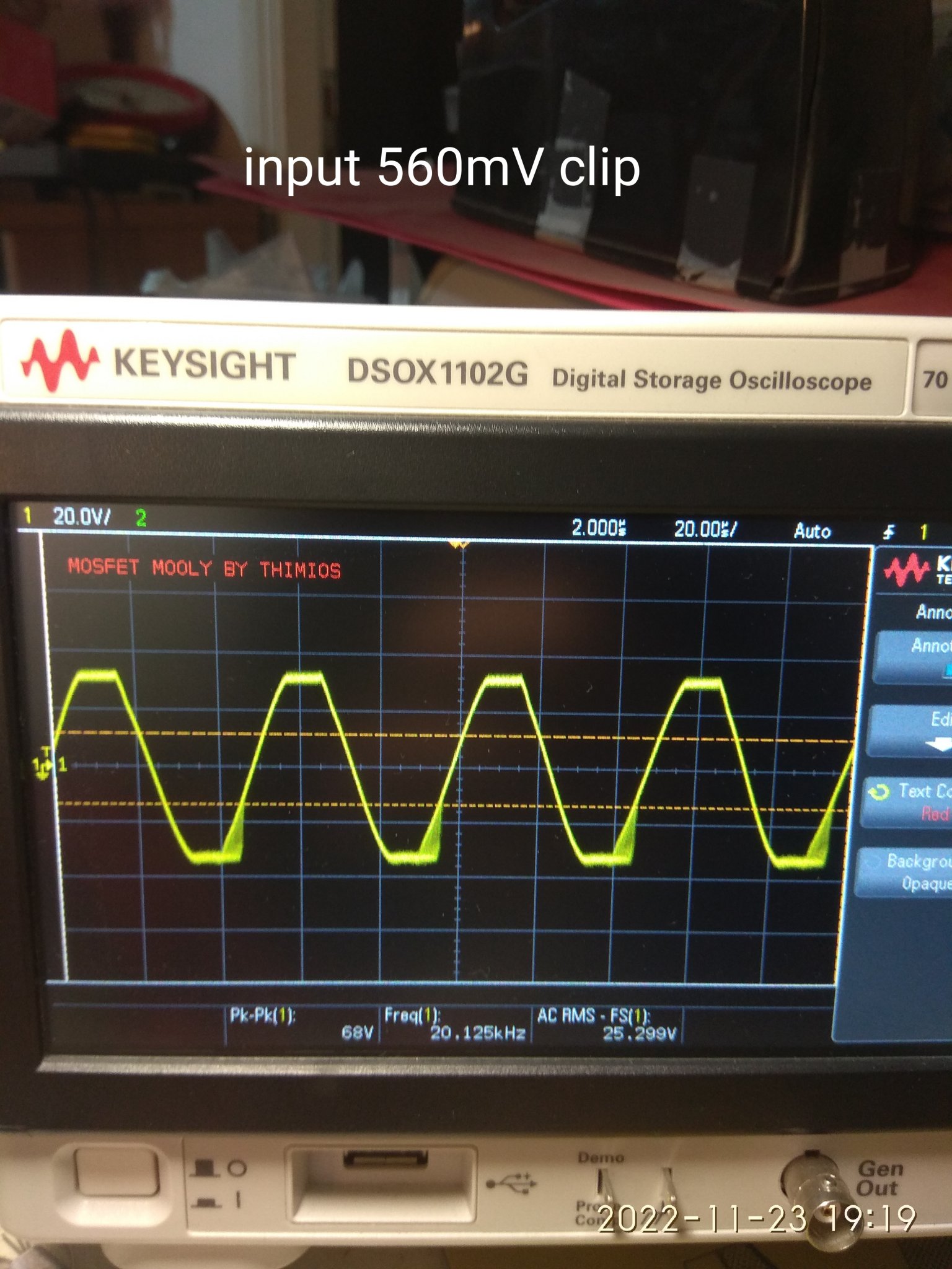

The actual trace is difficult to figure out. The scope trace should be a single 'line' and yet what you have here doesn't seem to correspond to that. The wanted signal rises cleanly andyet there is the noise showing as well. It is as if there are two traces at that point.
Have you tried altering the input frequency and scope triggering?

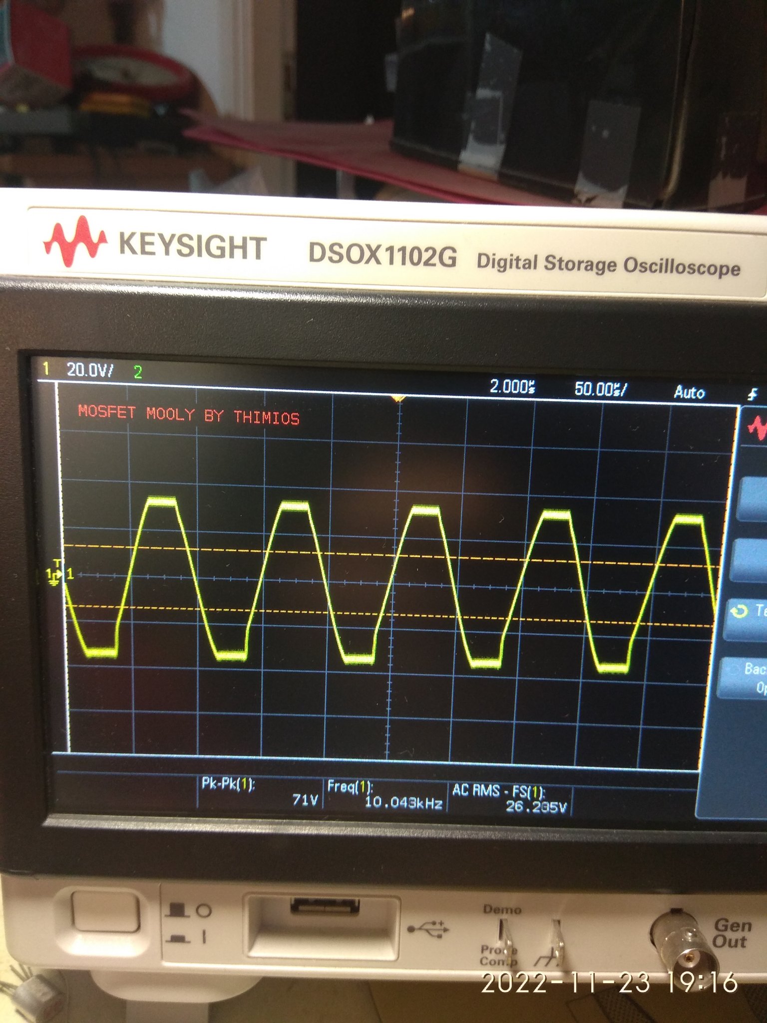

This happen at 20Khz.
At 10Khz clip is normal.
Same levels.
Hi Mooly.
Same levels.

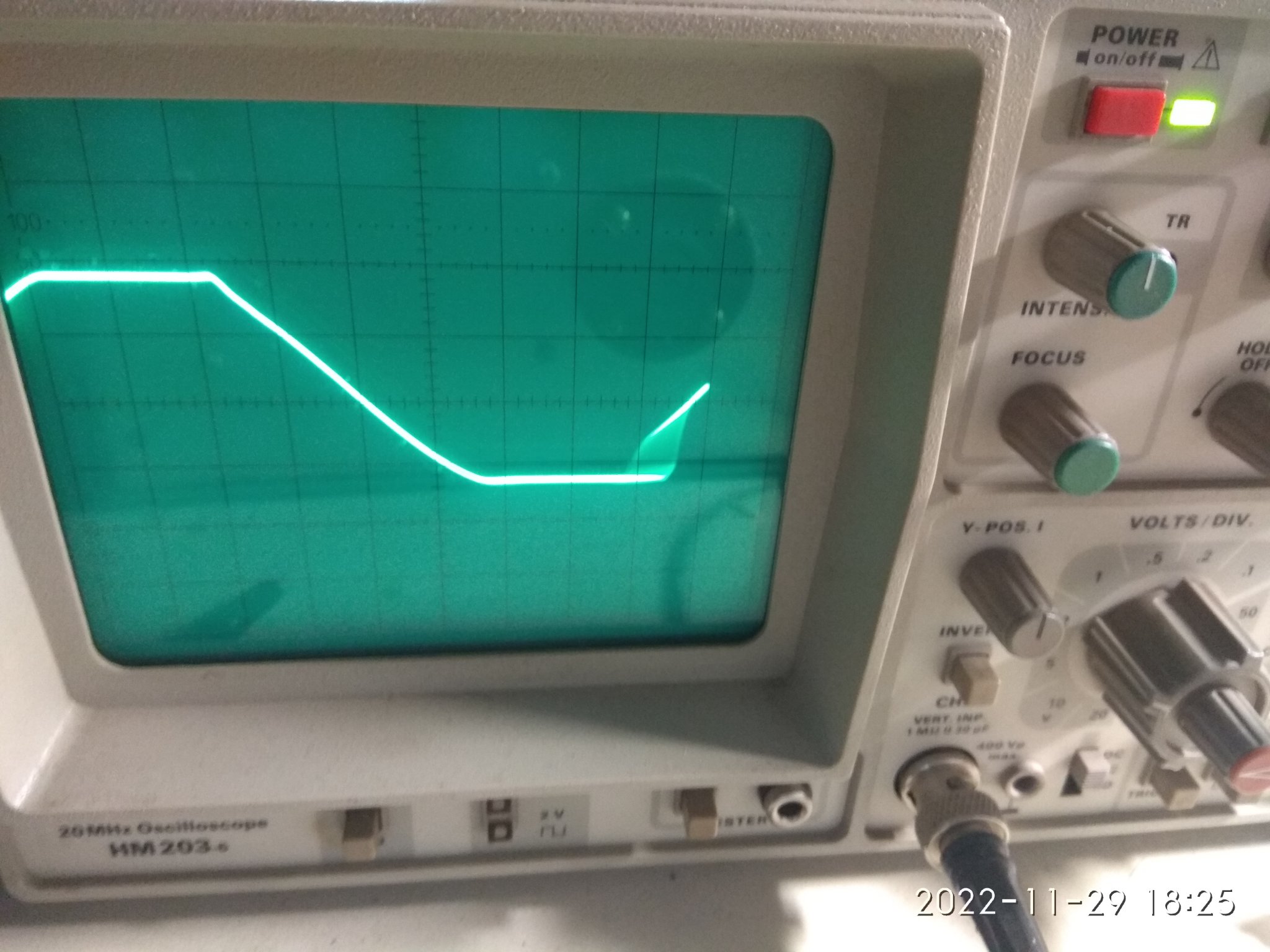

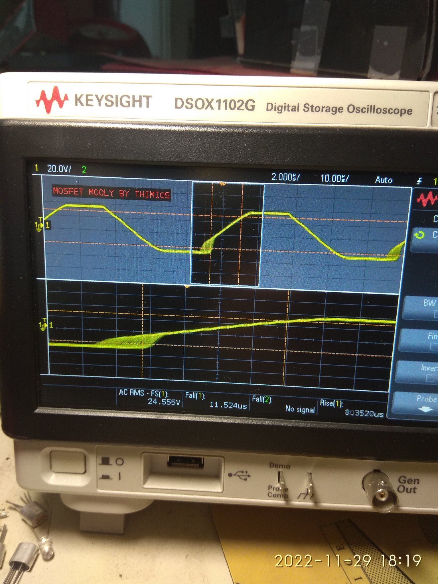

Hard to say tbh. It would be interesting to see that on an analogue scope with that part of the trace greatly expanded 😀 Whatever is there, the trace of the scope should only ever be a single line tracing out the signal. You might be chasing something that isn't real.
1)Analog scopeHard to say tbh. It would be interesting to see that on an analogue scope with that part of the trace greatly expanded 😀 Whatever is there, the trace of the scope should only ever be a single line tracing out the signal. You might be chasing something that isn't real.
2)Digital zoom
It looks like there is a high impedance condition in the biasing of the output stage. The waveform that you see is a result of the scope re-traces over many cycles of 10 Khz. The high impedance in the output stage may be modulated by noise from power supply radiation. Also, the output stage may have a local oscillation in its design that only occurs at certain bias conditions like in recovering from a clipping condition. The retrace envelope that you see is showing the boundary of the high impedance condition.1)Analog scope
2)Digital zoom
1)Analog scope
2)Digital zoom

No it doesn't happen in soft clipping conditions but in hard overdrive, about 560mV input signal.
Hi Mooly 5401&5551 that is used here manufactured by Unisonic.
No it doesn't happen in soft clipping condition but in hard overdrive, about 560mV input signal

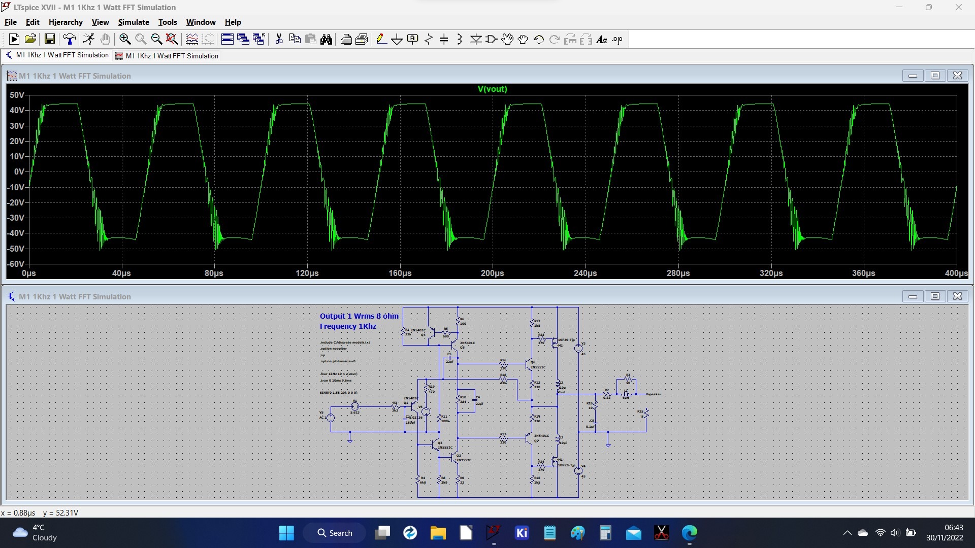

I'm just playing with the simulation to see if I can get any clues and the only two things that provoke oscillation past the clipping point are if the 0.22 are quite inductive (10uH) which is massive for a low value resistor and also the 22pF cap if it happened to be a wrong value such as a 220pF. No other clues though.

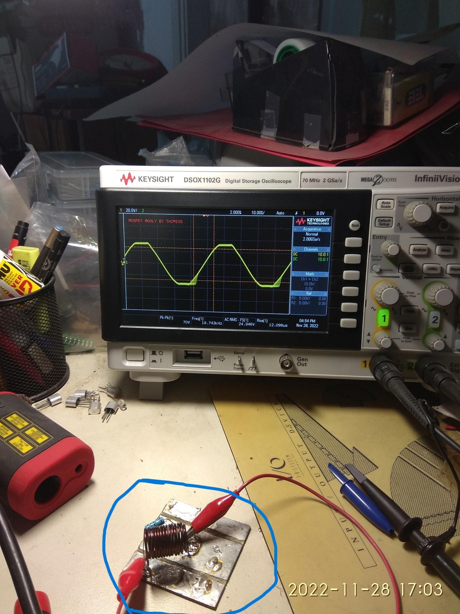

Please look at this picture.

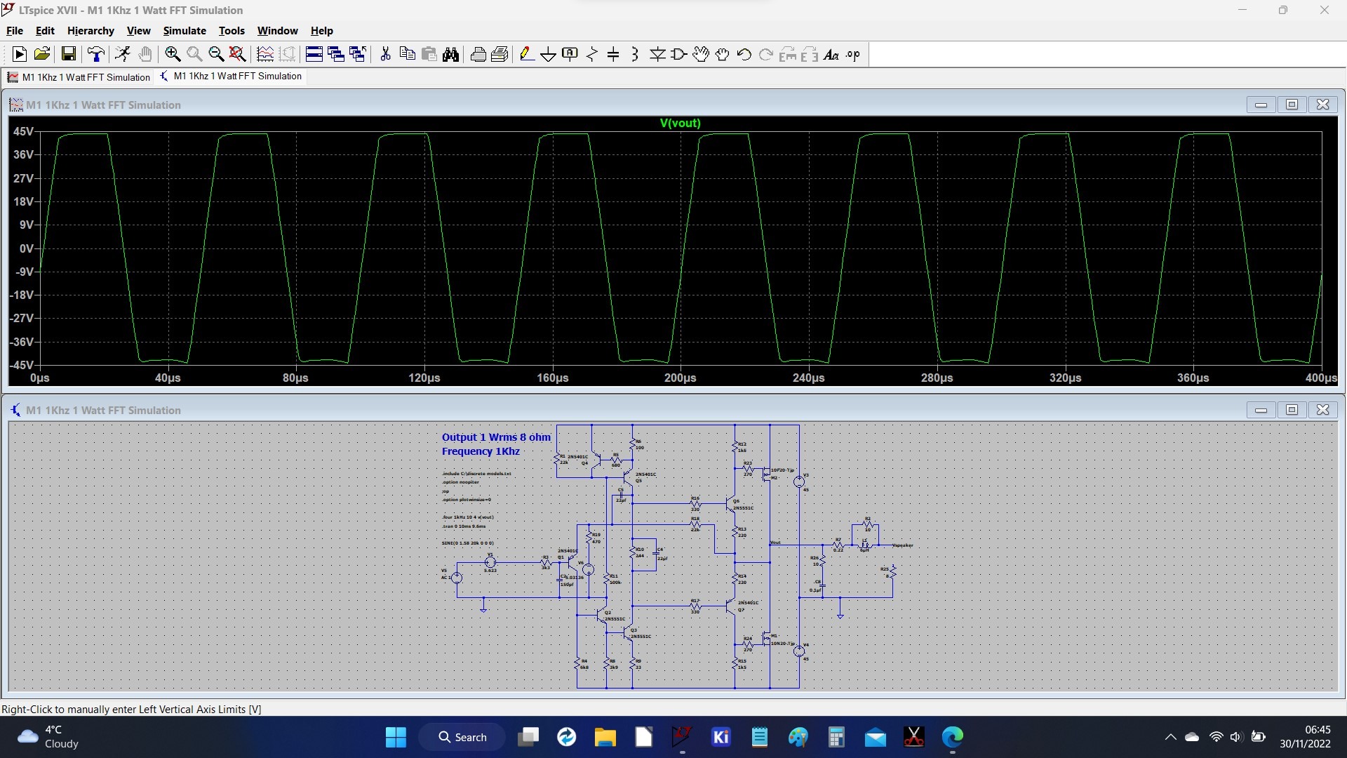

This is when inductance is added to the Drain (my 0.22 ohms). This is also using models for the Exicon FET's. It shpws the potential for instability is there when inductance is present.
This is with the resistors linked out. Bias current hasn't altered at all.

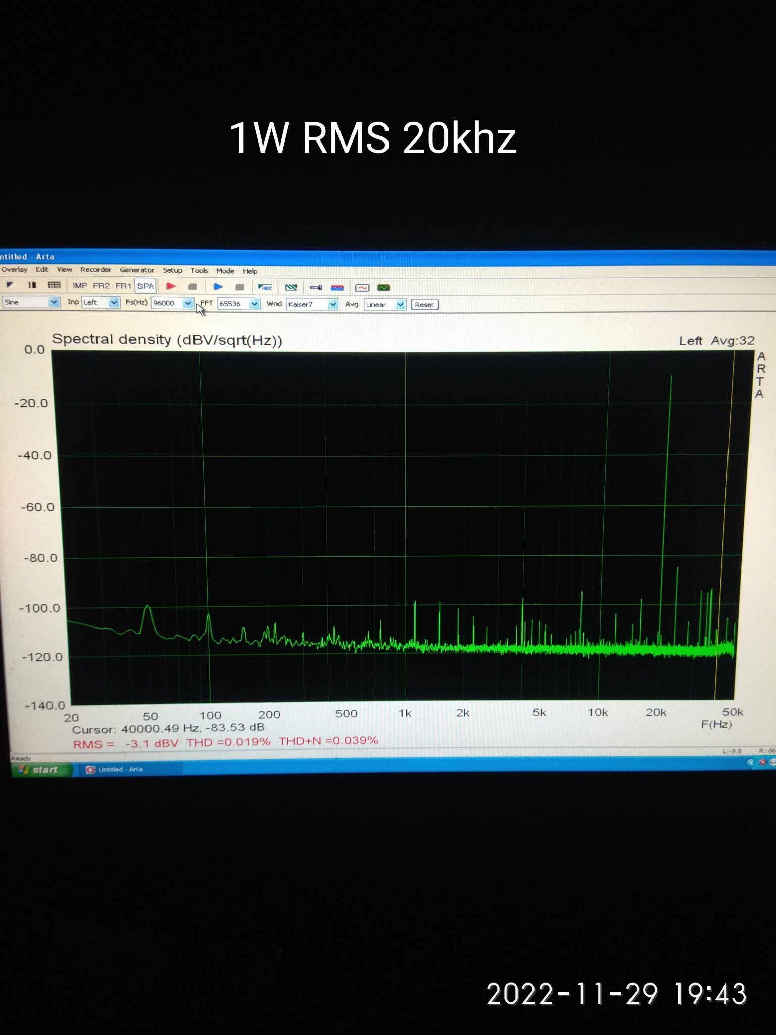

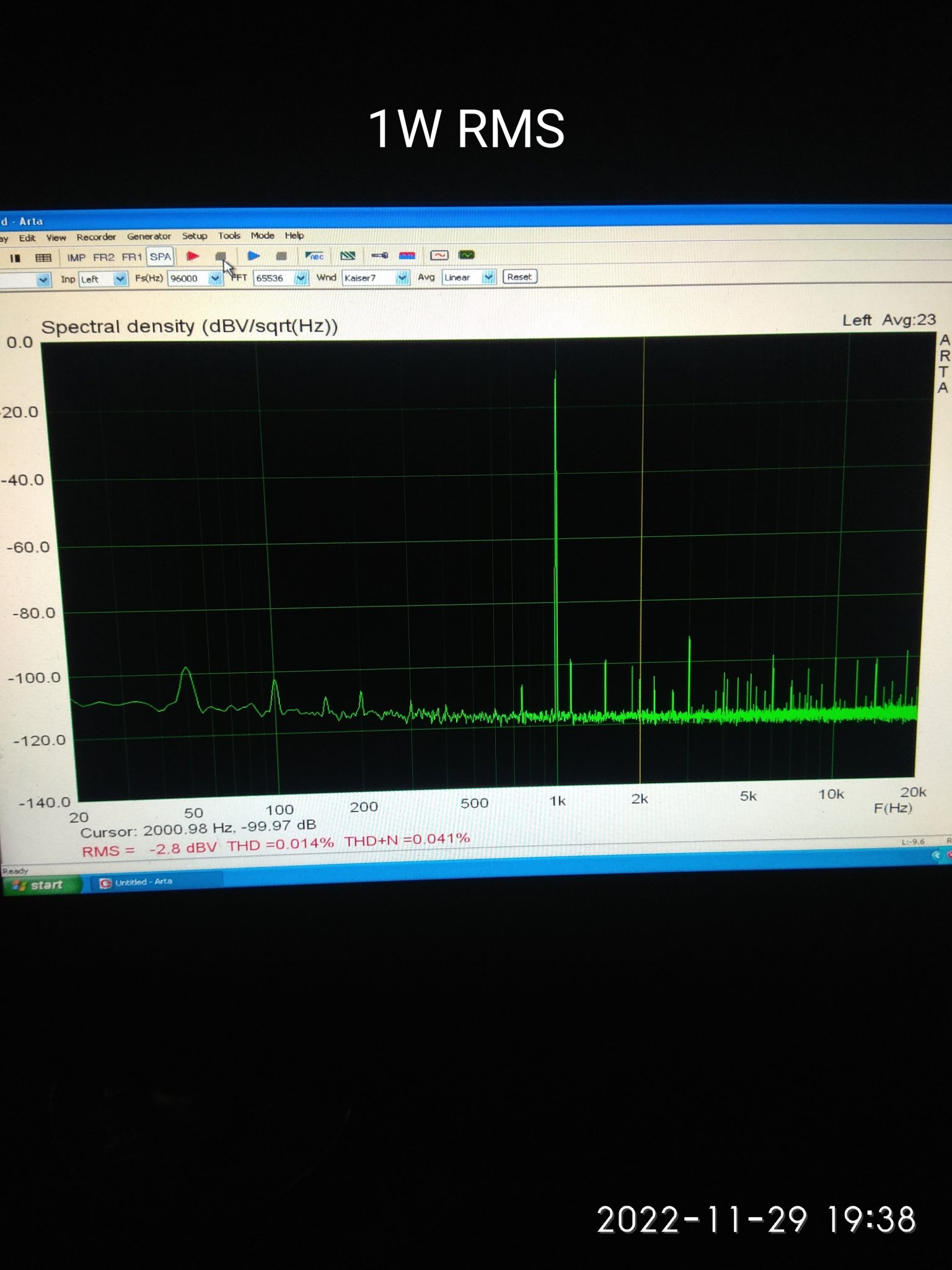

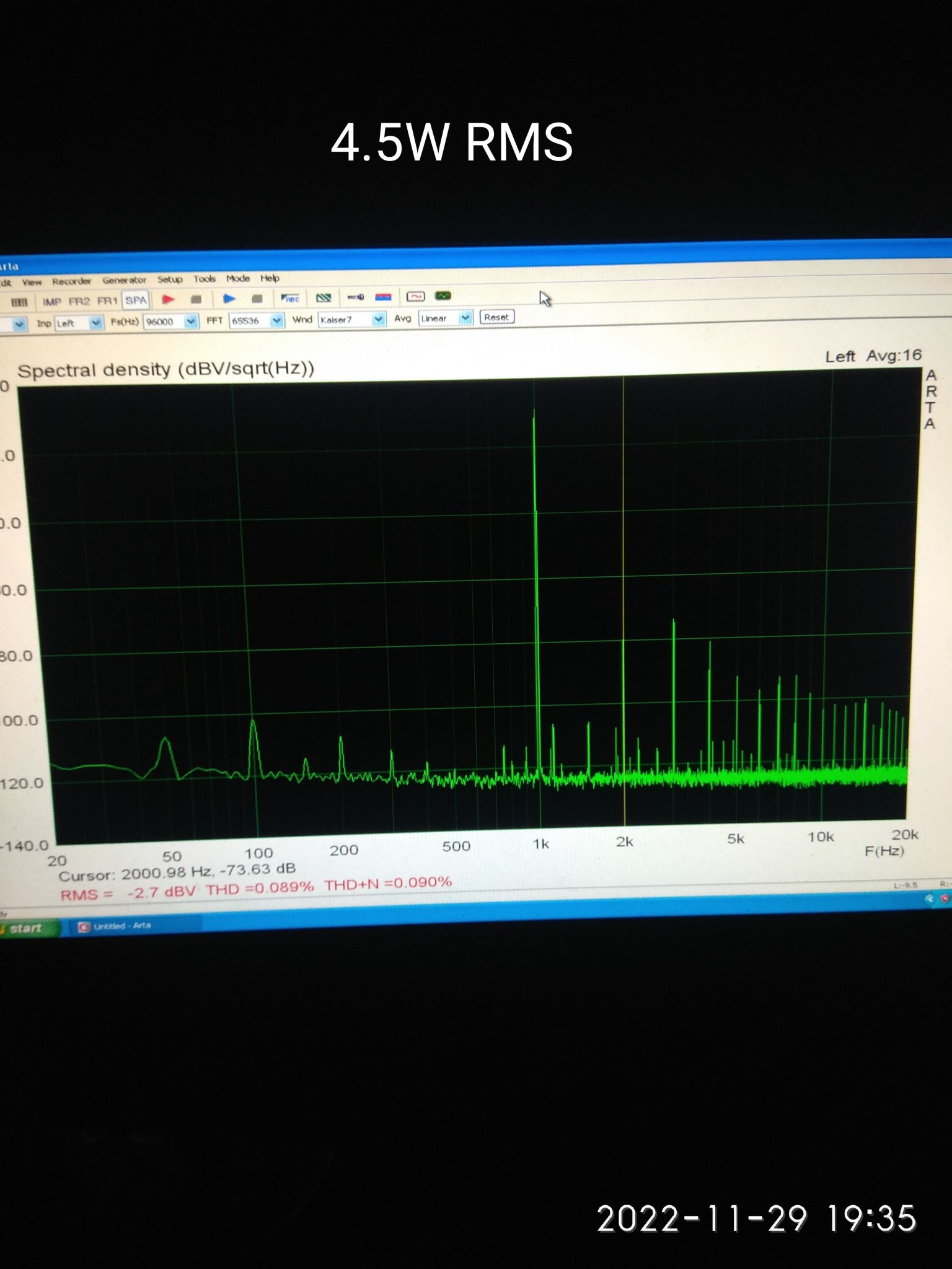

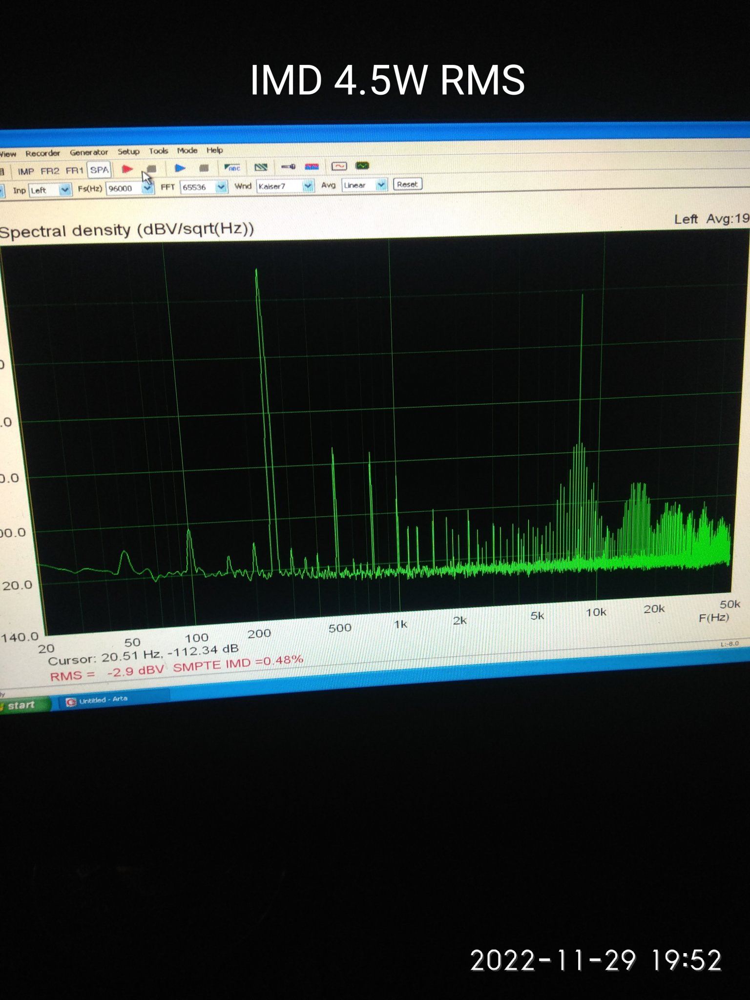

I will try to use no resistors and see the results.

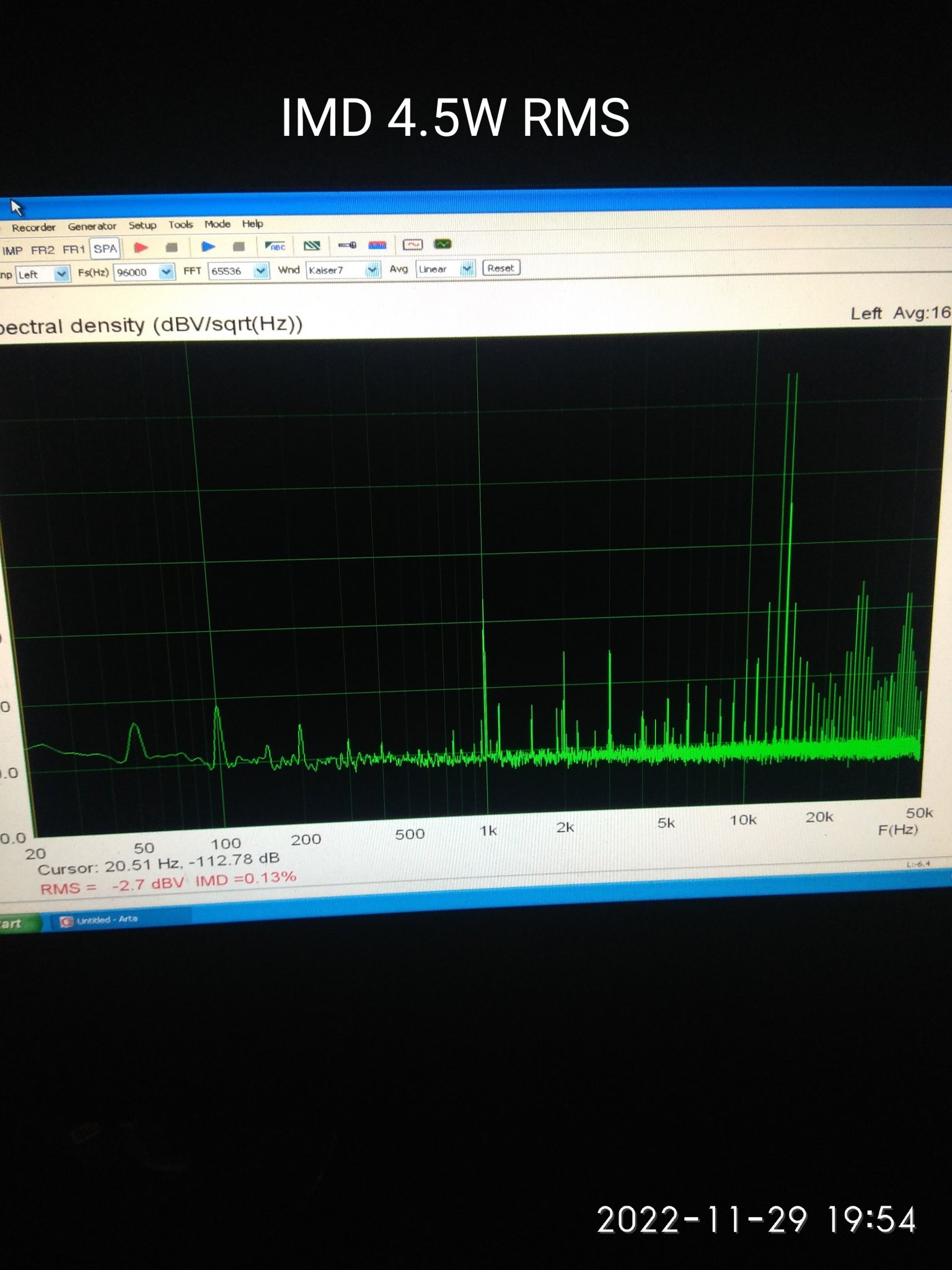

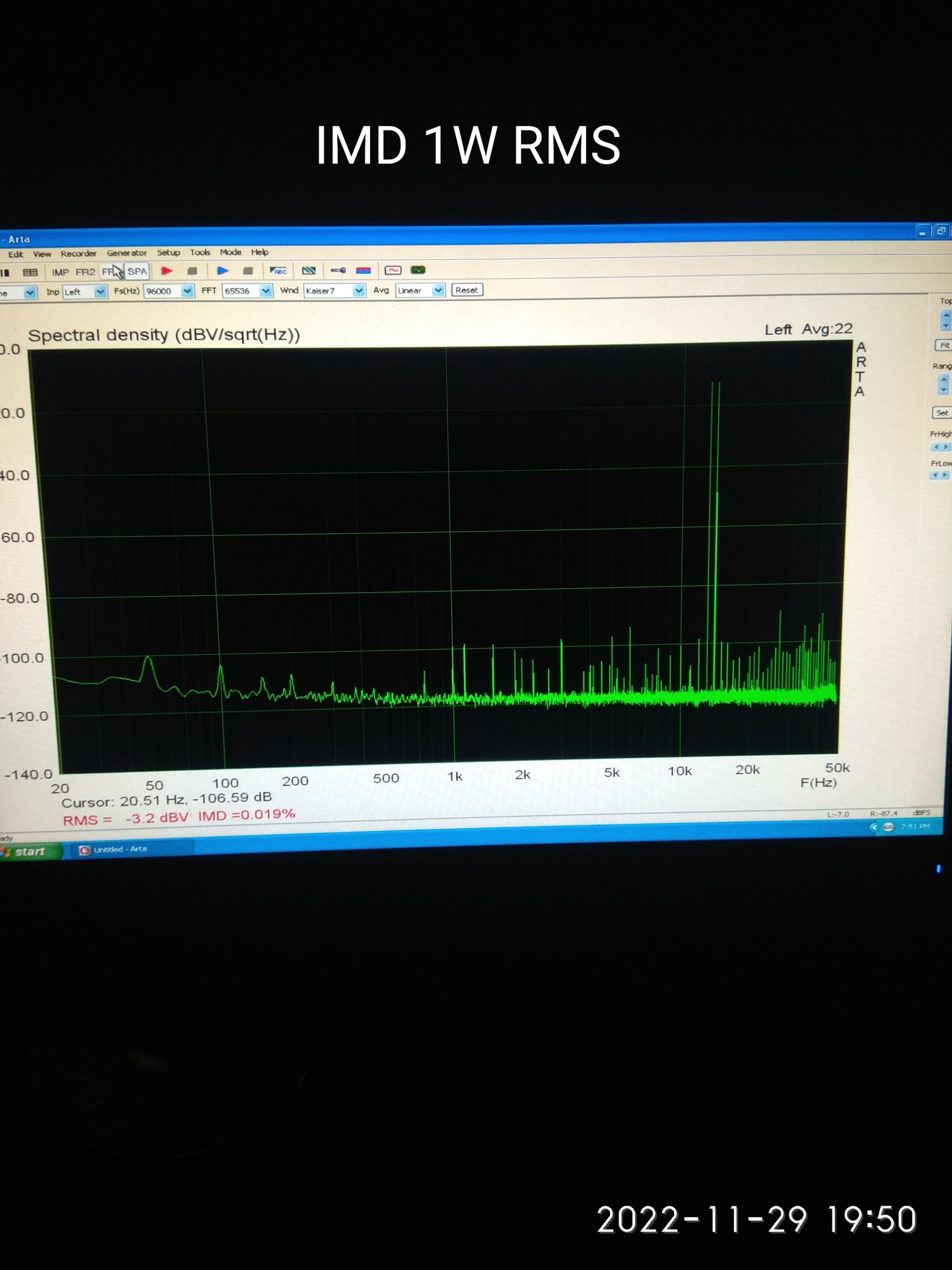

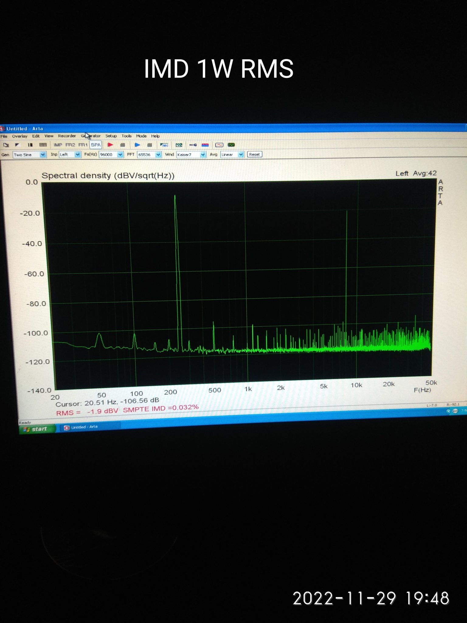

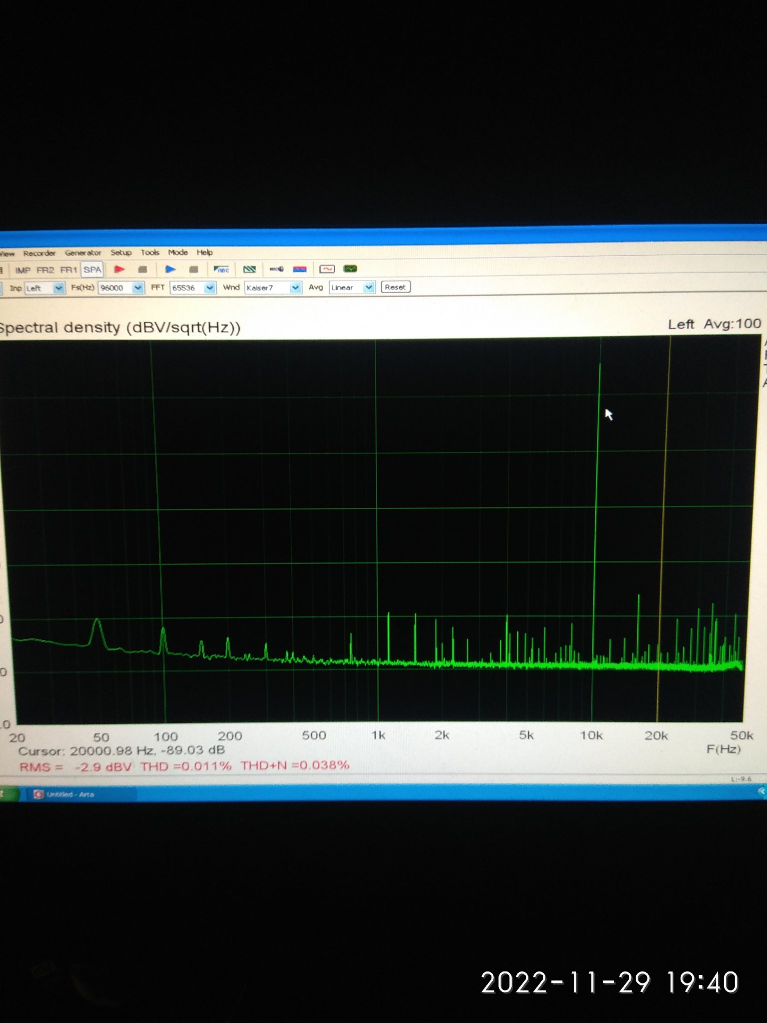

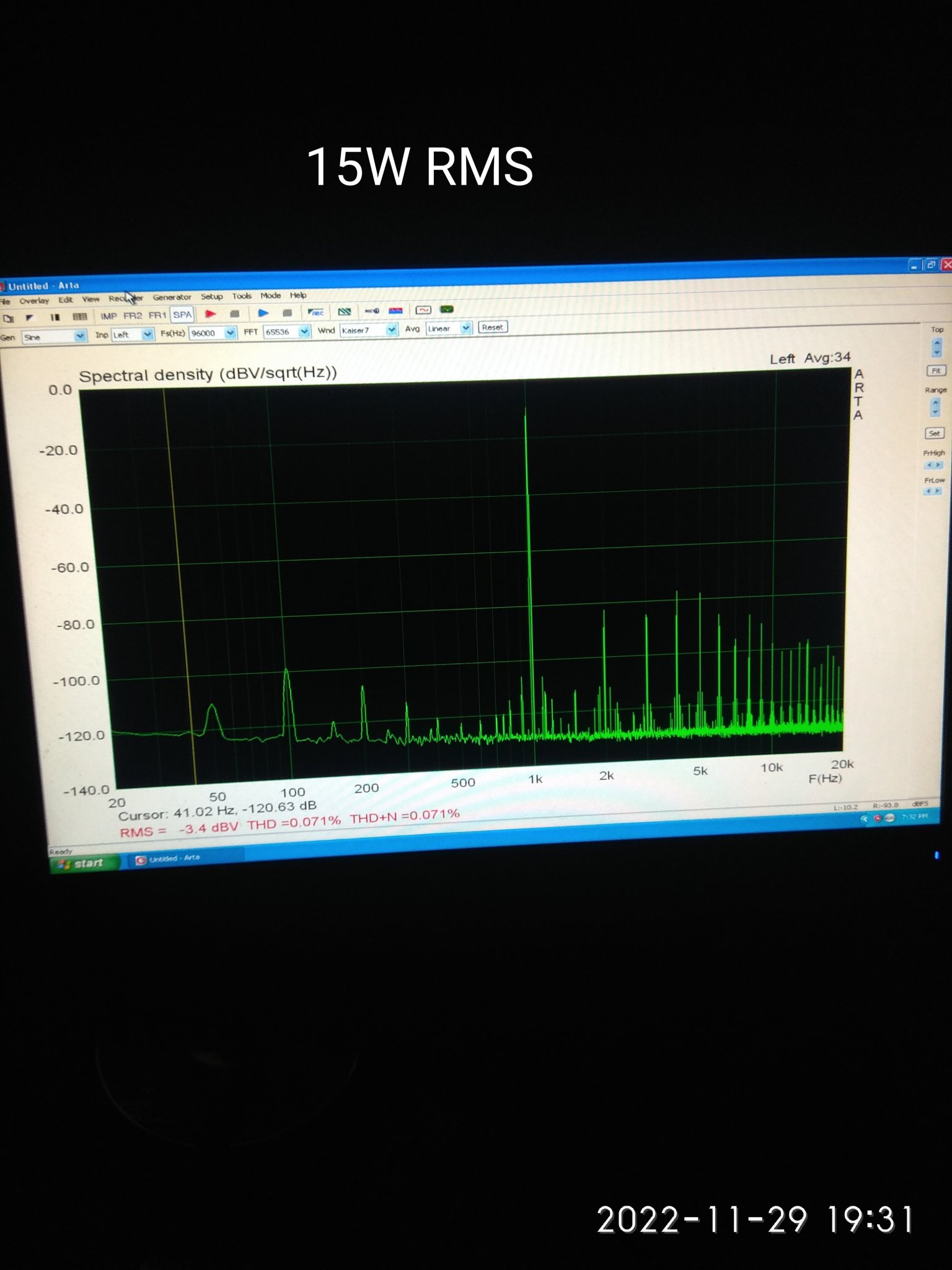

I have the THD measurements too.
I will repeat test if amplifier stay stable without resistors.
