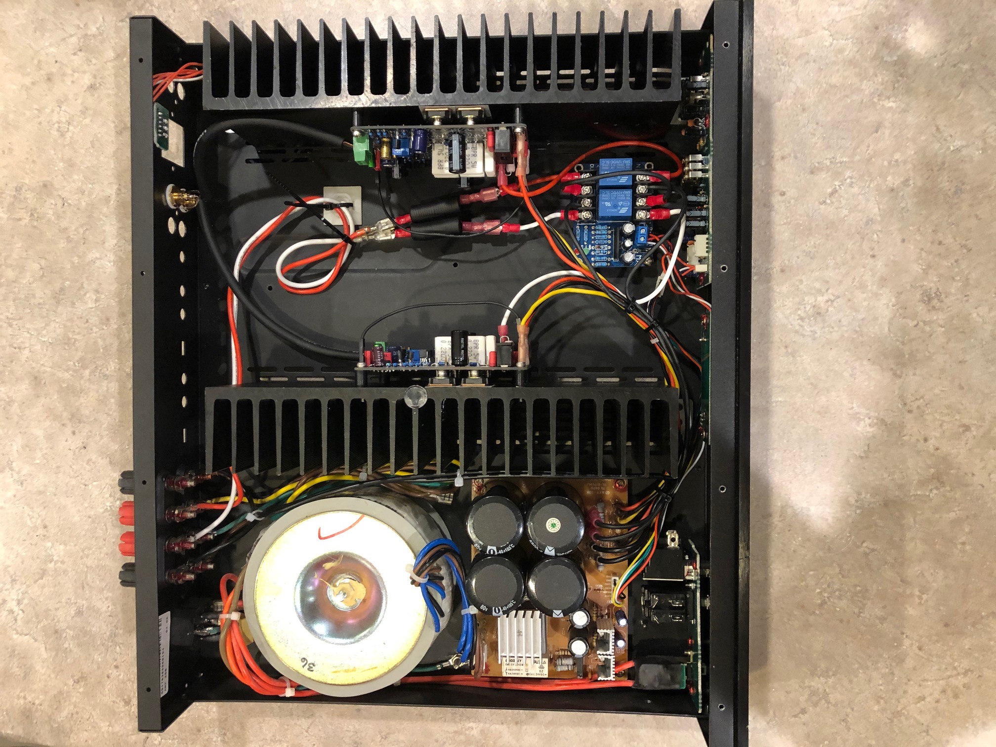

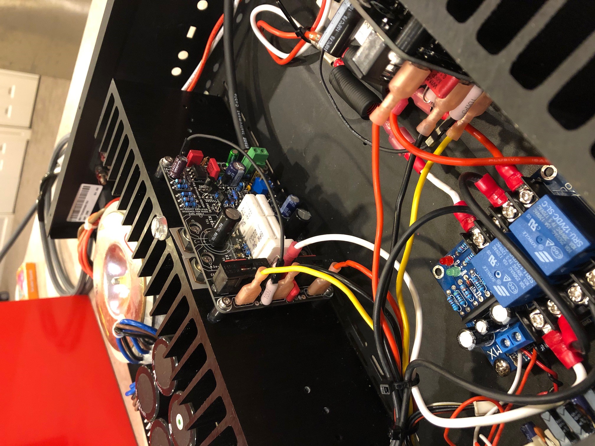

I'm back---had some trouble getting the amp be quiet (hum and buzz). Took me a few tried (like 4-5) to get the ground wiring quiet. Thought it was fixed with just the left channel installed, but when I installed the right channel, the ground hum came back. I think it was partly caused by adding speaker protection (from eBay), because I used the +15V from the PSU and I didn't know it shared a ground with the main secondary voltages.
After trying to fix the ground problem with wiring only, I ended up needing to separate the I/P Ground point from the PSU with a 10r 3W resistor. As soon as I added this, the noise floor went extremely low. The transformer still has some mechanical buzz, but the hum can’t be heard without putting your ear on the speaker. Which for me, is plenty quiet since I usually am listening to music not silence.

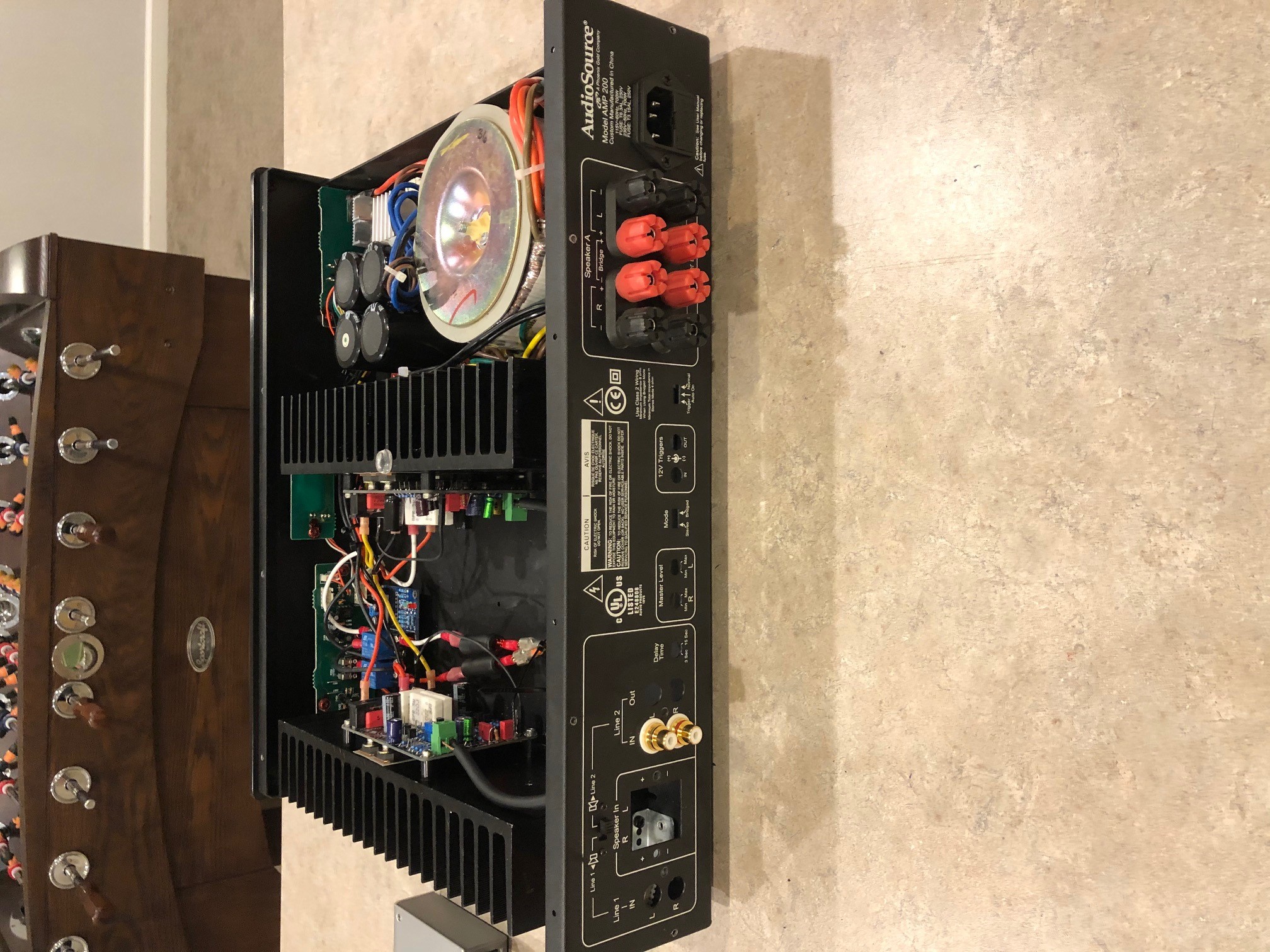

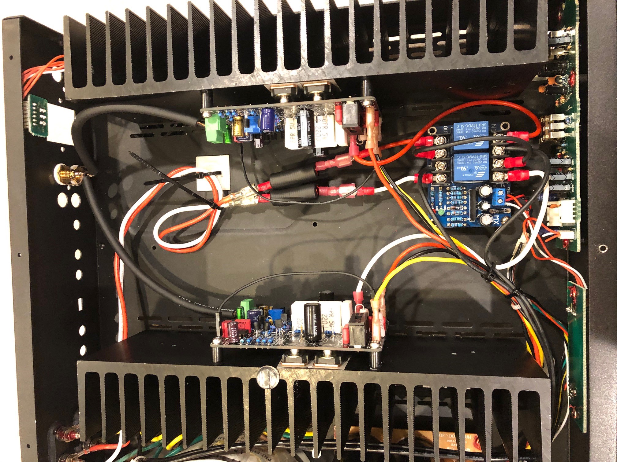

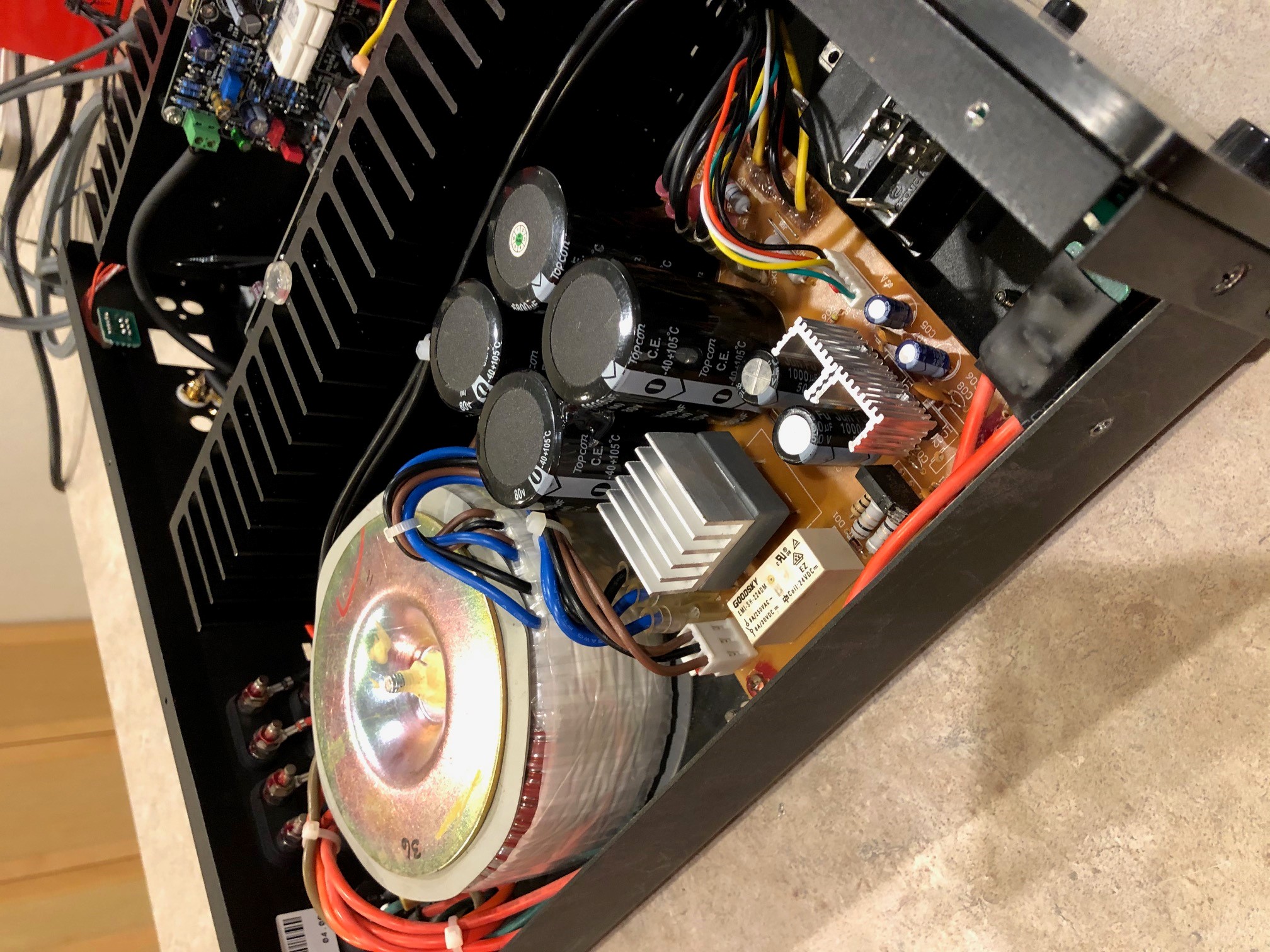

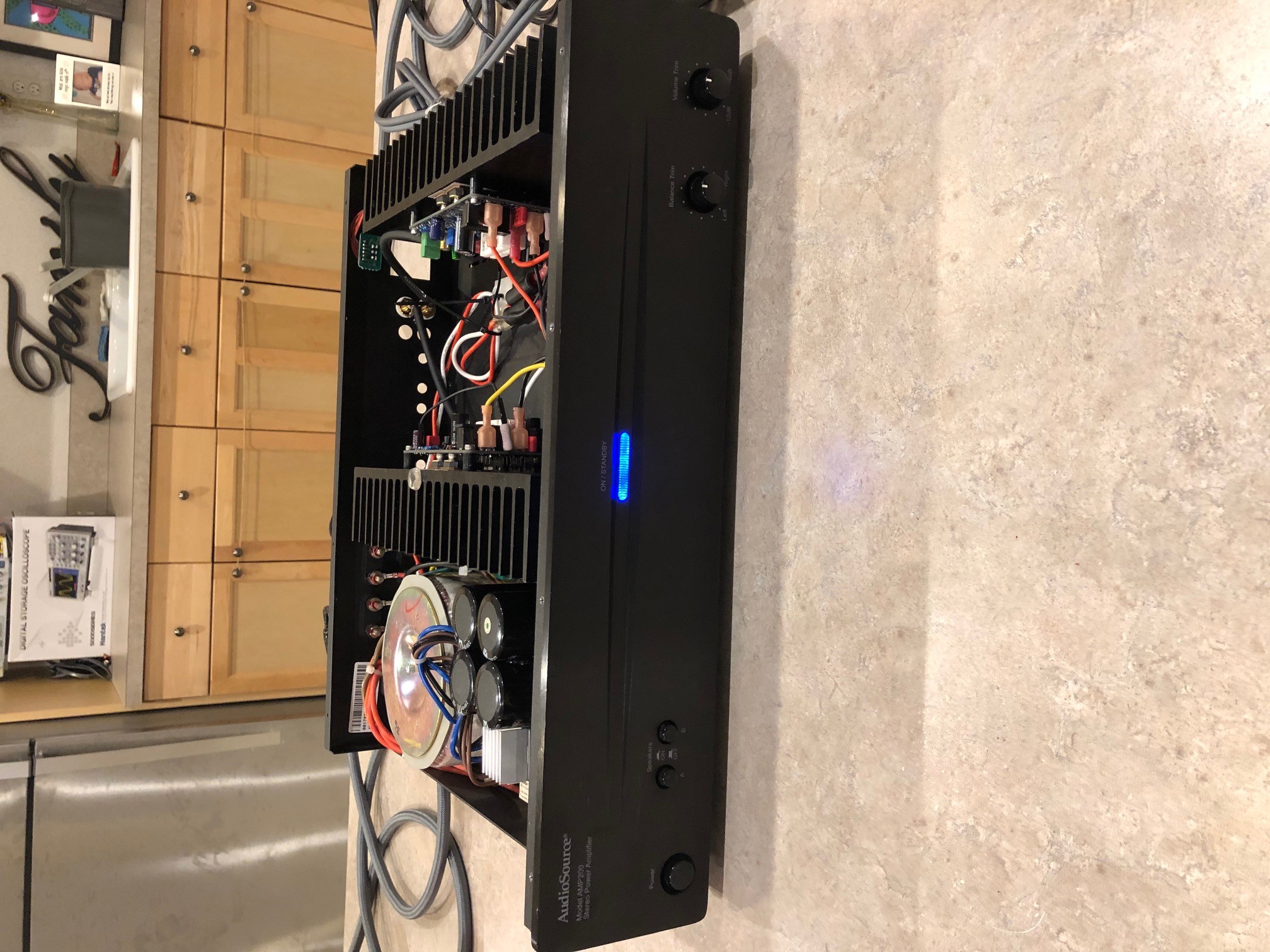

What’s in the box? 2-channels built from Prasi’s very nice PCB design using 2-pr of outputs inside of a repurposed Audio Source AMP200 case, which is a 2U case, with pretty beefy heatsinks (10”W x 3”H, 2” fins and ¼” base) and a 300W +/-50Vdc supply, which also provides +24Vdc, +/-15Vdc. I also used the IEC and speaker connectors, with new RCA's and removed all unused parts.

I'm really pleased you are enjoying it (mine is on and playing away as I'm typing this 😉) and I think you will find the sound grows on you the more you listen. It really is an amp that lets you explore the music.
I like your case as well, it all looks a perfect fit.
Can I ask a simple question, but which I can't seem to do the math? What size fuse are you using for the rails?
I started with a 3A slo blo on the IEC, then (4) 3.15A Fast-blow, which lasted a month of sporadic use, then the left channel popped the negative rail.
I upped them to 4A fast blow, which have worked for 3 months and then today the right channel negative rail popped.
I am thinking of going down to a 2A slo-blow, or maybe a better option is going up to a 5A fast-blow? Not sure which would be better. I have speaker protection, so I'm not worried about my speakers, only that the fuses will give way before the drivers or outputs and damage the amplifier channel.

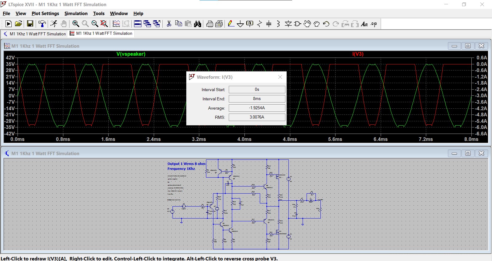

The mains inlet depends on the VA rating of the transformer. Lets say its 300VA and your mains is 120 volt. So at a basic level we 300/120 which is 2.5A but that does not cover inrush current. You are going to need at least a 4A Anti Surge type fuse for the mains inlet.
Rail fuses are a different matter. There should be no surges here, the exception would be if you had a speaker delay circuit that was not effective and that allowed the speaker to be connected at the instant of power on.
The big question is whether it blows in use listening to music or whether it blows at switch on. When exactly does it blow This is the most important question.
Lets look at the amp under full drive into 6 ohms which in practice would be pretty extreme. This in on 45 volt rails and driven up to clipping. The current in one rail is shown. The other rail is a mirror image. The peak current is nearly 6 amps. The simulation has calculated the RMS and average current.
So what to use. Peaks can draw around 6 A, more if the load is adverse. Its extreme use though although if you want fast blow you have to cover the worst case peaks. Slow blow and you will get away with lower for any normal use. I would think 4 amp anti surge for the rails should cover pretty much any usage tbh.

Thanks for the help.
No changes to the suggested BOM on both channels.
Speaker protection is a cheap dual channel from China.
The repurposed amp, is basically the same power but had 2-pr of bjts. About 80w at 8-ohms and 120w at 4-ohms. So likely it is 250-300VA xfrmr running +/-50V rails.
I will go to a 5A surge proof in the IEC and will get some 3-4A slo-blo to try on the amp rails.
It is only the turn on I have issue with, that was when the rails blew both times and I listen in an office so not driven hard.

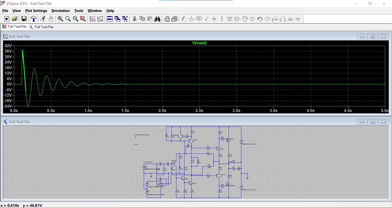

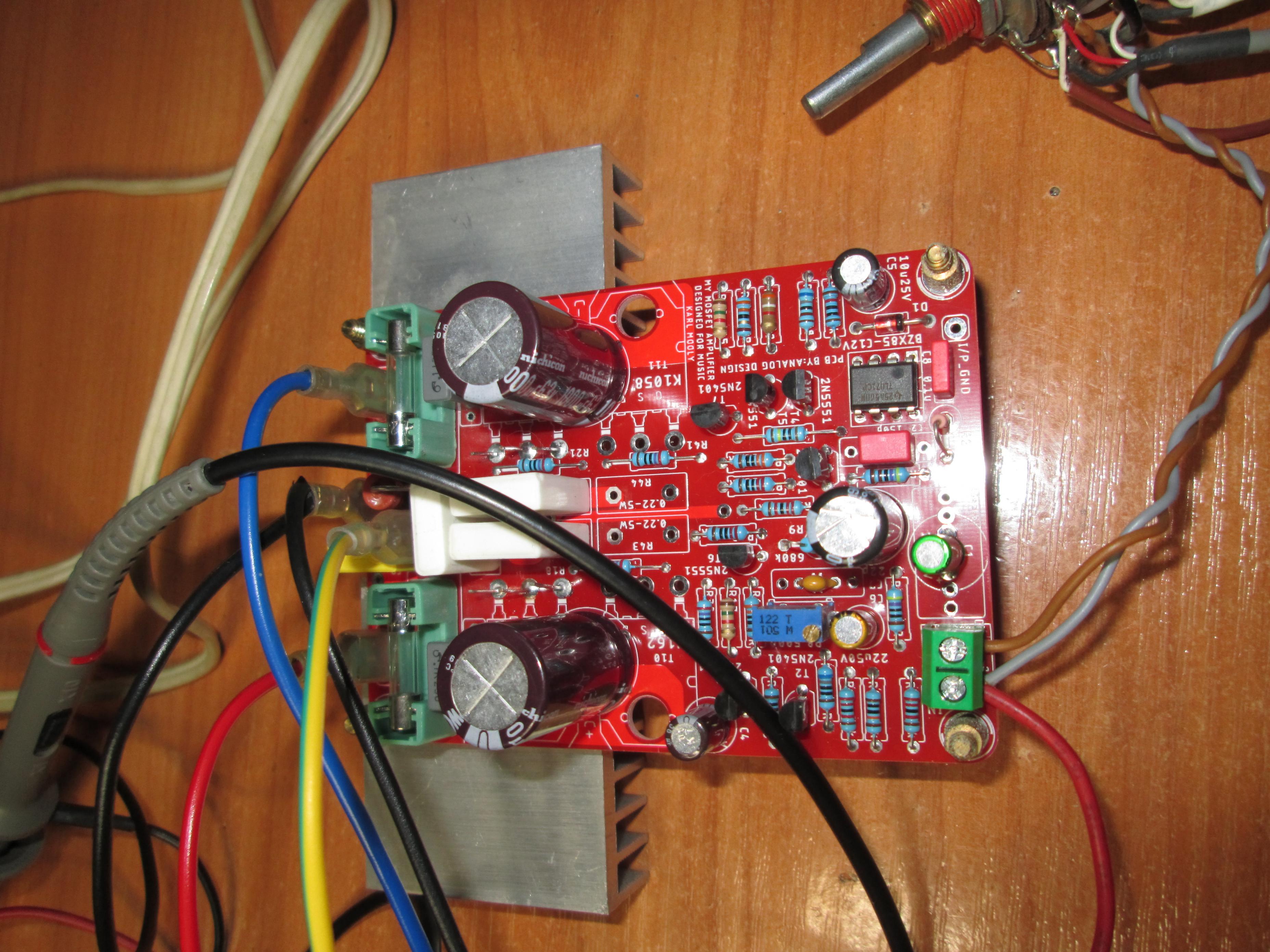

This shows the speaker output when power is applied. The servo creates a damped oscillation that finally settles to zero.
Although it takes several seconds before the output is truly at zero volts (for a 100% silent speaker connect) the main action is over in a couple of seconds.
To blow a fuse would mean the speaker was connecting in those first few moments... if that is what is happening.

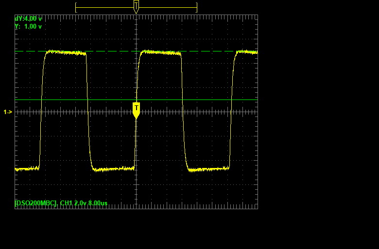

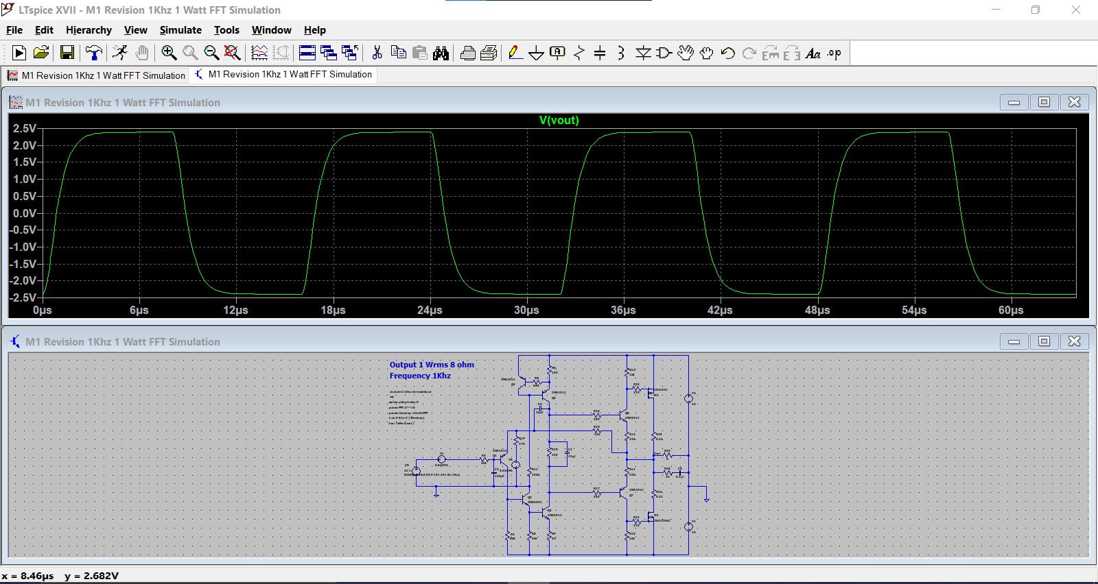

That's looking good

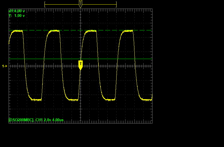

Those timescales on the scope seem to show 20.2kHz and 62.5kHz signals.
