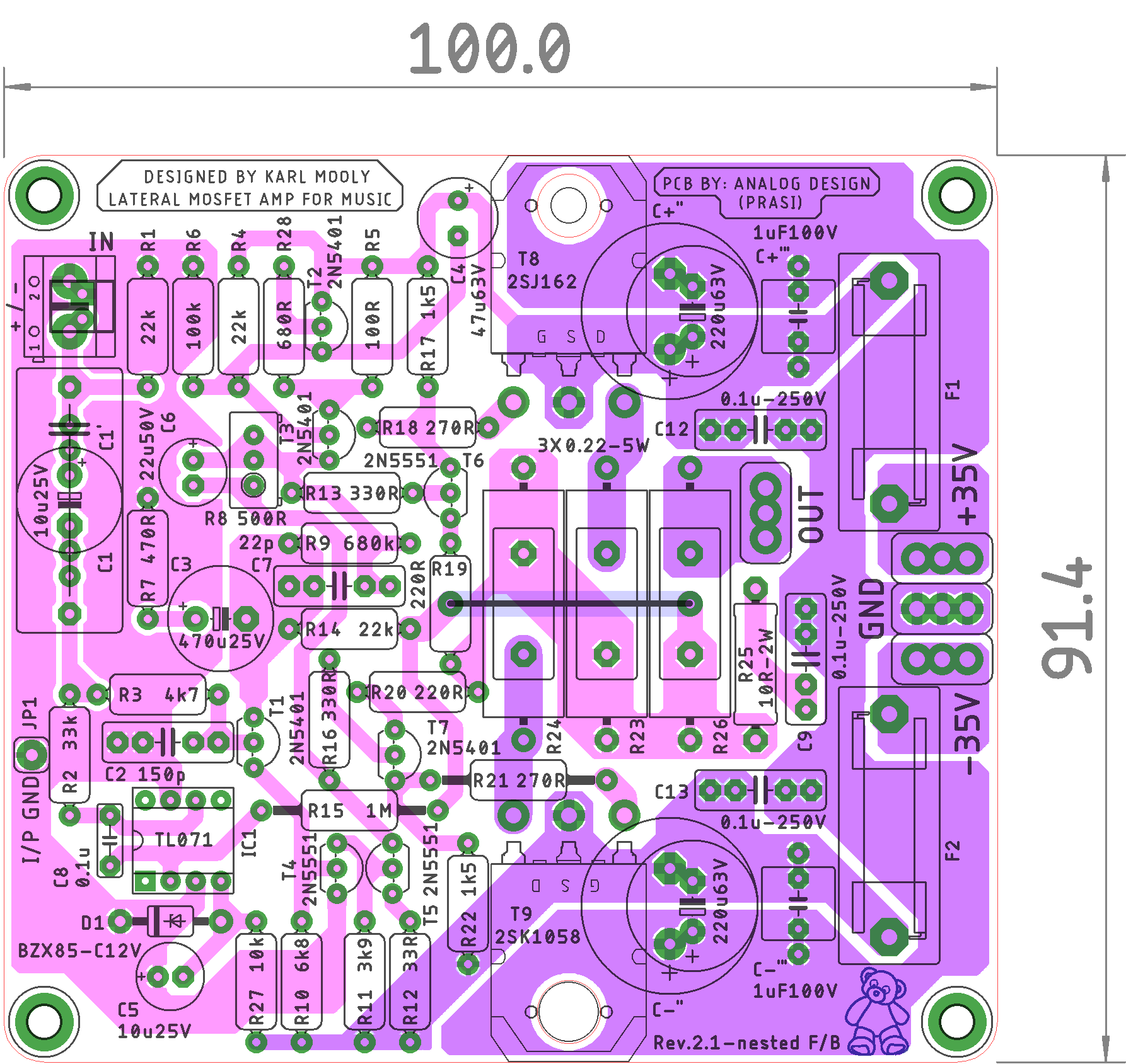

Beautiful work on the single output pcb.
Could we please have the Gerber?
Thank you !
Thanks!, Here you go sir!
regards
Prasi
mooly mosfet amp prasi_rev2.1_fb res_single pair_Cu_Bot.pdf490.2 KB · Views: 427
mooly mosfet amp prasi_rev2.1_fb res_single pair_top silk.pdf166.8 KB · Views: 342
mooly mosfet amp prasi_rev2.1_fb res_single pair_2018-09-13.zip720.5 KB · Views: 395

One hint for potential builders while populating the power resistors with Vishay MRA-10 or any other with a diameter of ~8mm.
The middle one (R23) can be raised slightly above the other 2 (R24 &R26), I think 3-5mm would be sufficient. R24 and R26 should be raised above the PCB board by 3-5 mm anyway.
This would ensure proper heat dissipation.

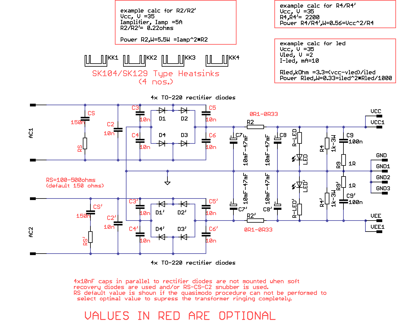

A good friend asked if its possible to make it as a single pair output and reduce the length to less than 100mm to take advantage of low board costs from China.
I gave it a try and here is the result.
It has the same features of the earlier board (caps, resistors, etc, even the logo).
regards
Prasi
