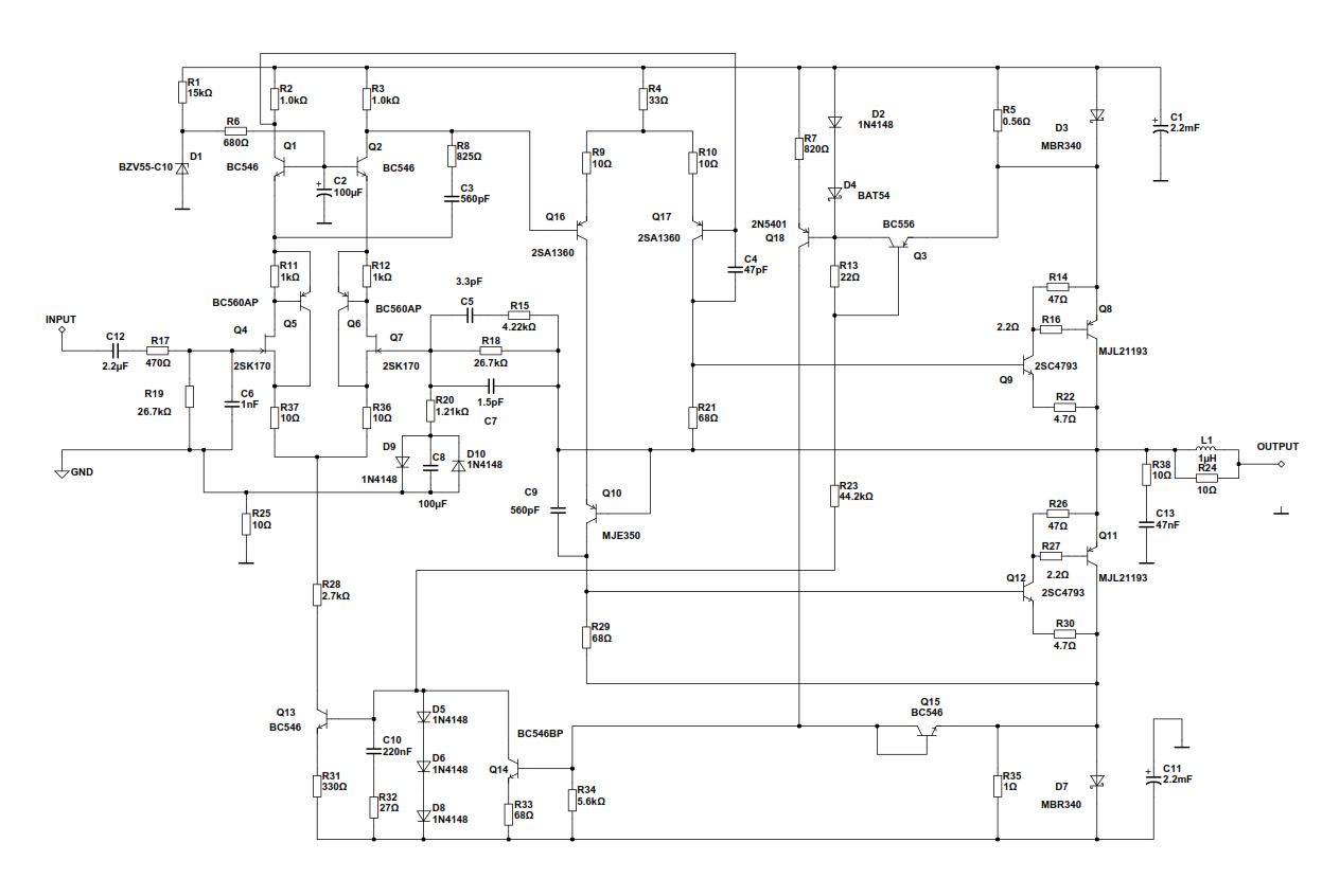

I noticed there is a +ve and -ve and signal ground. Is this setup for differential balanced inputs now? Do we need to ground the -ve input if not using balanced input?
Also, are you using MOSFET outputs or BJT's?
I did not ground the -ve: it is left unconnected as shown and works fine.
I have used BJT outputs: MJL4302.

What PNP did you use in Q10 and Q11?
Regards
Nice indeed!
Thanks Karl,
I used KSA1381E which I had handy.

Did you adjust other parts in the BOM to use this output device?
I kept everything the same. MJL4302 was maybe not the best choice due to its high fT of 35mHz...

Is this the right schematic for it?
Is there availability of schematic with component labels that match the board screen print?
Gain range of SC4793? (the lower one?)
Gain range of BC556? (b?)
Gain range of BC546? (b?)
Suggested startup value for the trimmer?
Value of C-Opt?
When is the 1n (output area) optional?
Rail voltage?
What value goes where the board says "R = 0 - 12"? (10?)
Also, SA1360 is discontinued and run out of stock; so, I need a substitute. I have authentic Philips BD140 (a near match except for twice the capacitance). And, are there support component (resistor value, capacitor value) changes to support it? OR, should I place an order for KSA1381E, which seems to be a match?

I just started the build stuffing resistors and diodes for past couple of hours. Realizing I don't have several of the kind of "odd" values. So looks like I will need to place order for the following 1% 0.25W axials: 2.2R, 4.7R, 1.21k, 68R. I also need to get the 0.56R 1W, 1R1W, 0.56R 2W. I also see I don't have some of the diodes, how critical is it to use a BAT57 for D8 and are there alternatives? And the two big MBR10H50's. Can conventional 10A silicon diodes be used there?
There are several places where the designation says: R=0-12 does that mean it could be a 0R jumper and no higher than 12R?
And to double check - resistor values are using the letter E vs R as in R=4E7 is the same as 4R7 or 4.7R?

The resistors values do not strictly need be 1%. Because of the advised metalfilm resistors i resorted to 1% precision.
Both degeneration resistors with 0-12 Ohm marking, use 10 Ohm.
Do not use a conventional diode for the TO-220 "by pass" diodes, because of the significant higher voltage drop. Use a low forward voltage Schottky.
To confirm: yes 4E7 is 4R7 or 4.7 Ohms.

And if you are using the same board as i have: there was an error around a 560p cap, where you have to cut 2 traces and make a bridge.
I attached my testing simulation if you like to measure things. Some components may be a bit different, i have tried many things 🙂.
The low value resistors near the output are not very critical, but the values are optimized for minimal distortion. The 1W resistors can be replaced with 500mW resistors as long as you don't use high voltages, max dissipation is about 100-150mW at 35V rails and a 0.5V sine wave. Most of the current goes through the diodes.So looks like I will need to place order for the following 1% 0.25W axials: 2.2R, 4.7R, 1.21k, 68R. I also need to get the 0.56R 1W, 1R1W, 0.56R 2W.
Elvee wrote somewhere that it has to be a small signal schottky, see the build thread.I also see I don't have some of the diodes, how critical is it to use a BAT57 for D8 and are there alternatives?
Schottky is key 😛. I pulled some SB560's from old switching power supplies.And the two big MBR10H50's. Can conventional 10A silicon diodes be used there?
I'm not sure about this. Simulation shows good results with 10 ohm resistors, but that is with my 2sk369 models. Simulation with 1 ohm shows oscillation.There are several places where the designation says: R=0-12 does that mean it could be a 0R jumper and no higher than 12R?
