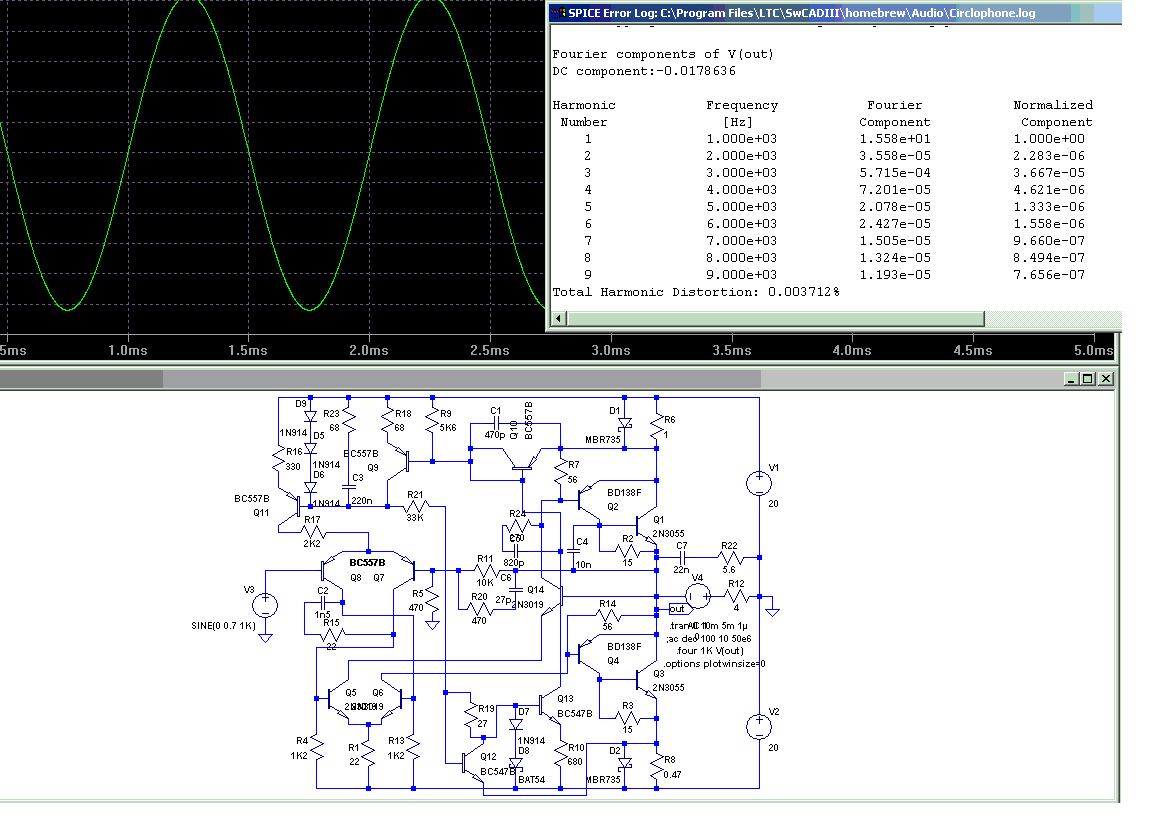

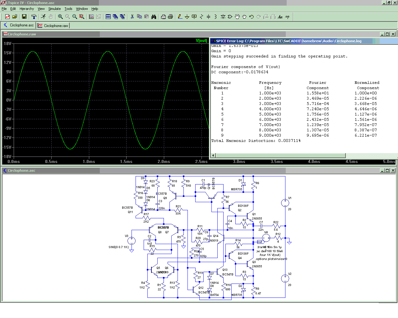

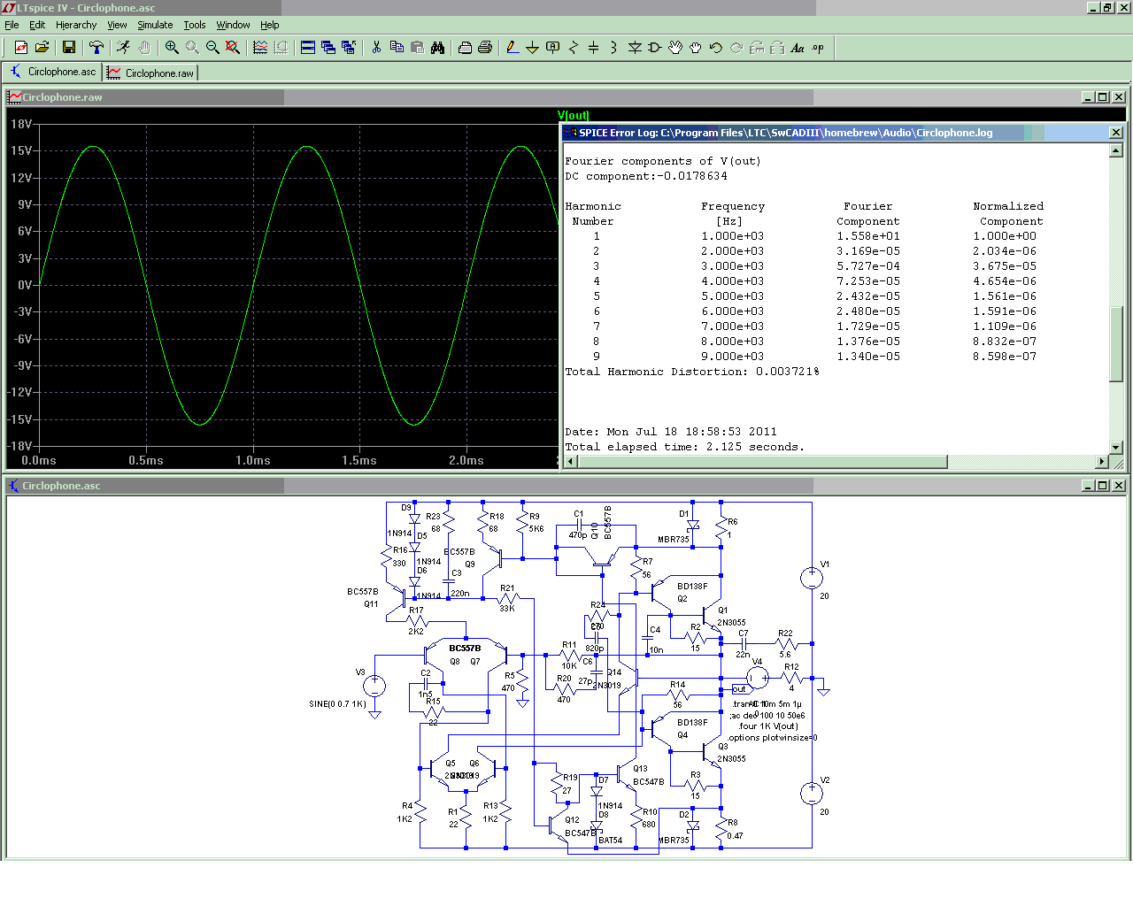

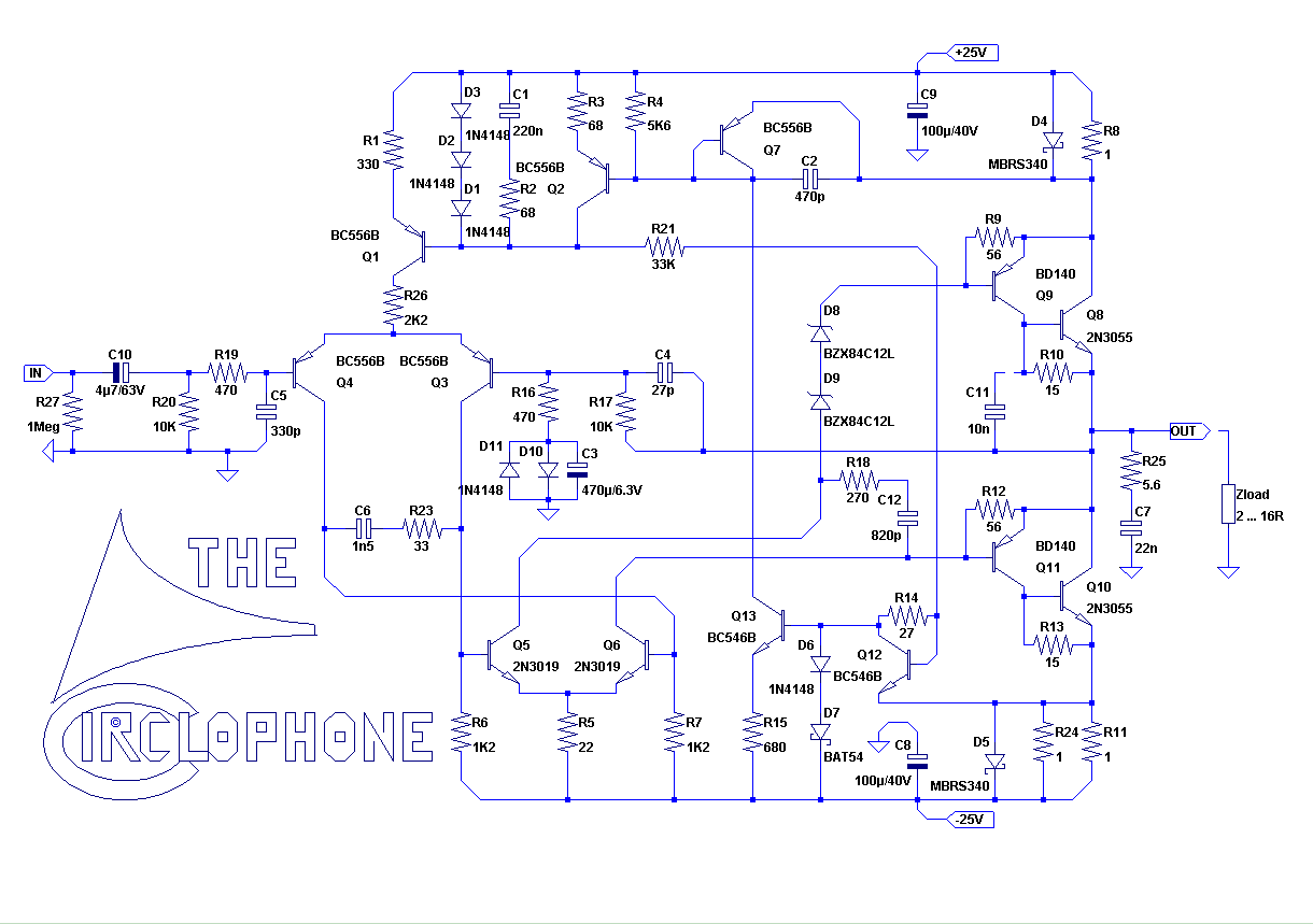

Replace the two Zeners with one NPN in cascode?
I mean w. base referenced to output...
Q6 already rides one emitter (Q11) below the output,
both Q5 & Q6 should then see same collector voltage.
Here is this idea put to the test: once again, the change is almost insignificant (-2ppm), but at least, it's in the good direction.
Cascode side move looks right, but other side of 820p now connects
Q13 Q10 Q9 instead of Q4 Q6. Subtle reason for this, or simple oops?
Oops!

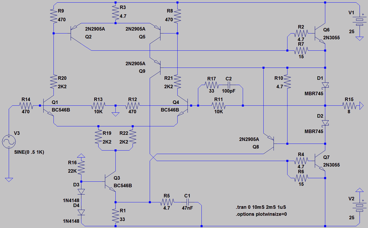

Elvee, could you explain a little how the bias servo operates? I don't completely follow how the network of Q2, Q7, Q12, and Q13 works
In fact those transistors form an "AND" gate but in the analog domain: for Q2 to conduct (and thus to reduce the quiescent current via the common mode loop), a voltage has to be present across R8 (i.e. a current must flow into Q8) AND the compensating transistor Q7 has to be biased, which requires Q13 to conduct, and therefore ultimately Q10 too (Q12 is just a compensating transistor).
The subtlety of the circuit is that it doesn't simply work digitally, but in an analog manner too: if the current in one of the output transistor is lower, this can be compensated within certain limits by an increase in the other one.
The result is that the currents can never fall below a minimum of 80mA, and vary in a complementary manner.
This also forces both OP transistors to always remain active, and I mean really active: it isn't simply a "passive" bias current superimposed on the working current: not only is each transistor active, but so is the whole upstream circuitry, up to and including the input stage.
This means that the OP transistors play no role in deciding the amount or the repartition of the quiescent current, nor the output current's value.
This is decided at a signal level, and is the result of the "negociation" taking place between the two control loops: the "noble" differential one and the ancillary common mode one.
Here is the schematic again for an easier reference.

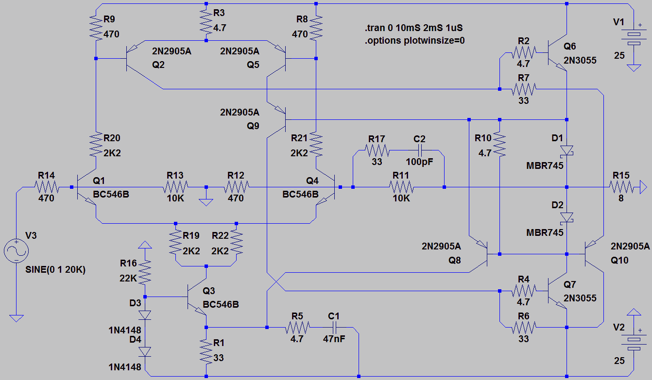

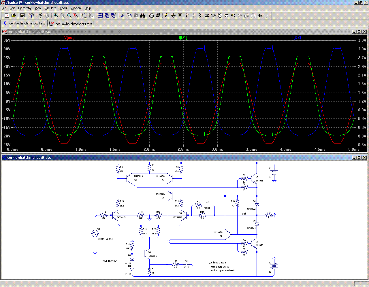

Was messin with your front end and finals grafted with a centralized quiescent control.
I come to realize both loops need independent compensation for stability. But I have
not yet mastered how to make (two schottkys, resistor, transistor) completely stable.
I return a control current to the 330R at the emitter of whats Q1 in your drawing...
Base of Q1 is simply biased by two diodes and 1mA. Works fine up to about 8K, but
anything above makes the whole sim go completely nuts...
Wasn't ever stable till I axed one stage of drivers.
But then I had to flip the whole front upsidedown.
Had no idea what I was doing, random experiment.
Stability still goes bannanas whenever it clips.
Recovery from clipping here is just plain awfull.
I would soft clip this with Zeners across R11.
One 2n3055 gets an assist from base current, the
other dumps base current into the negative rail.
So the collector currents will never be symmetrical.
Took me a while to realize I should stop obsessing
for a perfect current balance, not posssible...

Stability aspects of this topology are somewhat disconcerting: you can't use the old recipes applicable to traditional topologies.
The schemes and values I arrived at are largely based on trial and errors, most of them on the physical circuit because the sim is not quite reliable for dynamic aspects.
In addition, I've noticed on your "nothing to see" design that the current sensing via the schottky's seems to generate or at least facilitate some instabilities: I had to add an emitter degeneration resistor on the sensing transistors to achieve complete stability with a 1µs timestep.

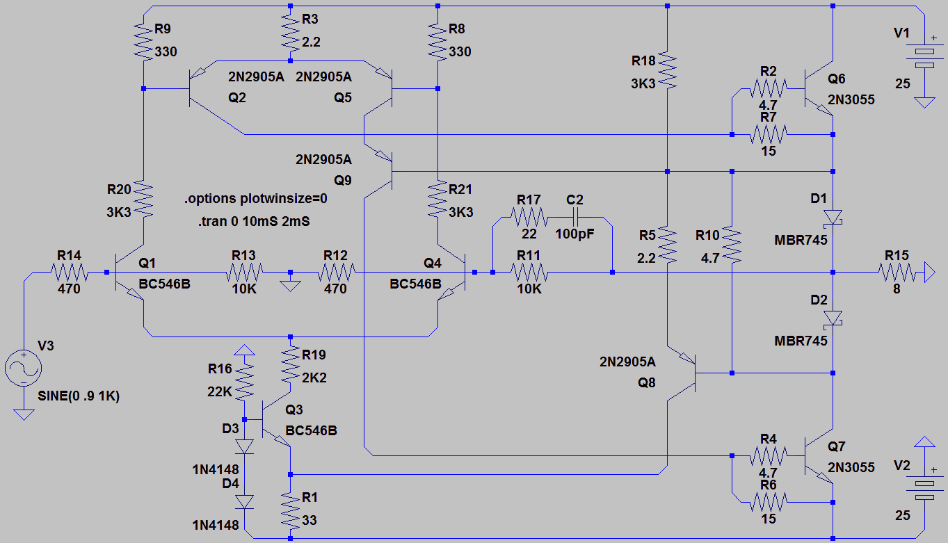

Both loops stable now.
Also ditched a resistor only needed in MOSFET version.
Distortion reasonably low, considering 2N3055 at 750mA crossing.
And 165mA of that bias is always on, bypassing both Schottkys.
I am assuming "circlo" refers to how the bias servo returns full
circle, to regulate the tail CCS? My second loop compensation
loosens the harsh grip it has upon this at higher frequencies.
Things get weird if common and differential loops roll too close
same corner frequency, easily avoided. Resistors in series with
caps take gains down without rolling the phase too much, and
FT somewhere I havn't determined where (probably 2N3055?)
does final roll.
The 15R's could be parallel 33R's to enhance BOM monotony.
47pF = parallel 100pF, 1N4148 = diode strapped BC546B,
22K = series 10K's, etc... Too many different parts always
a shopping nightmare.
It looks pretty stable, even without the CM compensation network.
It remains almost perfectly behaved, even when clipping.
The schottky's as current sensors give a very nice crossing.
Have you tried it in reality?
Is it thermally manageable?
Schottkys are selected for overkill sized TO220 package.
But due low voltage drop, rarely dissipate more than 1W.
Current sensors should be ambient temp, NOT thermally
bonded to outputs. OK to thermally bond diode to diode,
we want crossing curves to behave as a matched pair.
Q8 should be thermally bonded to same sink as outputs,
I think then you have an ideal situation for locking into
equilibrium between operating current and temperature.
As Q8 gets hot, all other quiescent currents decrease.
If Q8 itself runs away, the amp safely shuts down...
