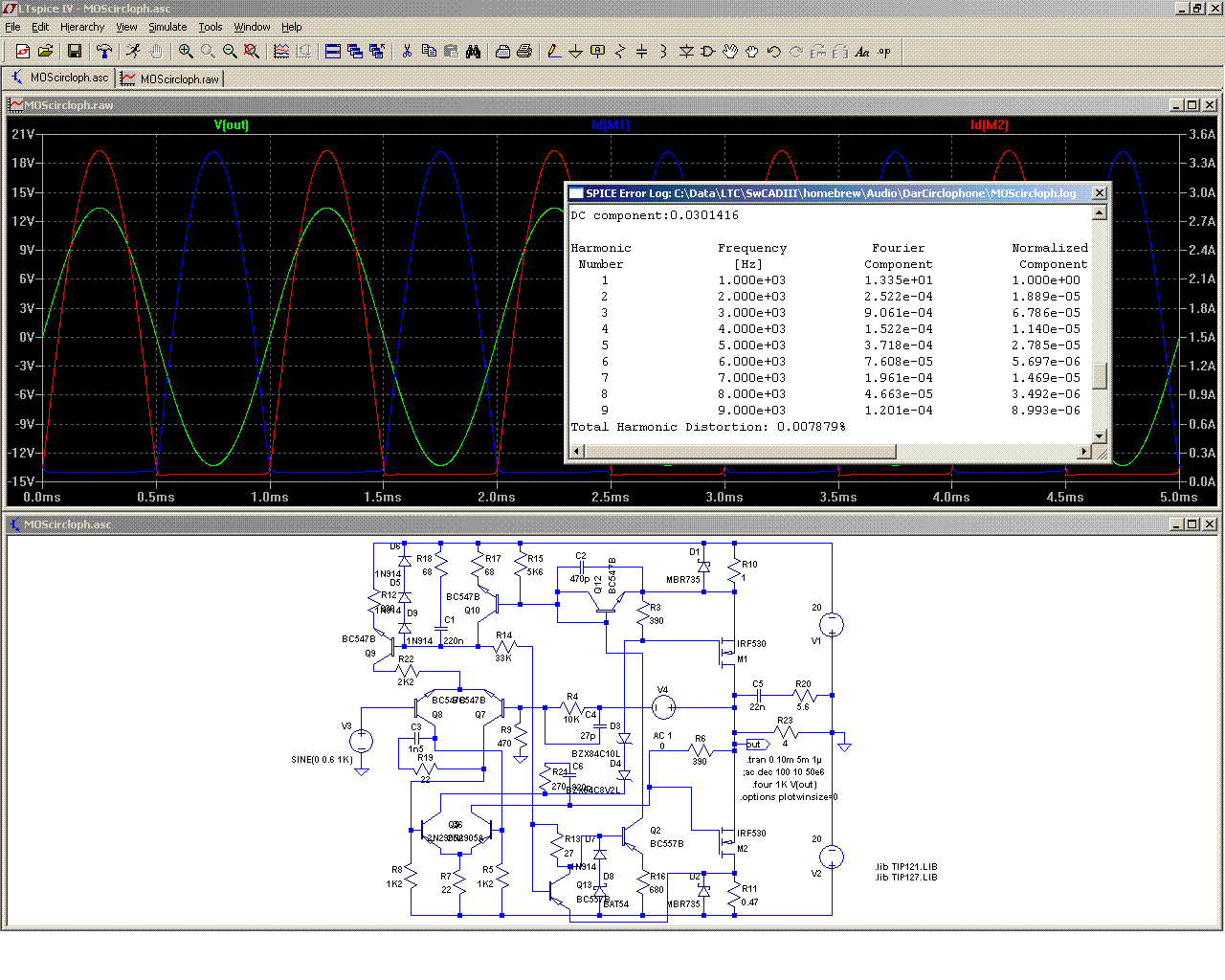

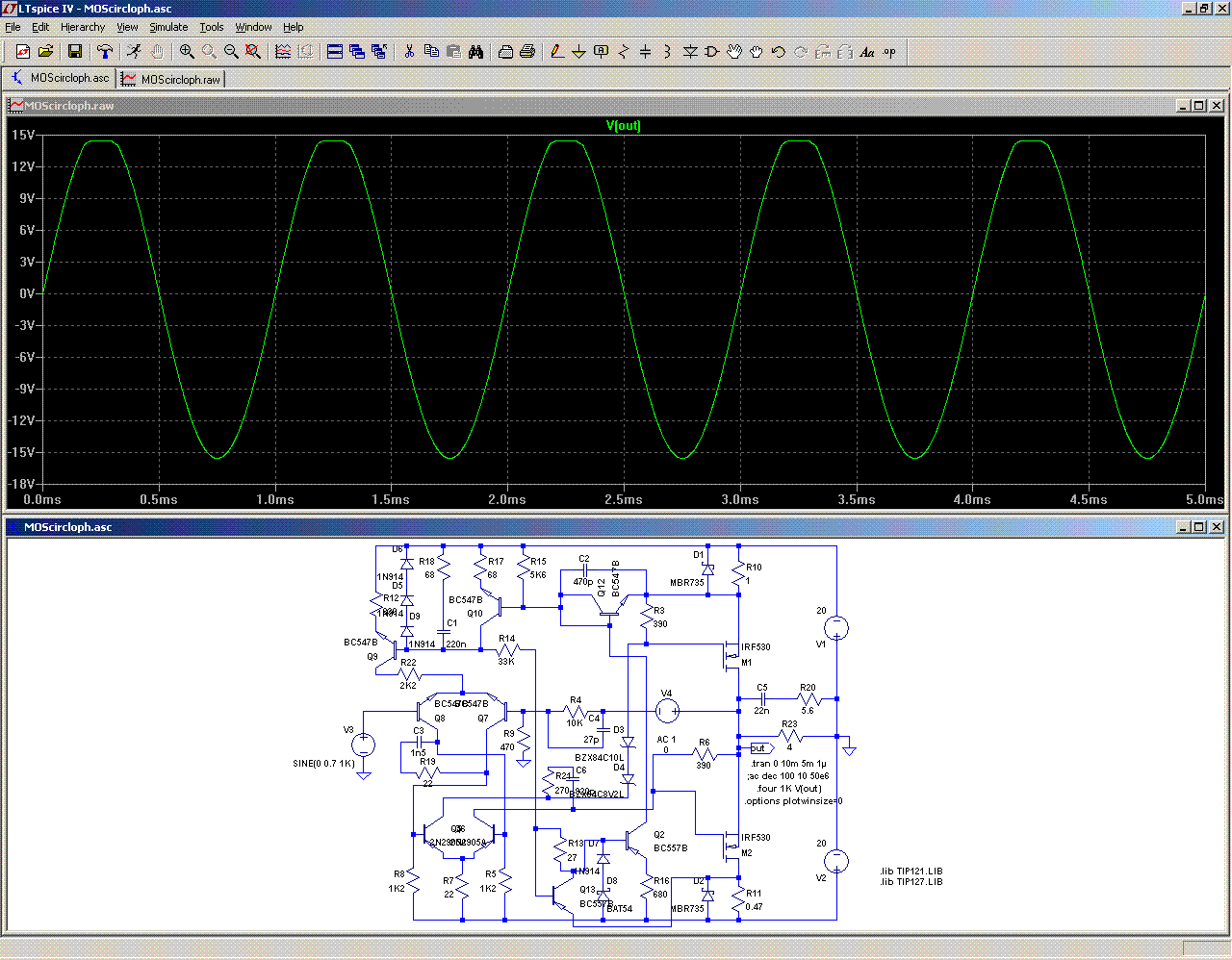

Here is the confirmation of what I said earlier, and also of the versatility of the Circlophone's topology:
I simply dropped two NMOS in place of the darlingtons, in the Ndarlington version, and it worked exactly as expected.
The only things that required adaptation are the G-S resistors that have been increased to 390ohm.
Also, the lower clipping value predicted on the positive side is observed: the clipping occurs ~5V below the positive rail.
If the input voltage is reduced to just under the clipping, the behavior becomes almost identical to that of the BJT version: the THD is a bit higher, probably because of the lower transconductance of the MOS compared to the bipolars.
The bias servo too works in an identical manner.
A reminder:
all this is simulation, and nothing has been built yet.

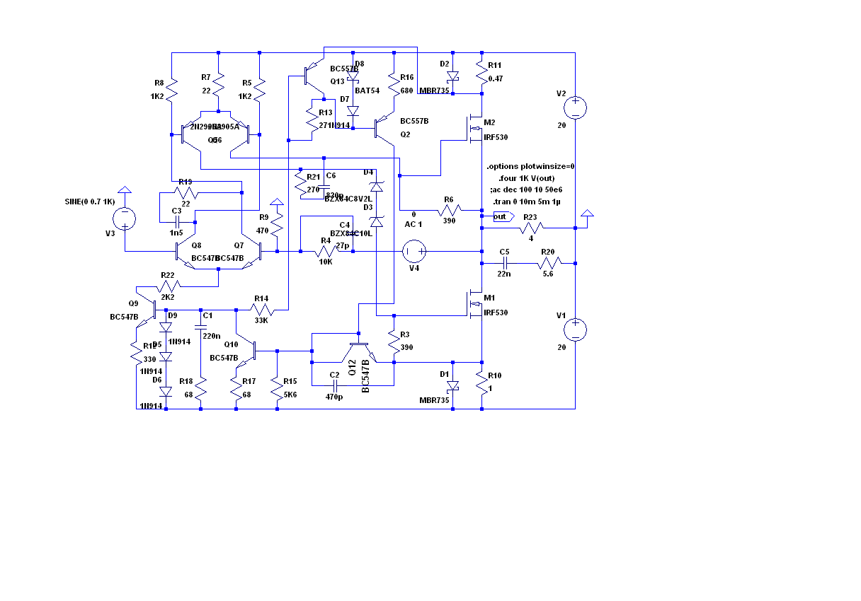

Because that's the view of the topology I am more familiar with.Why are the later circuits, particulary the last one upside down ? A bit confusing.
But I understand it can be confusing to others.
Here is a more habitual presentation:

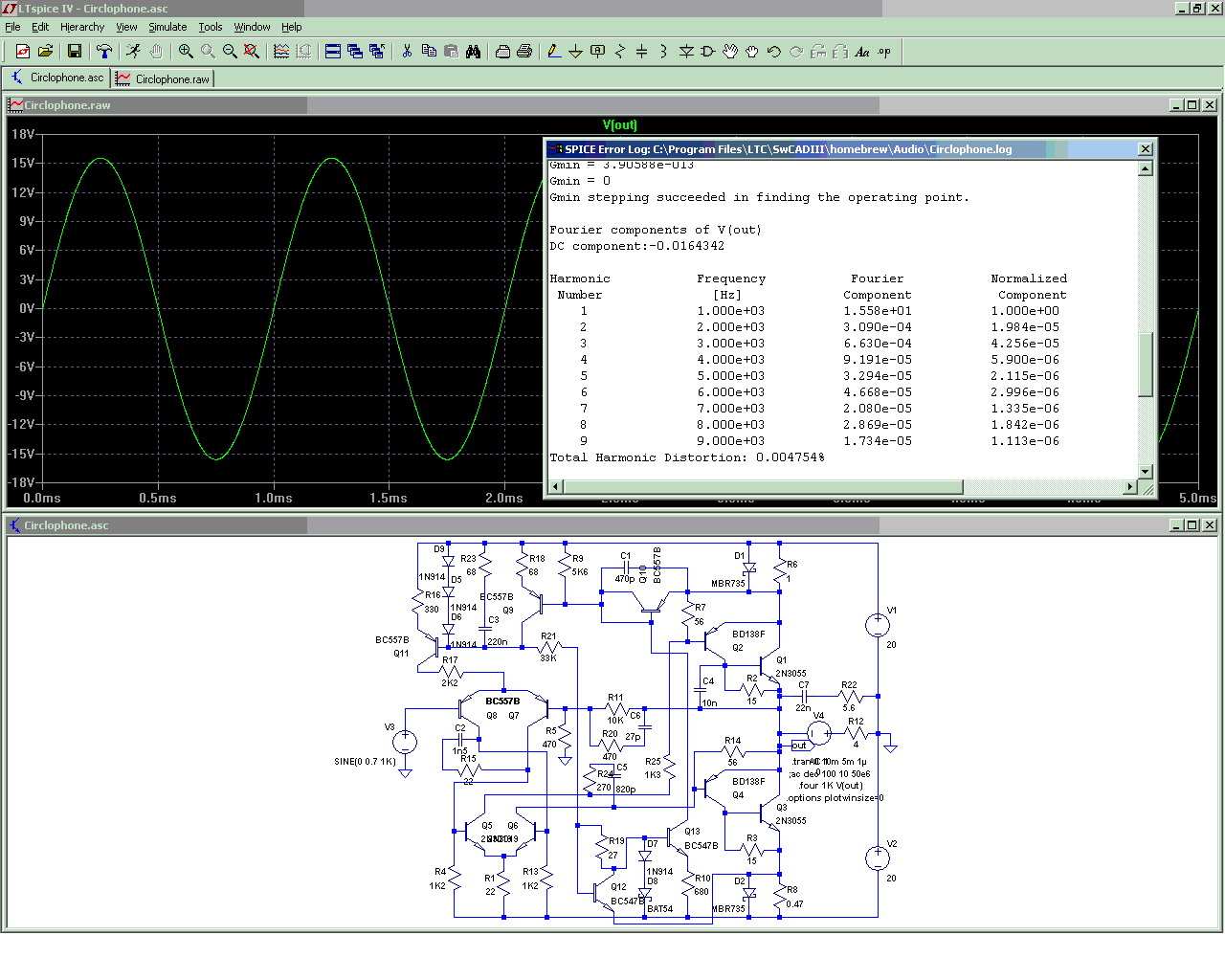

Hi elvee,
What is the main purpose of the 2 zeners in series (D3+D4 in last schema), in first schema value was 24v (12v+12v) but in darlington and MOS version it was reduced to 18.2 v (10v+8.2V)? Does the Threshold voltages differences comes to play here?
Today I will etch a board, and populate most of it. I will just have to get some 2N3019s and the schottky diodes.
No, it mainly has to do with the power supply: without D3 and D4, Q5 would see an almost constant voltage equal to 2*Vsupply.Hi elvee,
On the other hand, Q6 sees the full output swing, with an average equal to Vsupply.
This means that Q5 would dissipate on average twice as much power as Q6.
Adding ~Vsupply worth of zener decreases the dissipation of Q5 to the level of Q6.
This improves the static balance of the phase-splitter, and avoids the need of a heatsink for Q5.
The first schematic is shown with 25V supplies, whilst the other one uses 20V rails.
This balancing is purely static, and does nothing for the dynamic asymmetries caused by the Early effect.
It might be advantageous to replace the zeners by a resistor, but I haven't (yet) explored that option.
