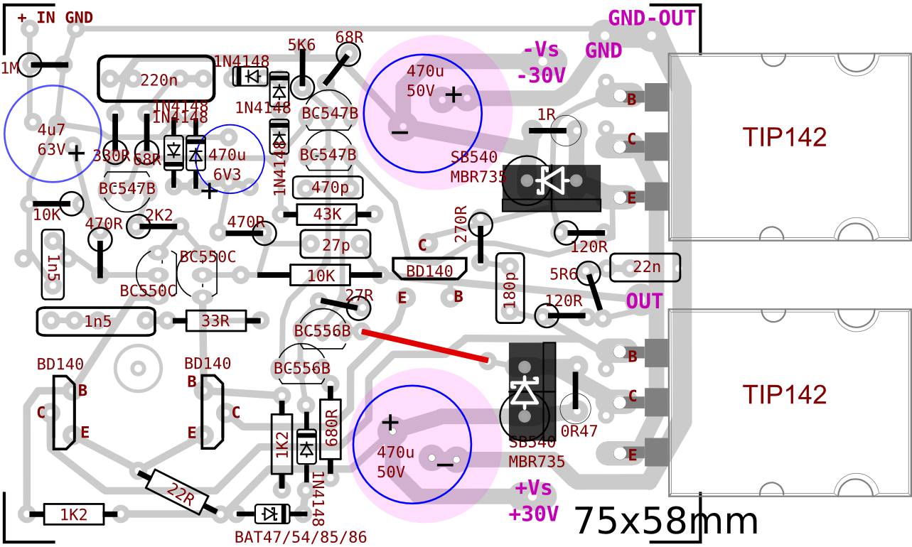

I consider that I finished my PCB layout of N-Darlington output version of vanilla Circlophone. I built two channels and they are running for a while. Purity, dynamics, punchy bass.. I think this version is no less than original output scheme. Even with those ST TIP142's. . . .I used BD140's as servo transistors because mine were good quality ones from Philips and Harris. I measured their cb capacitance at 0V and Harris ones were always lower (35pf vs 52pf).
Terranigma, I need some help with the documentation for it.
Unobtainium parts reliance issues: So, not a random BD140, but rather a little "super driver" sort with fine specs. Neither the Harris nor the Philips are widely available. I wonder what we can find for substitute at Mouser, Digikey, etc. . . Perhaps Fairchild has something for us? We need to list something with higher availability, for the documentation.
Other than the unobtanium vas, this version looks fantastic because it is the easiest and most compact way to build a Circlophone.
Given the 30+30vdc (60v) operating voltage and unregulated power (surges happen) we might need to list something other than BC556B (maxed at 60V) in the sensor area.
So, basically, we need an updated photo that lists alternate transistors for vas and sensor, in order to assure expected operation on all builds.

I also tested 2SA1220 (Nec), 2N5401, 2N2905A in place of BD's during tracing overshoot behavior. Actually I couldn't manage any difference between their behavior with oscilloscope. I showed BD140 part on layout because I consider that builder is aware of NOT to choose a random BD device. If I could find a 2sa1360 (2.5pf Cob) from a local store maybe it is going to be shown in the layout. It would be a good candidate for higher supply voltage usage. It is very easy to adapt mounting holes for 8-10pf capacitors between c-b legs of servo transistors in current layout. Maybe these self compensation caps aren't going to be necessary. I can't be sure until test it on real circuit.
KSA922, 2SA970, 2N5401 (and their couples) are suitable for sensors in higher supply voltage usage and they are easily attainable. Transistor leg arrangement must have considered in this case.

I consider it must be applied as shown in Elvee's jfet buffered schematic at post #637 (but using a PNP device?) If so, it is possible to alter zeners with a single transistor without altering layout. Not an artistic way but it is doable at least.

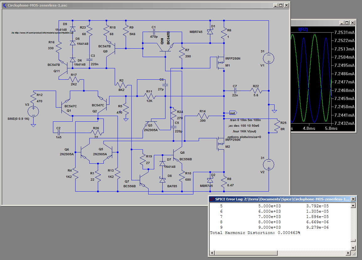

Circlophone with mosfets + CCS + DCoffset
R21 CCS? Yes sir. The following 3 options are made by Elvee, to fit standard Circlophone.
From left to right: Resistor option, simple CCS, advanced CCS
This is what I had integrated in my version of Circlophone (in simulation only).
It is a combinatio n of a lot of the suggestions made by Elvee, and a few deviations of his advice.
It is bit of a special version because it is to drive an electrostatic speaker through a step-up transformer. In the end his proposal to put a elco between the output and the trafo solved the saturation problem of the transformer but was (in simulation) a cause of distortion.
His alternative to create a DC offset circuit takes care of this.
This version is with MOSFET's as output device. The model is slightly adapted following some guidelines of Bob Cordell for the transition regio.
Some other smalle modifications were integrated to keep everything under control. The only thing that I cannot solve (don't know if it is a problem) is with squarewave exitation of higher inputvoltage and frequenty, there is still an offset.
I would like to ask Elvee to have a look at this version to see if this could be a viable solutions for a high power version. Since the MOSFET's seem to have a large SOA (520 Watt/200V) I hope it's possible to do withouth speaker protection (since there are no sensitive tweeters at the output).
I hope that the limitation of the output divices can be achieved by the limitation of the supply and transformer.
Supply voltage is limited to 38 Volts, iddle power in outputdevices is 31Watt.
(rather high, but I have 2 heathsinks of 0.34 °C/watt available). So total iddle dissipation is +/1 65Watt per channel.
I have noticed that the output voltage is not equaly formed by the 2 output FET's. So I'm wondering if it should be necessary to try to match the 2 MOSFETS ?
