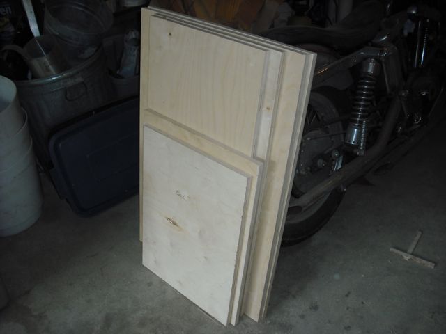

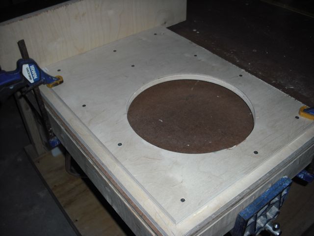

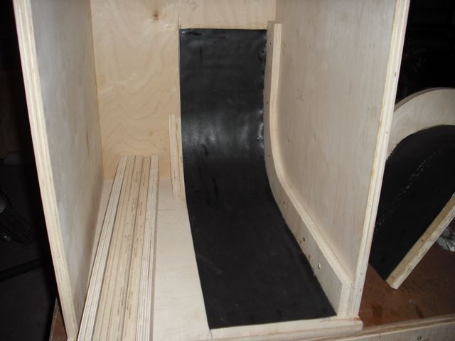

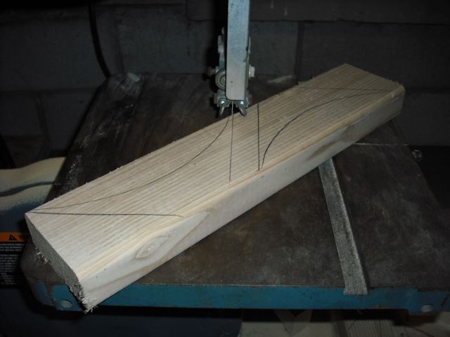

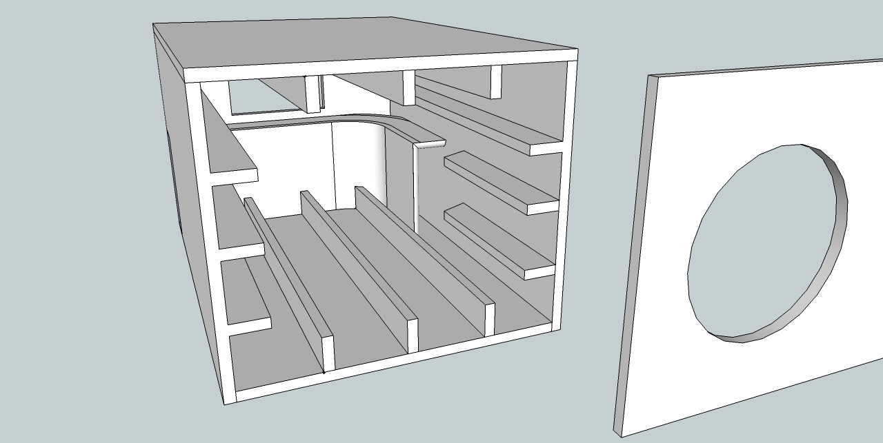

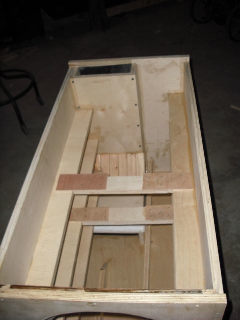

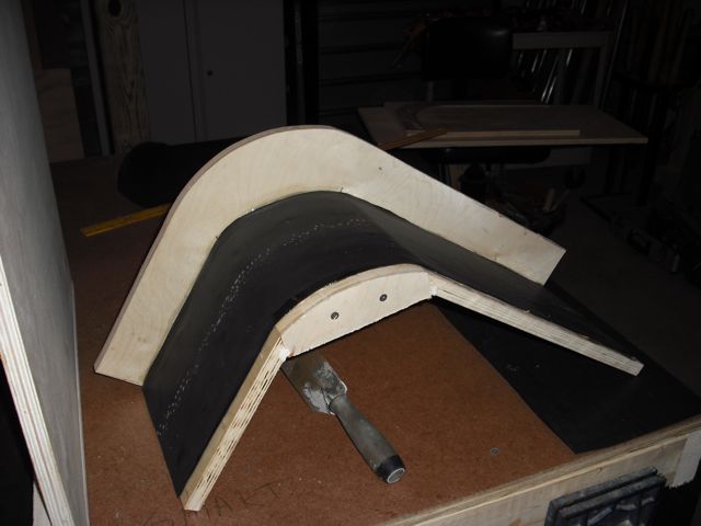

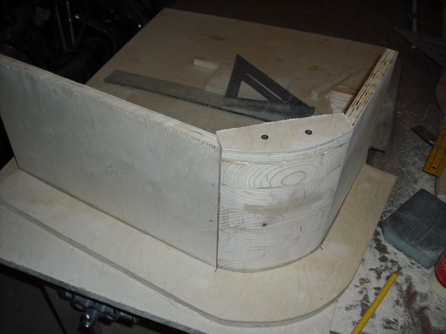

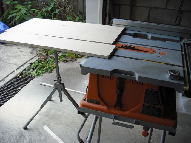

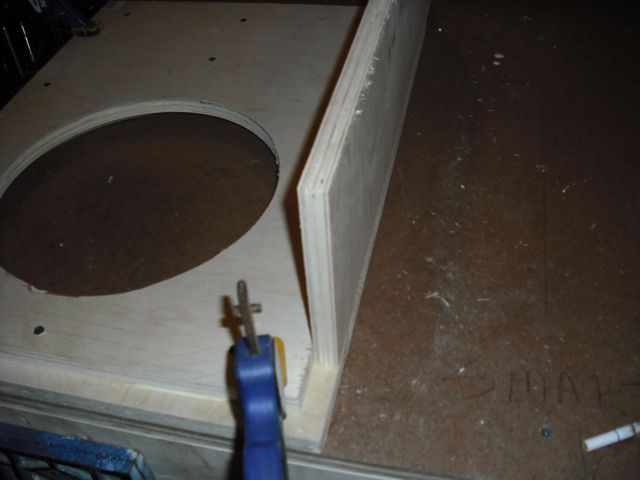

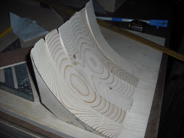

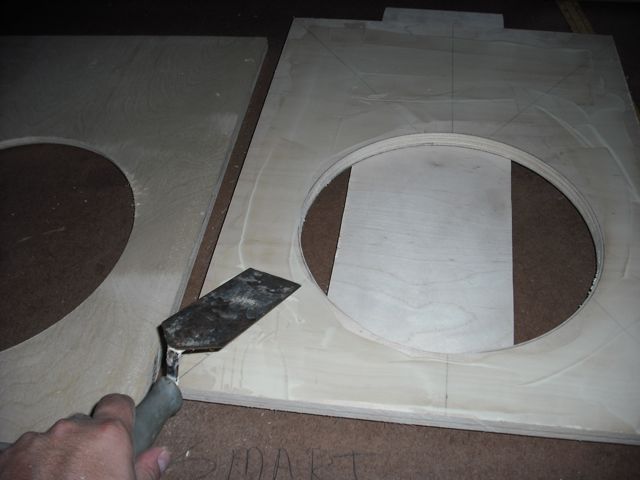

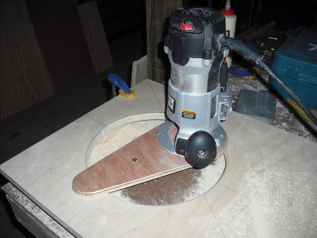

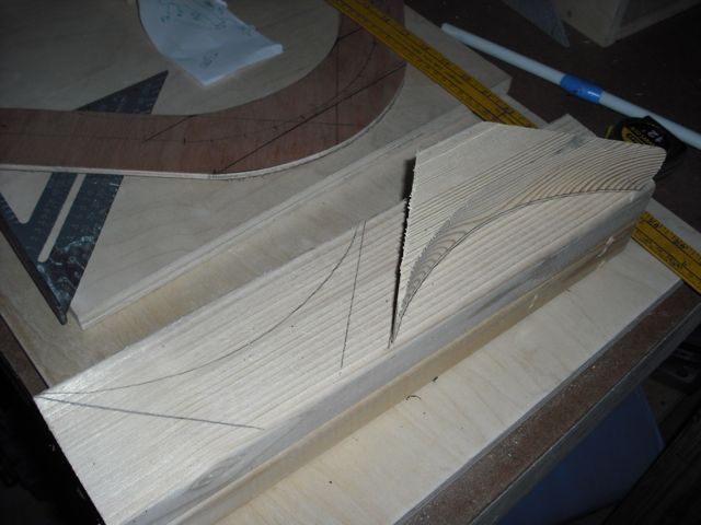

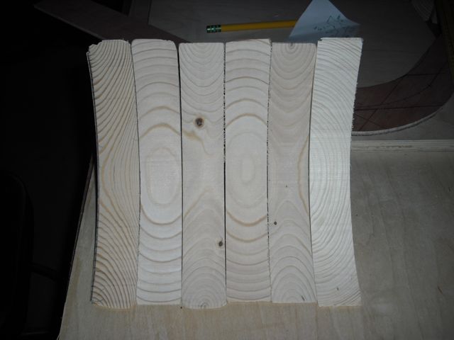

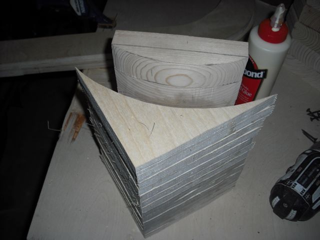

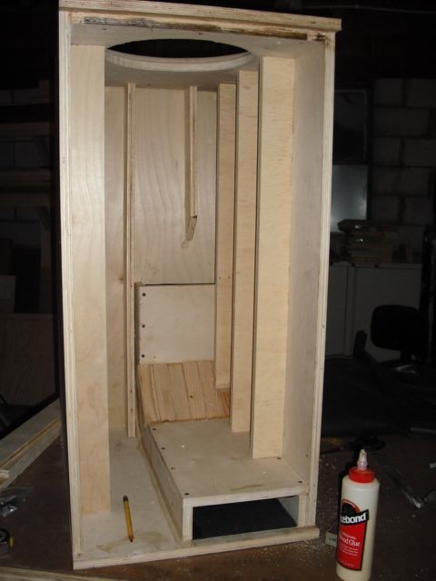

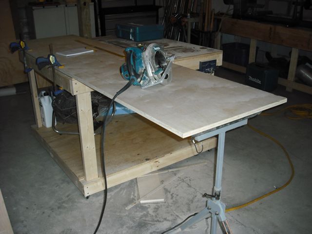

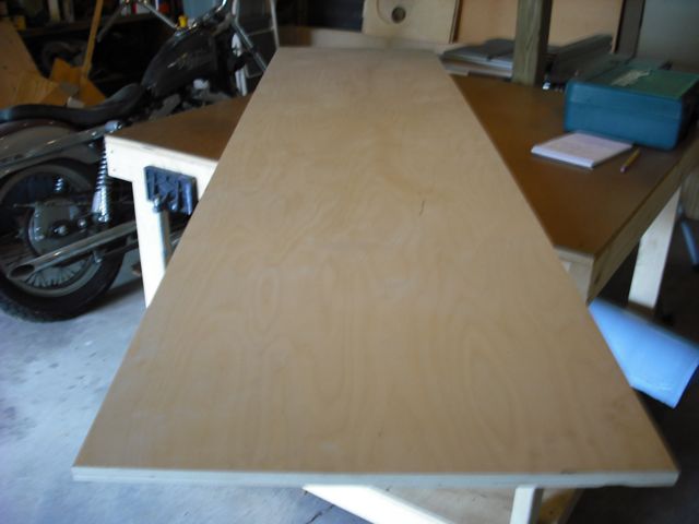

some pics from the sub i just built. It's in the testing phase right now so no paint or finish shots.

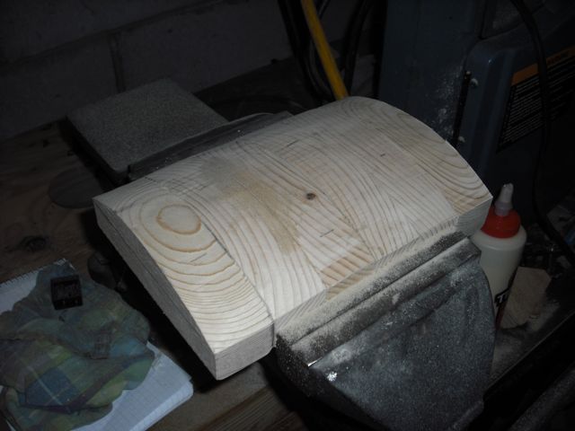

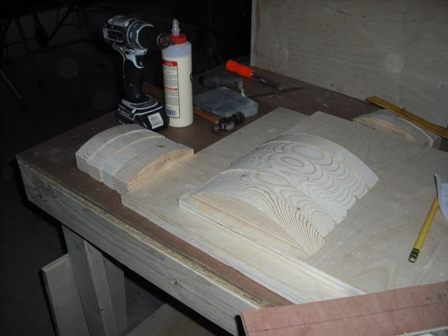

Oh yeah, you'll notice i didn't use the first set of bottom curve I made but since the process was the same i didn't bother with pics.

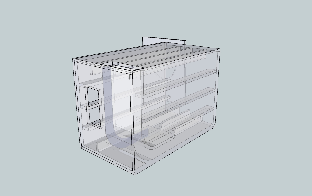

it's for a Dayton Audio RSS315HF-4 12" Reference HF Subwoofer 4 Ohm High Fidelity Reference Series in a 6ft^3 box tuned to 15Hz. after about two hours run in I took it for a spin, It is a beast. 12down is at ~12Hz 😀 and in room 2db down at 20Hz, at 105db/25Hz the port makes no extraneous noise, nada.

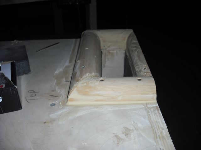

Camaudio, Yes it's birch. the inside of the port is lined with 4mm rubber (pond liner)
Neodan, no, it took 1.5 sheets

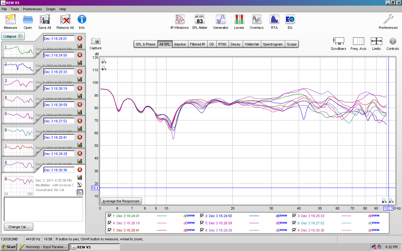

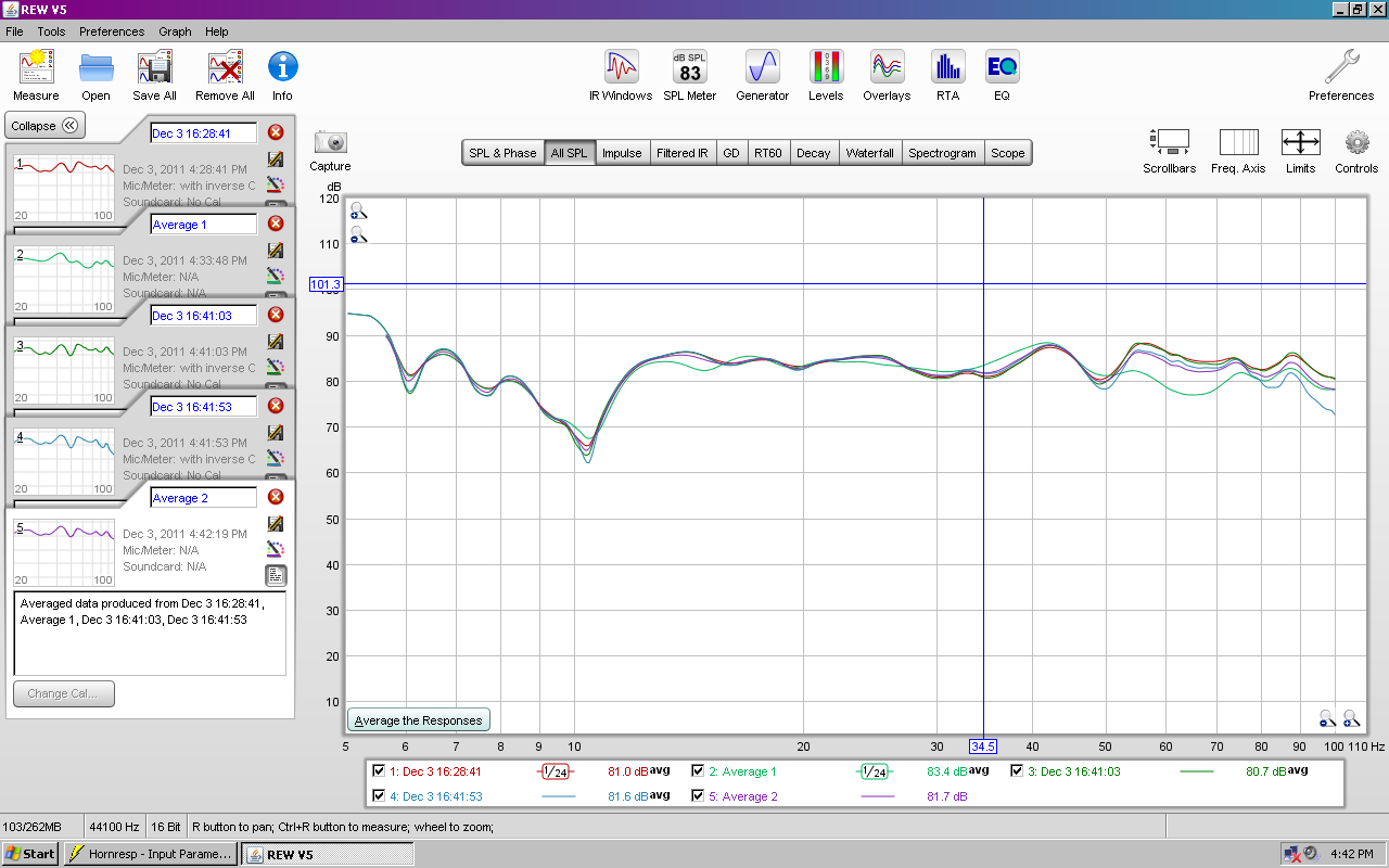

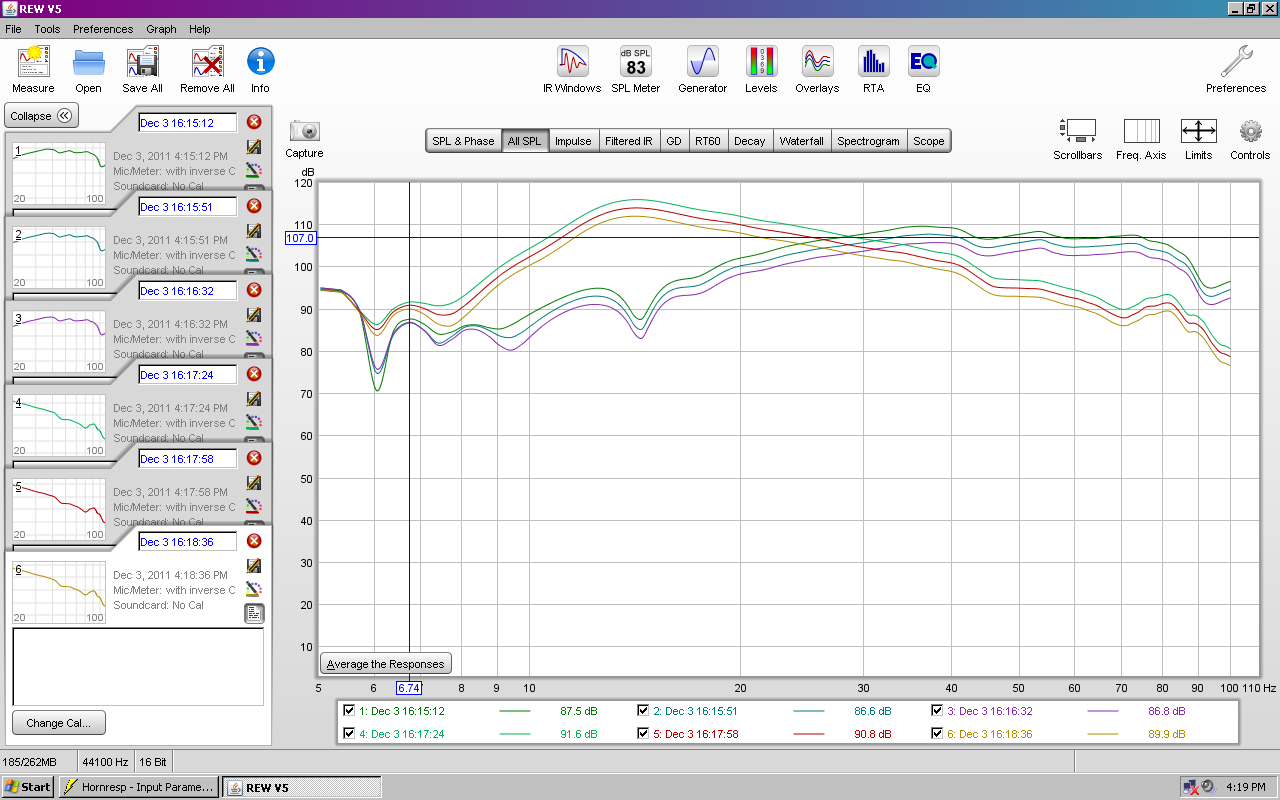

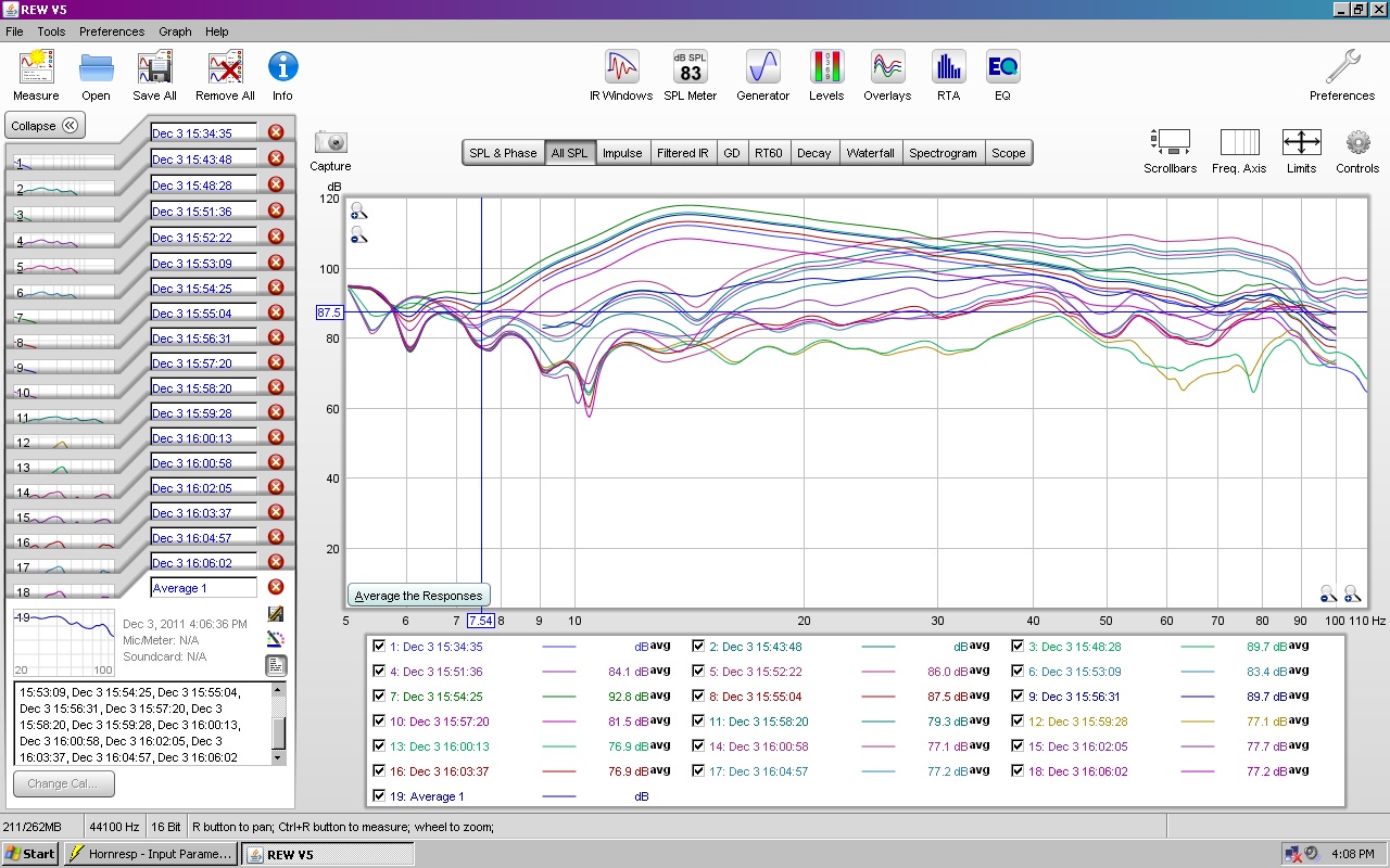

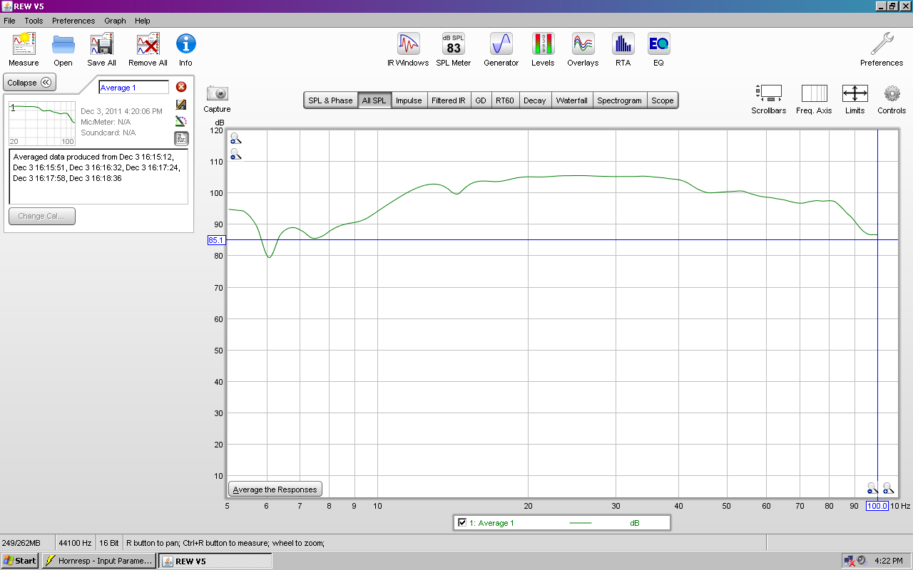

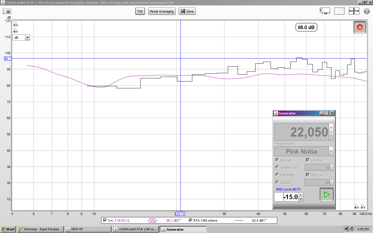

Here's the in room. I'll take it outside tomorrow. 😛
the wife is home I had to keep it down 😀
edit: the graph with the two separate plots are near-field (6") in 2db increments.
