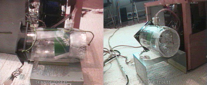

Hi!
I saw that inline design and just had to try it out with my double ended 150w metal halide 🙂
I made a test version out of a pepsi bottle and a sprite bottle 😀
The reflector is that parabolicis neck of a pepsi bottle (wrapped the inside with aluminium foil), I used the neck of the sprite bottle to support the pepsiflector and shoved the whole thing in a plastic pipe sawed of the pepsi bottle. I attached image of it to this post.
I'll attach image of the system lighted up on the next post and tell more about the results 🙂
HB

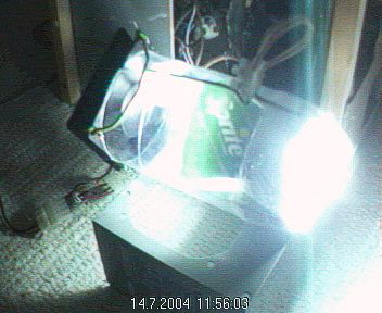

Here it is lighted up. I got pretty nice light cone out of the thing, and weirdest thing was that the cooling worked so well that the plastic didnt melt or smoke or anything. When I shut it down after 45 minutes test run, and let it cool down for about a minute, I tested the "pepsiflector" with my finger and it was totally cool and in the original shape :\
When the thing was on, I tried to hold my hand in front of it at about distance of 15-20cm and couldn't hold my hand there longer then about 10-20 seconds...
HB
