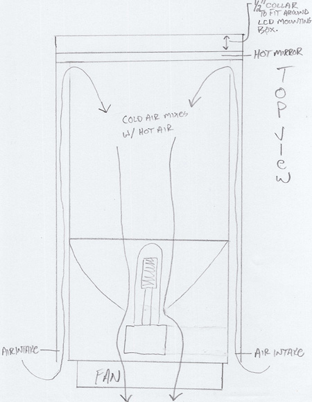

I have decided to go with an inline projector design. It will work best in my particular location. For blocking the heat I am going to use a hot mirror inside my light engine to reflect the ir back toward the bulb. This heat will be pulled out from around the gap between the bulb and reflector. I will attach a rough draft of the light engine design. If you are running three fans without any heat blocking material, I think that this design will work. Please let me know what you think, thanks.
This is a bright idea,i know hot mirror let the light pass trew it and reflect the heat but i never try this way.
Most of the time mirror are use at a 45 degre angle.But your idea
should work.
I tried to block heat with ir filter but it is not effective at all and i removed it.
If you have a hot mirror big enough(very expensive) try it and let us know.
