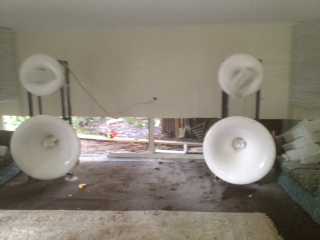

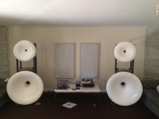

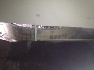

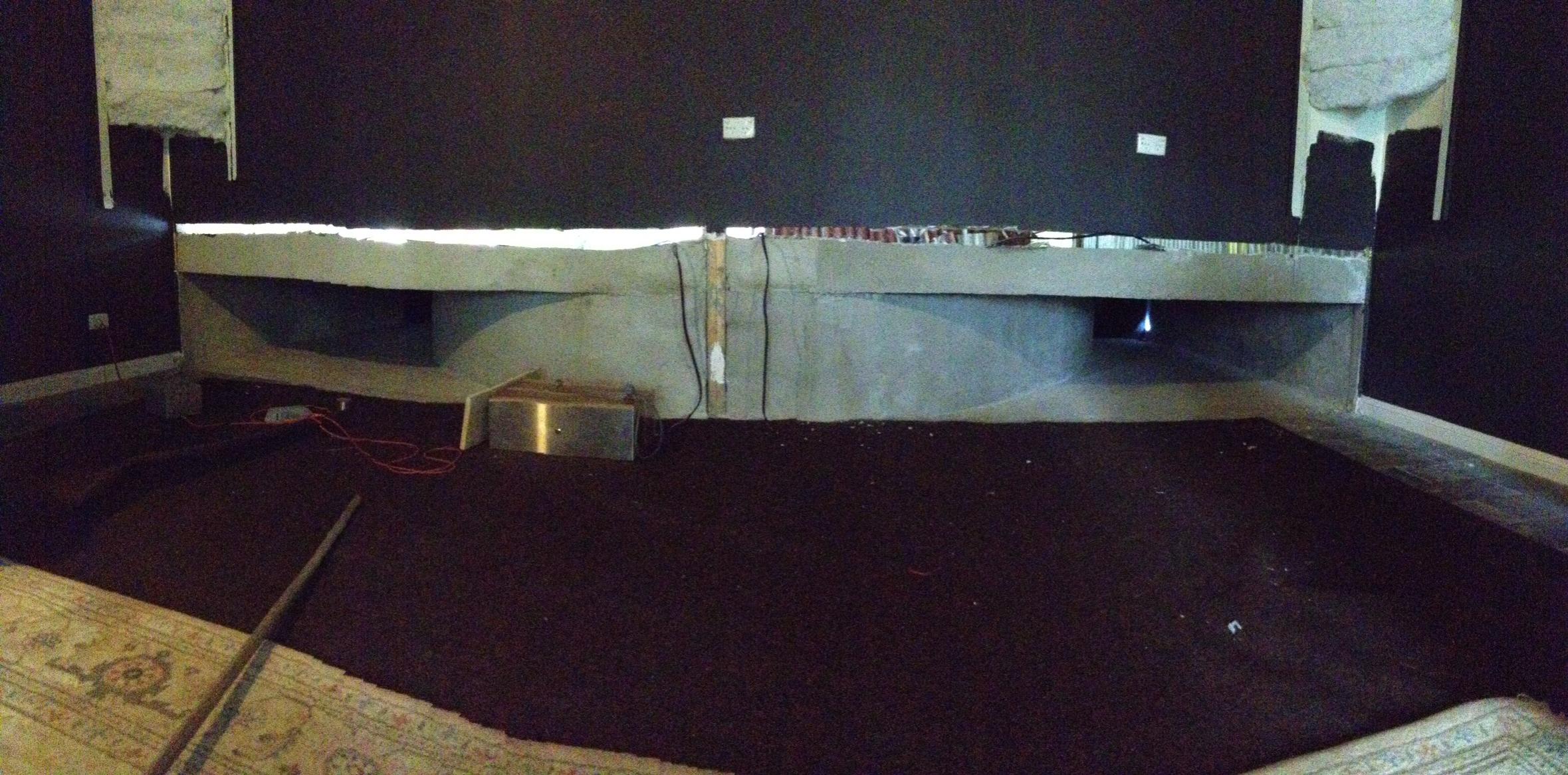

…….and here it is. Beginning to take shape
First picture is before the bass horn construction.
