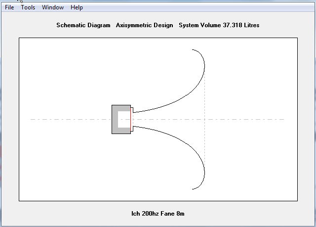

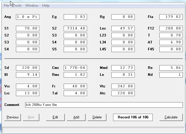

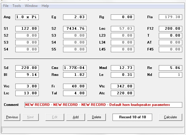

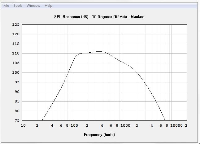

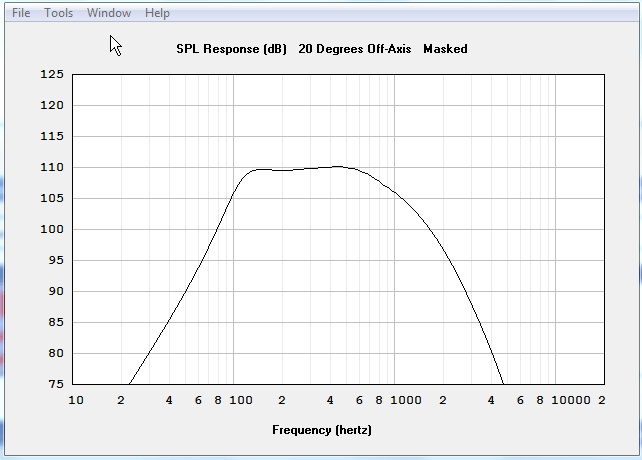

I am struggling to get motivated to build 1 metre horns. The horns.pl horns look good. There is a 200hz Le Cleach (the JMLC200) with a T value of 0. It has an opening of 125mm (122cm2) so it won't quite get the compression of an 80 or 100cm2 opening.
It would be quite simple to build a compression chamber for the Fane driver to sit in.
I don't have hornresp on my mac so I can sim the driver/horn combo.
An thoughts on this latest idea?
