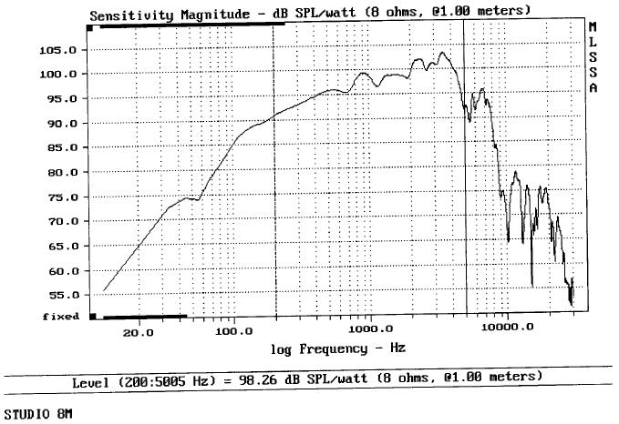

Would you mind sharing the frequency response measurement? The good HF response probably is due to direct radiation. Maybe the shape of the dome/dustcap?
I don't have the frequency plot anymore, lost on old dead computer. The good HF was a combination of driver parameters and the narrowing directivity of the tractrix horn. On axis it was good to 5KHz. Off axis it would start to fall at around 2KHz.
Rgs, JLH

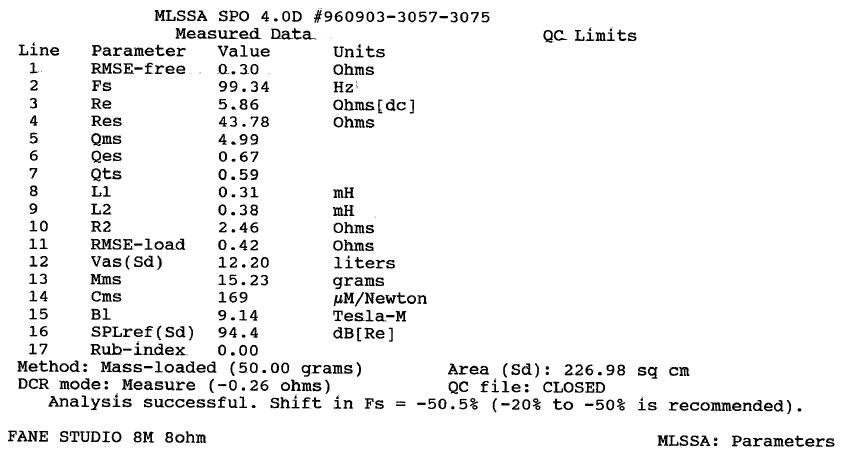

I was looking for a Word document on my various different USB flash drives and ended up finding these two bits of information on the Fane Studio 8M. The T/S parameters given by Fane are more different than I remember them being. I should stress the point this is only a single data point and there could be some variability from sample to sample. The graph pretty much explains why the 8M is good up to around 5KHz on a tractrix horn. Its high frequency efficiency continues to climb all the way to 3.5KHz. No other woofer I know of does this. The peak sensitivity is 103dB 1W/1M and with the narrowing directivity of the tractrix we end up at about 109dB horn loaded. The lower frequencies experience horn gain and result in a fairly flat overall frequency response. I don’t have my measurements from them horn loaded, but remember it was within +/-2dB from 135Hz to 5KHz in a 142Hz tractrix with the rear chamber volume adjust for a resonance of 130Hz. That’s all the information I have for you guys.
Rgs, JLH

Excellent info JLH . I will run that data for comparison in the sims that I'm doing.
How close to a full mouth do you have on the 142Hz ? - I have a model of yours which I can refine . Do you find the 135Hz lower-end on this blends OK to the Tapped horn, as both have some phase/group delay issues in the overlap ?

It was a full size 142Hz tractrix - full size mouth. No problems with blending with tapped horn because of the very long wavelengths involved. 130Hz is over 8.5 feet long. Phase alignment was fine, no need to time align voice coils or use digital time delay.

WoW, those parameters are really different - but good !
I can see why you like it ( attached ) .
Goes a bit lower but with more ripple on my Hyperbolic (design). Probably the best set of parameters I've used for my requirements .
