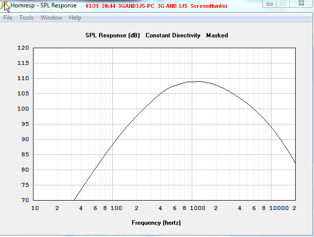

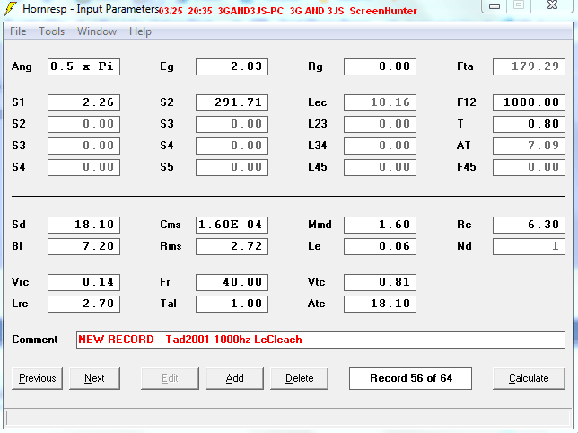

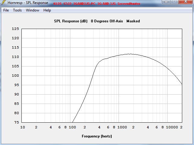

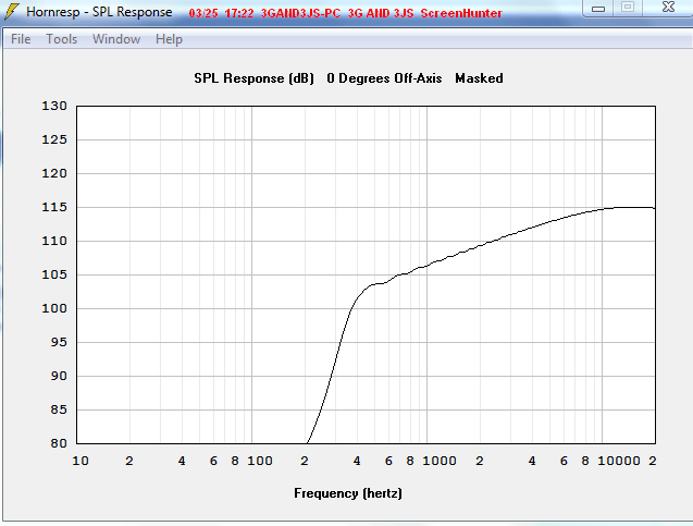

Do it again, something wrong with your 1000. Have done them and get other results more realistic results.

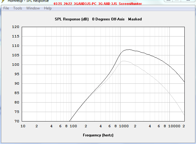

Also use "Compare previous" after you have done both "Beamwidth".

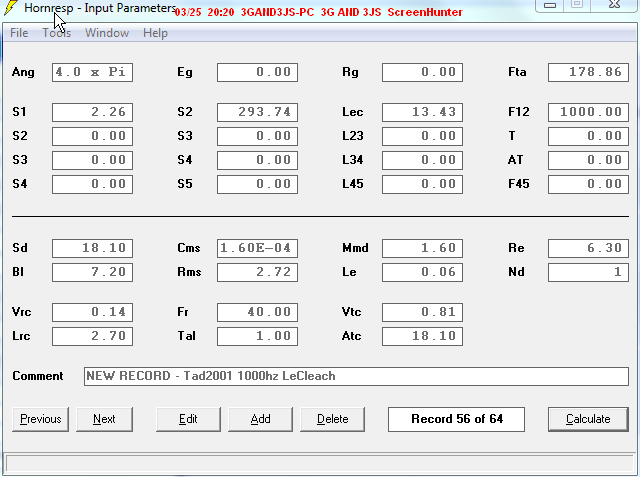

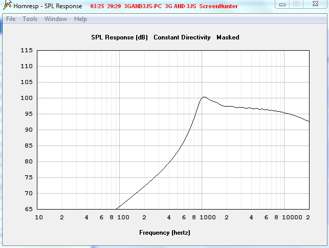

Still you forget to make T=0,8. Also for some reason Jean-Michel recommends 0,5*Pi.

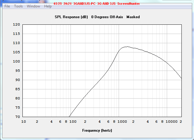

Also you should go "Bandwidth" when comparing.
Change to .5pi and T= 0.8.

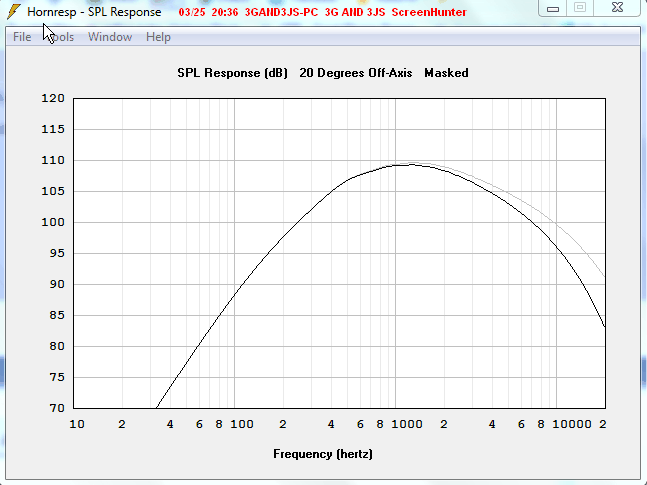

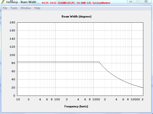

Looks ugly still this is 0 degrees off axis and 20 off

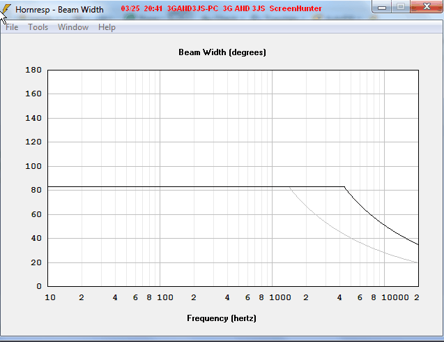

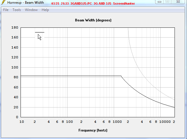

You shouldn´t mind the model probably isn´t 100% . Only compare the two in "Beamwidth" an on-axis . Quite a difference in "Beamwidth" don´t you think?
Here is the beamwidth for the 320hz horn and the 1000hz horn, then a combined one.
The 320 goes vertically up. Can you help me understand what I am seeing please?
The area at the front of driver should be something like 5cm2. But you have to go for the area just after the phase plug. When you build the horn you should off course go from the 5cm2 lengthwise.

As it has been often said by David McBean himself, the directivity behaviour provided by Hornresp is just a rough evaluation.
The reason is because the hypothesis of a flat piston source is considered. As David used to say a BEM simulation will give more consistent results.
When we use a TD2001 on an axisymetrical and when we compare the prediction from Hornresp with real measurements we can see that the frequency response on axis extends flat at very high frequencies (wharever the cut-off of the horn). Then when we study directivity we can see that the real mesurements shows less beaming at high frequency than predicted (this lead me to think that the wavefront at the output of the TD2001 comrpession driver is more like a spherical cap ( = a dome)..
