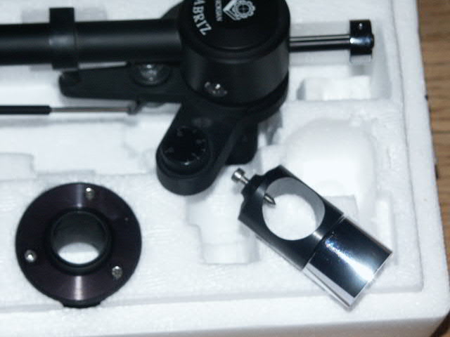

Chris, wicked LP 12...what have you done to the platter?
I'm in the process of converting my Valhalla to play 45s
Question what does the Roksan / Tabriz / Z1 etc counterweight look like. As this is an ad on item to the arm Im sure we could fabricate some kind of facsimile. To get the best we can from our 219s...ps is it stylish ?

Yes, the Zi type counter-weight would be easy, however I think that a counter-weight and "string" as I've done is more effective (maybe I'm suffering from "proud papa" syndrome ) and easier to implement (although it has no "bling" factor).
Aren't "found" objects great? I might be inclined to suggest an acrylic or a metal housing to mount the motor. Wood is my favourite material, but unless made for the motor, I suspect anything hollow would resonate and add colorations to the sound.
If using found objects, be sure to fill any gaps with putty or something that can act as a dampening system.
Michael: The mass of the counter-weight is only increased by 2 or 3 grams at most.
Jay: Have you done listening test? PM me if you can...or post your comments in the thread. I'd like as much feedback as possible.
Any others: have you built one? If so please post your finding anf comments.
Thanks all.

The counterweight in the pic is very similar to one I made for my RB300 a loooong time ago.
Yes, the bamboo looks nice & yes they would have to filled with various materials in order to dampen them, ie Lead etc, but Stew if you recall the LS35/A is just a thin walled box till painted in bitumen & then bitumen panels stuck to that, to effectively dampen the wood....
Won't 'string' cause the weight to wobble ?
If so I might have a method of controlling that.....

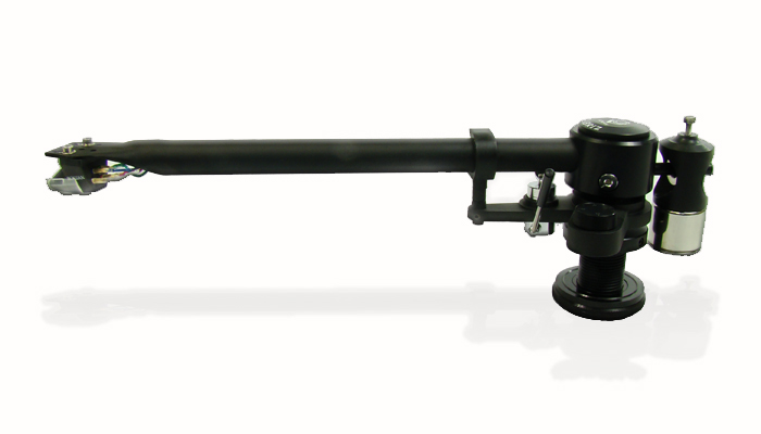

I will be working on a counterweight for the '219' in the next few days Hopefully stylish but not bling !

The new counterweight is in the process of being made. Its made from two sizes of copper tube 22mm & 15mm both cut & shaped & filled with an epoxy stone material. At the mo i'm sure its to light so I will be making some Lead slabs that I will insert into it by cutting the weight into sections.
So the Gross weight will be simple enough to get right, it's the minor adjustable part that needs more attention.....
