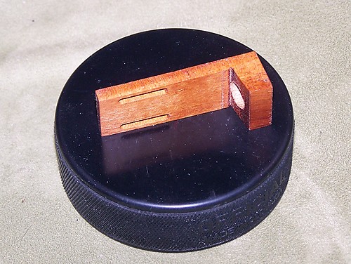

I prefer Yamamoto style wooden headshells,🙂

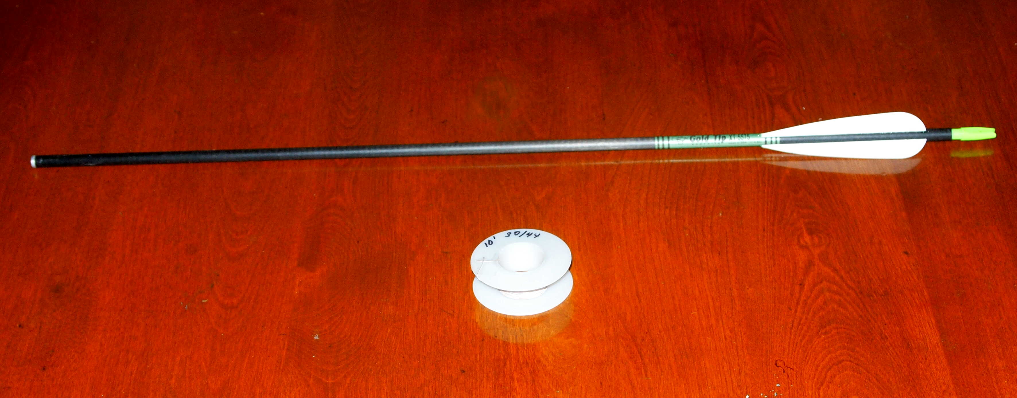

Hey Stew...I have a Carbon/Graphite Shaft that I'm thinking about, and 10' of 30/44 Litz Silk Wire...But, the HeadShell has me Stumped...Unless I Carve one out of Mountain Laurel or Cherry, which will take longer than Building the whole Arm...Do You have a Better Idea?

One XX75 cut in half, I intend making two Arms so sourcing different parts.
I will most likely cross brace the tubes with balsa wood & lacquer inside for extra stiffness ?
Have Litz silk copper wire.
Am thinking about twisting the 4 wires inside arm tube, & braiding from outside, (seems to me that braiding would be more supple than twisting where it matters most) with fifth wire soldered to arm tube for an earth....any comments ?
Also it occurs to me that the arm wire WILL vibrate inside the tube, If it touches the tube. So would it be prudent to loosely wrap or twist around the wire, with say some knitting wool. This would almost certainly remove any internal arm vibrations...?

Wood is easier for most of us kitchen constructor types (without good machining capabilities) to work with rather than any metal. I also like the idea of using wood as it has some natural dampening qualities.
Nope. The headshell stumped me too 🙂.
You could use a piece of hardwood dowel that fits inside the shaft. Flatten one side of it, and use a piece of aluminium plate or small piece of wood. Then make yourself a Schroder style headshell as used by Schue, Clearaudio and others.
