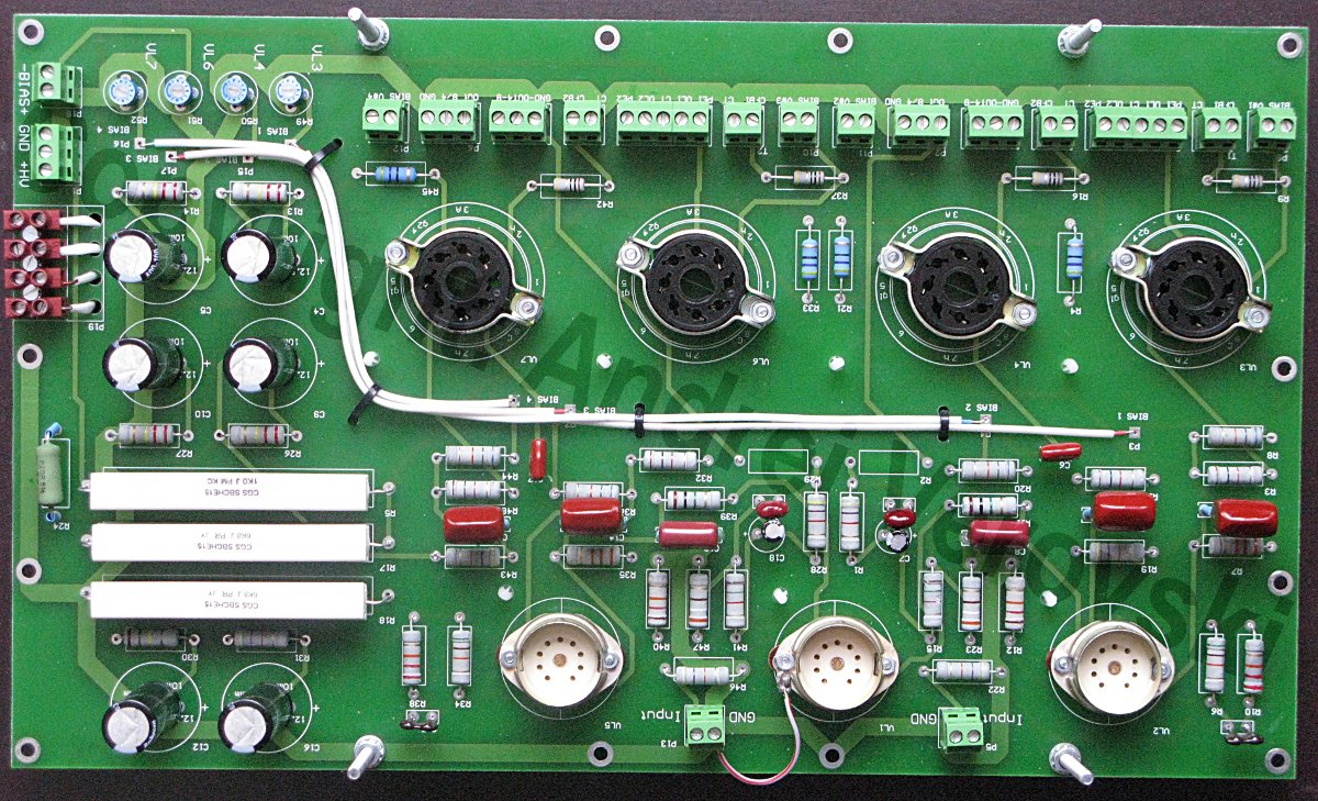

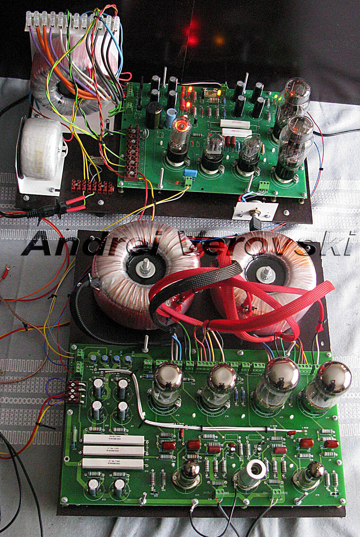

Finally I've made very nice Christmas and New Year gift for myself - a push-pull amplifier based on legendary Japanese masterpiece of 60th - Sansui AU-111. This is draft (beta) build, without chassis, preamplifier and other things currently under construction.
After quite long and time consuming debugging process amp works really well (in some areas exceeding original specification). 40W RMS per channel (with 6L6GC & 485V B+ voltage), 20Hz - 50KHz frequency response, +/-0.15dB within 20 Hz - 20KHz, 0.2% THD at 10W, 0.8% THD at 40W, 95 dB S/N ratio.
Amp is very stable, even with very long B+, BIAS, 2 pairs of filament cables thrown all across my table, uncut 35 sm transformer leads, there is no oscillation or RF noise pick up.

So, after all, I used output transformers of my own design, custom built on custom sized high-quality GOSS core, 5K primary with separate CFB (104 Ohm R(dc) plate-to-plate), 88H primary inductance at 1V/100Hz, 4/8 Ohm secondary, linear response for up to 100KHz (this is upper limit of my low output impedance generator, I don't have another one to test above 100KHz and don't think it is really necessary).
Despite contrary belief, these toroids can sustain 15mA imbalance of output tube idle current (60mA and 45mA respectively) without any drop at 20Hz/40W power (not even a single dB - seriously). Additionally, I run transformers with the most difficult load imaginable - 20Hz sine-wave (largest flux density B), 36W output RMS at 8 Ohm, 1 hour continuously (enough time to get heat distributed across entire volume of core and winding). Temperature raise of output transformer was only 7 degree C ! They become just barely noticeably warm. ALL vintage output transformer I had within the same time frame get very hot, 80 - 90 degree C or may be even higher, just with music playing at moderate volume.

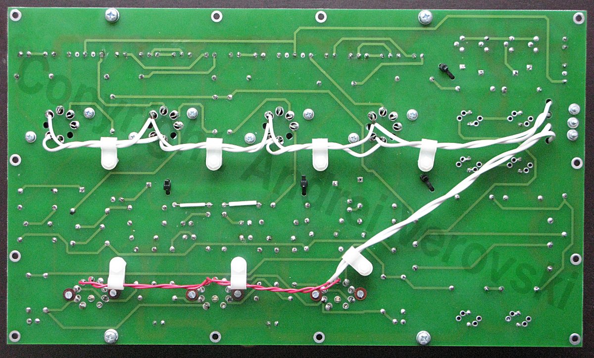

In final assembly I used double layer PCB, 2 mm thick, with double dielectric layer, and top silk-screening. I built both point to point and PCB units at first, and disbanded p2p as inferior in virtually every aspect (except cost of course, and cumbersome mounting process of tube sockets on PCB).
For debugging and bench testing I assembled stabilized regulated 360-490V/0.5A power supply (shown on the photo on top), with custom power toroid and 5H fixed air gap choke. 60s startup time delay is not working yet as expected but it is not critical at the moment.
Chassis is under construction, I hope to get it in January for acceptable cost price.
