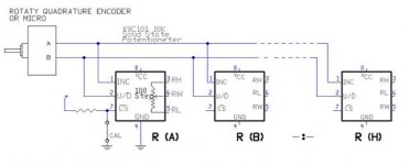

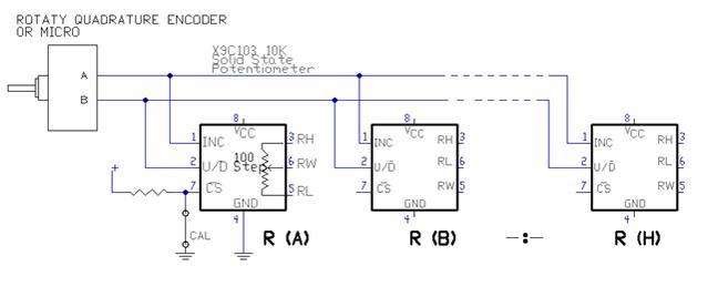

IC analog switches are a definite possibility, but I don't know how much degradation would be introduced. I would definitely replace the range switch with a relay arrangement. The frequency tuning switch might be able to be replaced with a four-gang, well tracking potentiometer arrangement. Depending on noise and distortion degradation, replacement of the frequency tuning switch by some kind of IC VCA's might be an option as well. Use of a PIC microcontroller is also a definite possibility.
Bob
This is a simplified schematic of the use of solid-state gang potentiometer.
Removing the CS, except one, you can perform the calibration potentiometers.
Bob, you write "four-gang potentiometer", but should not be eight resistors of S3 ?
Forgive me if I said something obvious or wrong, but I'm not very expert.
Regards
Giuliano

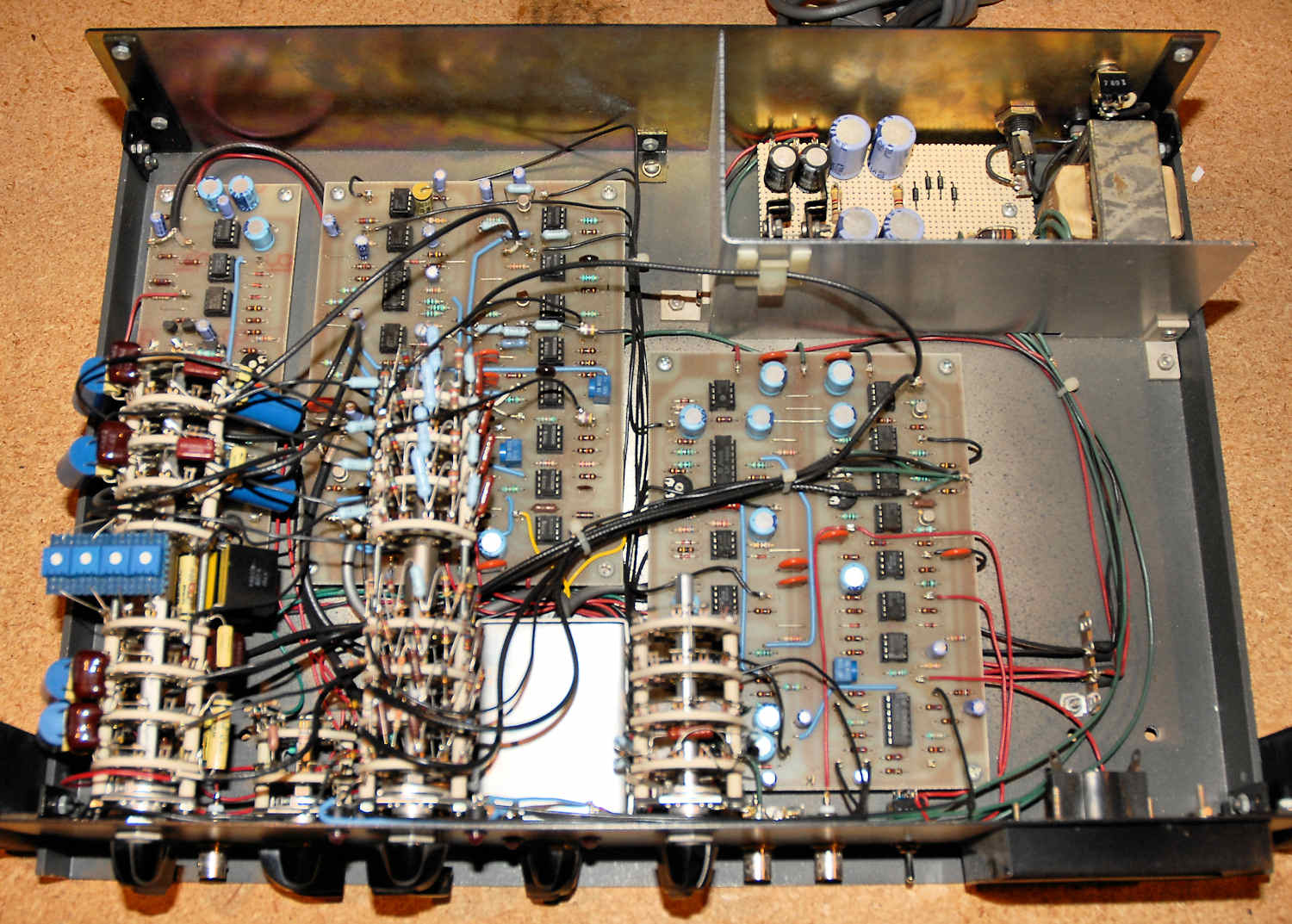

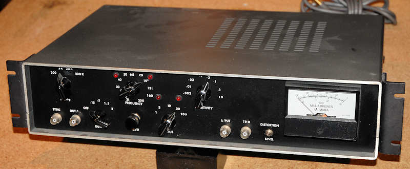

I started building my Cordell analyzer when the article came out. I didn't have many resources, parts or smarts, so it took me three years to finish it. After all this time some of the front panel lettering has worn off, but I still use it often in spite of having other analyzers available. The noise floor and residual beats 'em all. Here's a couple photo links-
http://www.conradhoffman.com/BC_thd_face.jpg
http://www.conradhoffman.com/BC_thd_internal.jpg

Very good, really well built it!
Giuliano
