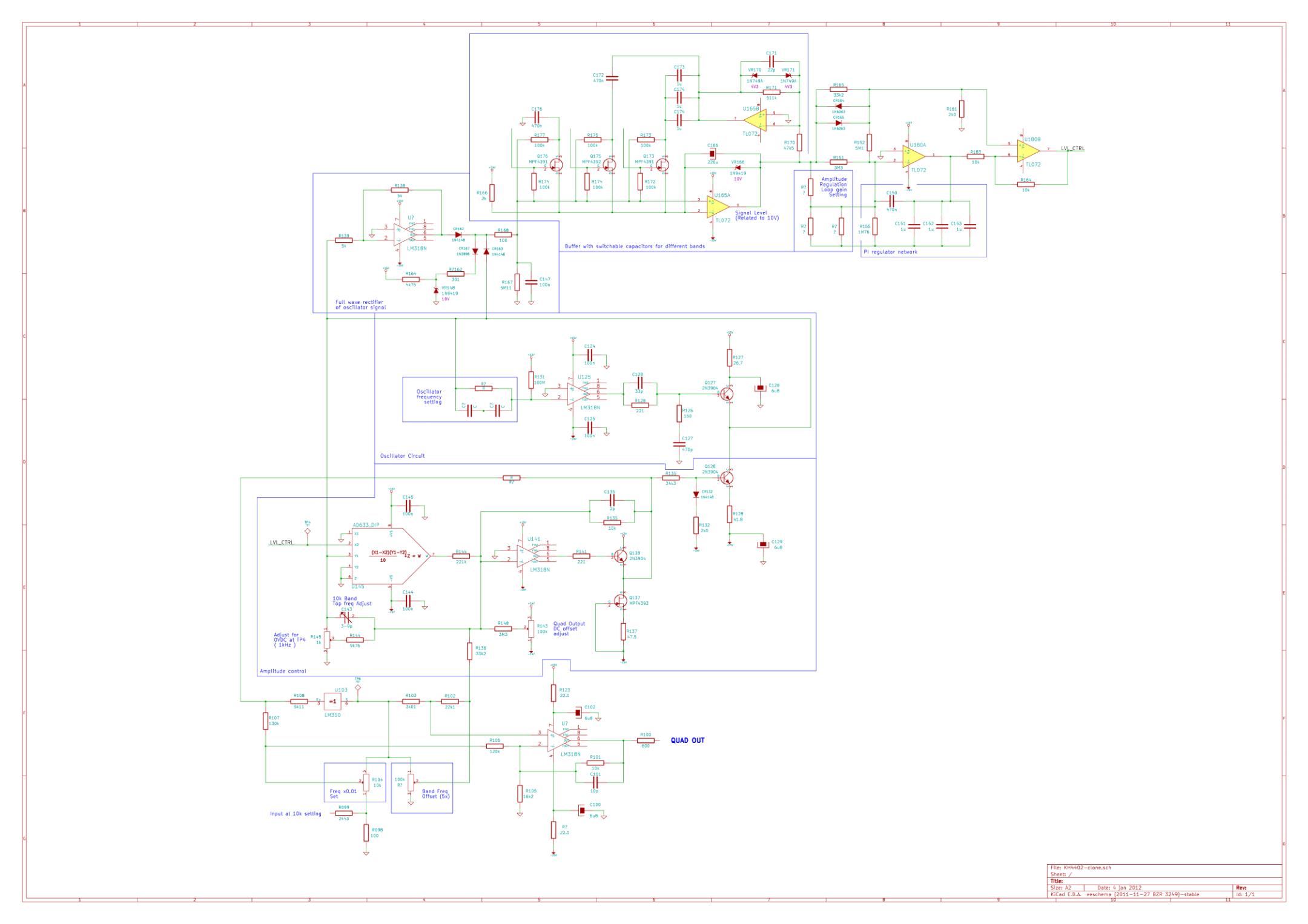

Let's start with a Krohn-Hite 4402 and improve the (noise + distortion) by 20 dB or so. Proposed design requirements & desired goals:
- Signal frequency range: 10 Hz to 100 KHz minimum (200 KHz goal)
- Output level: 5.0 V (RMS) /+16 dBm into 600 ohm load
- Total corruption (harmonics, noise, hum, ripple, etc - measurement bandwidth greater of 30 KHz or 10 times signal frequency - output level 2.5 V (RMS) into 600 ohms):

There are a few interesting things that can be found in this schematic- It uses the LM318 with a discrete bipolar output stage
- The oscillator level is 10V, 20Vpp
- It uses the AD633 as part of the gain control
- The actual gain control element is the bias current of bipolar output stage
- It uses a signal from the resonance element as feedback to the gain control element
The schematic was not that easy to figure out, I had to redraw the circuit.
Your nicely done schematics is almost impossible to read in jpg.
Could you perhaps try another format like pdf ?
Or may I get a copy via email ?
Thx,
Patrick

It's drawn in kicad. It had a few export alternatives, I choose the SVG format. I have now exported it in PS and converted it to pdf, as the request.
View attachment KH4402-clone.pdf
The schematic is not the complete 4402,
- The power supply is missing
- The output stage is missing
- All switching circuitry is replaced with a general R or C
I will probablay have missed some more things, comments are welcome.

Minor schematic correction
When I was looking at the schematic, was one of the most important wires missing. I am sorry that I hadn't checked that earlier.
It was the tap from the RC-resonator generating the oscillation.

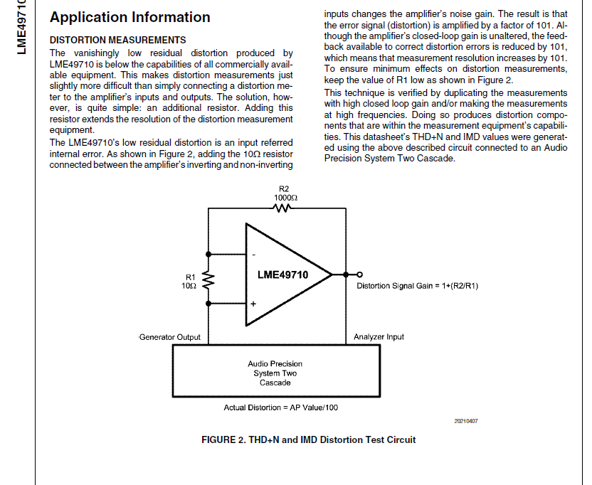

National presented a method in the application section of the LM49710 data sheet where the DUT is used to amplifier it's own distortion.
That measurement method is old news--used extensively by Walt Jung and myself (see www.diyaudio.com/forums/solid-state/129202-amazing-opamp-measurement-shoot-out.html).
