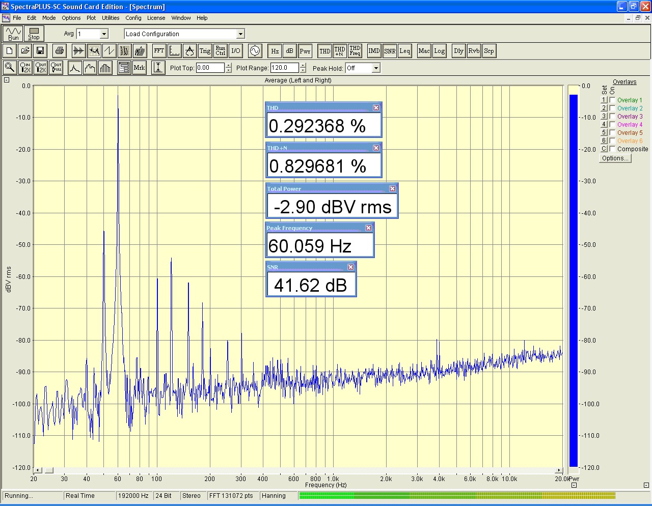

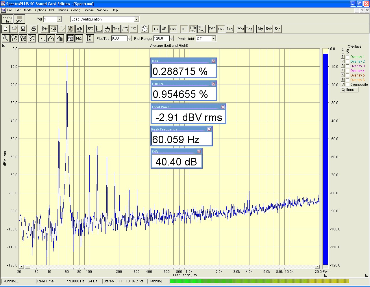

some measurements
Attached some measurements at 60 Hz -30dB. I have repeated @ 100Hz.
The polarized one refers to the back-to-back capacitors which have been shorted, so each results in one polarized capacitor with double the capacity.
The NP one refers to my three couples of back-to-back capacitors without been shorted: the bypass one, the ultrapath one and the power supply decoupling one.
(Giving the generous size of the 3 caps, there is no difference at 60Hz for the fact that the two tests compare a double capacitance in the circuit.)
I cannot see any important difference, even if I'm just using my PC soundcard and not professional tools.
That means two important things for me: first that the good sonic performance of NP caps is not justified by any measurement yet.🙁
But most important (as many folks believed the contrary): the reverse biased capacitors, which should act as a diode, do not produce any visible harmonic distortion increment! And, this is at least very good for me!🙂

Nice thread, I've had an interest in NP caps for awhile since using them in the signal path for a couple of amps - as input capacitors. The sonic results from these amplifiers were very good from my subjective evaluation but I didn't do much in the way of comparisons I trusted the fact that large value caps generate vanishingly small a.c. voltages across them for small signals so distortion will be low and therefore preferred a largish value NP cap to either a small value non-electro or a large physical film cap for all the hassles that the size of those things bring to the table. I haven't tried NP's in the power supply - something I might add on my to-do list for my next project.
Of course, it's not unusual to have some interesting sonic changes that are difficult to measure and as hobbyists we often don't have the equipment to do the job adequately. Nevertheless, I have found simple listening tests to be invaluable for comparing different parts and topologies in my own experiments. All in all it has been a very rewarding part of the hobby and I like to read about the experiences of others like yourself.
