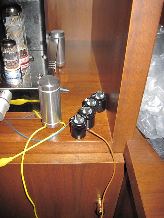

- the size of the input choke appears too low for proper choke input. Was it sized based on listening? Or is the purpose not being a choke input supply, but just some hf filtering before the input cap?
- why hybrid rectification?
Not too long ago i spent a day listening to the effects of the first cap in a choke input supply. Much to my surprise did not like any of the films compared to good electrolytics.
EDIT: Looked at the pics and it appears the tiny choke is something recycled from a smps and it is indeed not a choke input supply

I have cannibalized the tiny input choke from an ATX power supply and I have replaced the original component in the chinese schematic which was a series 10 ohm resistor: I saved in this way few DC Volts plus got the benefit of adding an RF filter.
Be aware that GZ34 can withstand till 60uF filter capacitor, but 5V4 can withstand 32uF only. So you cannot increase the value of the first capacitor, but you can play with the second one after the bigger main choke.

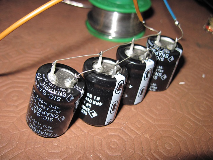

The "bipolar" back-to-back electrolytic capacitors that the OP has introduced seem to serve no legitimate purpose, since in each location the voltage on the top end is always strictly positive with respect to the voltage on the bottom end. In each location, what is really needed is an "ideal" capacitor that acts as near as possible to a dead short at audio frequencies. It is hard to see why introducing a back-to-front capacitor in series would further this goal. If there really is an "audible improvement" when the back-to-front capacitor is installed, then maybe this suggests that some resultant degradation of the smoothing is producing a "sound effect" that is pleasing to the listener's ears. As has been emphasised previously, it is also important to be sure one is comparing like with like; namely, that the effect of the "bipolar" capacitor is being compared against the effect of a normal polarised electrolytic of the same capacitance as the bipolar one.

WHAT AC signal? This filter is after the rectifier, so you should have nothing but positive going pulses.
To do science, did you try installing a plain old polar cap in the same position of similar value? In other words your difference might be the increased capacitance, not the bipolarness.

Proper observations the yours, as I had just compared Non-Polar vs No Cap: so I finally compared a bank of polars equal to 272uF/400V against the back-to-back 235uF/400V: the change of capacitors really does have an audible effect which I can translate as a minor listening fatigue, as stated before.
Thanks guys, now I'm firmly convinced that is not a placebo effect!
Why? You are pulling this out of the blue with no justification at all.The additional back-to-back NP big size capacitor acts as favourite path of AC signal.
The only "favourite path" will be the one with the least AC impedance, basically capacitance based impedance plus ESR .
By the way, never measured it, but I guess ESR in a reverse polarized capacitor shouldn't exactly be good, you are using it the opposite way it was intended to.
Now if all your justification is "reduced listener fatigue" or similar mumbo jumbo, please be free to also file it in the large Placebo Effect drawer.
If you want to get a better "favourite path" , do it the right way: start by pulling that reverse biased useless/annoying capacitor from the power supply and continue by wiring it back, but in parallel with the other one, and with proper polarity.

That are my listening tests I've done so far:
1) without my "useless/annoying" NP capacitor
2) installing my "useless/annoying" NP capacitor, shorting the bottom cap, so practically adding a 470uF/400V polar cap to power supply
3) installing my "useless/annoying" NP capacitor
4) installing my "useless/annoying" NP capacitor with a security diode on the bottom cap
5) disassemble my "useless/annoying" NP capacitor and install the two caps in the correct polarity, so practically adding a 940uF/400V polar cap to power supply
6) get rid of my "useless/annoying" NP capacitor, and install a polar capacitor bank with capacitance nearly equal to the NP capacitor, i.e. 235uF/400V
I repeated the tests twice.
It is not a placebo effect if I really found solution 3) the very best for my ears which brings the musical performance back to life.
