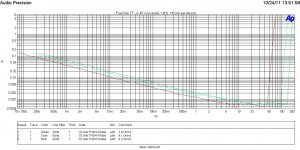

Before I execute systematic test. I briefly test the first assembled unit. No pre-driver is employed in this unit. Four NJL3281D/1302D pairs are used. The driver is MJE15030/15031. LME49811 is assembled in the driver board.
Four TT diodes together with a 500R trim pot are used to generate bias. The power supply is +/- 40 V no load (330VA transformer). The initial result is very promising.

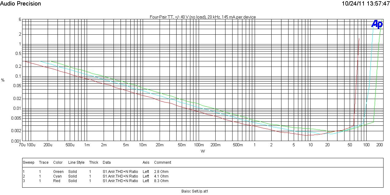

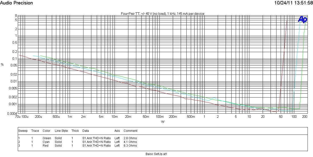

THD vs power for 1kHz and 20 kHz for 8.3, 4.1 and 2.8 Ohms are illustrated in the figure.
Great stuff Panson. i thought everyone had forgotten about these little drivers.
I am doing a similar 4 diode bias, on bread board so far, but mixing 2 thermal track and 3 standard parts in the same output array (5 pairs). Saves on realestate and seems to work but not sure if I will need to do any matching. Look forward more of your magic measurements.

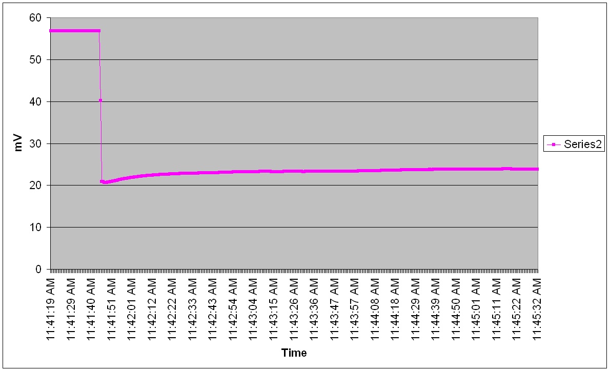

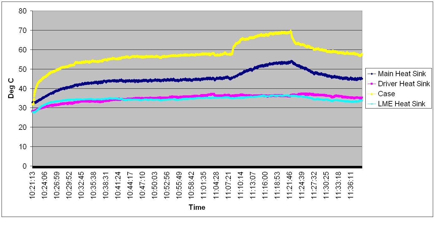

Here are measured data for thermal tracking. One of the Re voltage drop was measured together with main heat sink, driver heat sink, TT case and LME heat sink temperatures. The ambient temperature was about 25 C.
The test unit used four-pair TT where four of the diodes were used for biase/thermal tracking.
The test unit was in idle mode for an hour. The main heat sink/case temperature moved from 30 C to 45.4 C/57.7 C. The bias tracked the temperature variation pretty well as shown by the Re drop plot.
The test unit then delivered 47 W into 2.8 Ohms for about 40 min. When the signal was removed, the bias was lower than the target point 24 mA/Re (Re = 0.22 | 0.22). It then gradually moved up. Hence, it is a slightly overcompensated tracking system (good to have).

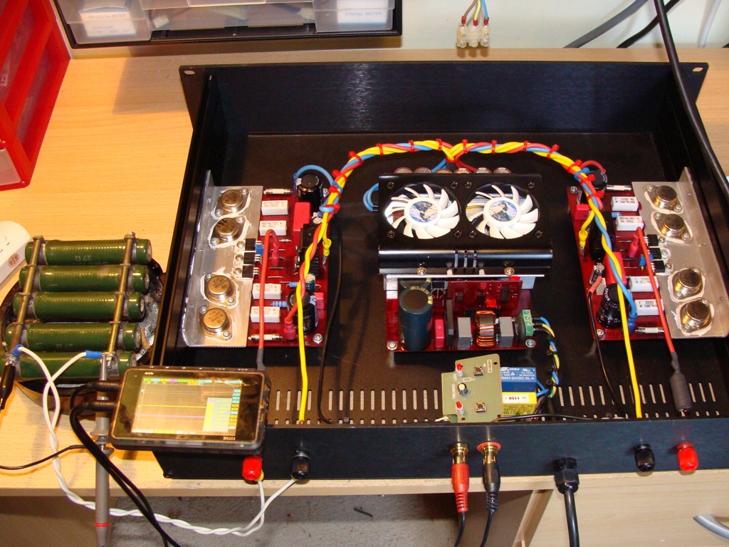

LME49810
This is a my diy amplifier based on LME49810 high fidelity power amplifier driver. I used a discrete output stage with MJE15032/3 and two pairs MJ15003/4.
The schematic used you can find in driver's PDF. I designed my own layout with separate signal GND of power GND.
The power source is a full-bridge power converter based on ETD49 core.
Pulse modulator control circuit is provided by SG3525 and NCP5181 are power mosfet driver. Without power factor corection.
Soft start is realized by the SG pin 8 capacitor.
Switching power is made with a remote control socket. I transfered the socket's pcb in my enclosure.

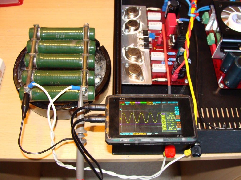

The ampl was tested with a dummy load ( five resistors 27 ohms/100W connected in paralel mod).
Unfortunately, my DS203 signal generator can't give a output signal more then 1Vrms.
The sound is great.
Best regards,
Mircea Crisan.

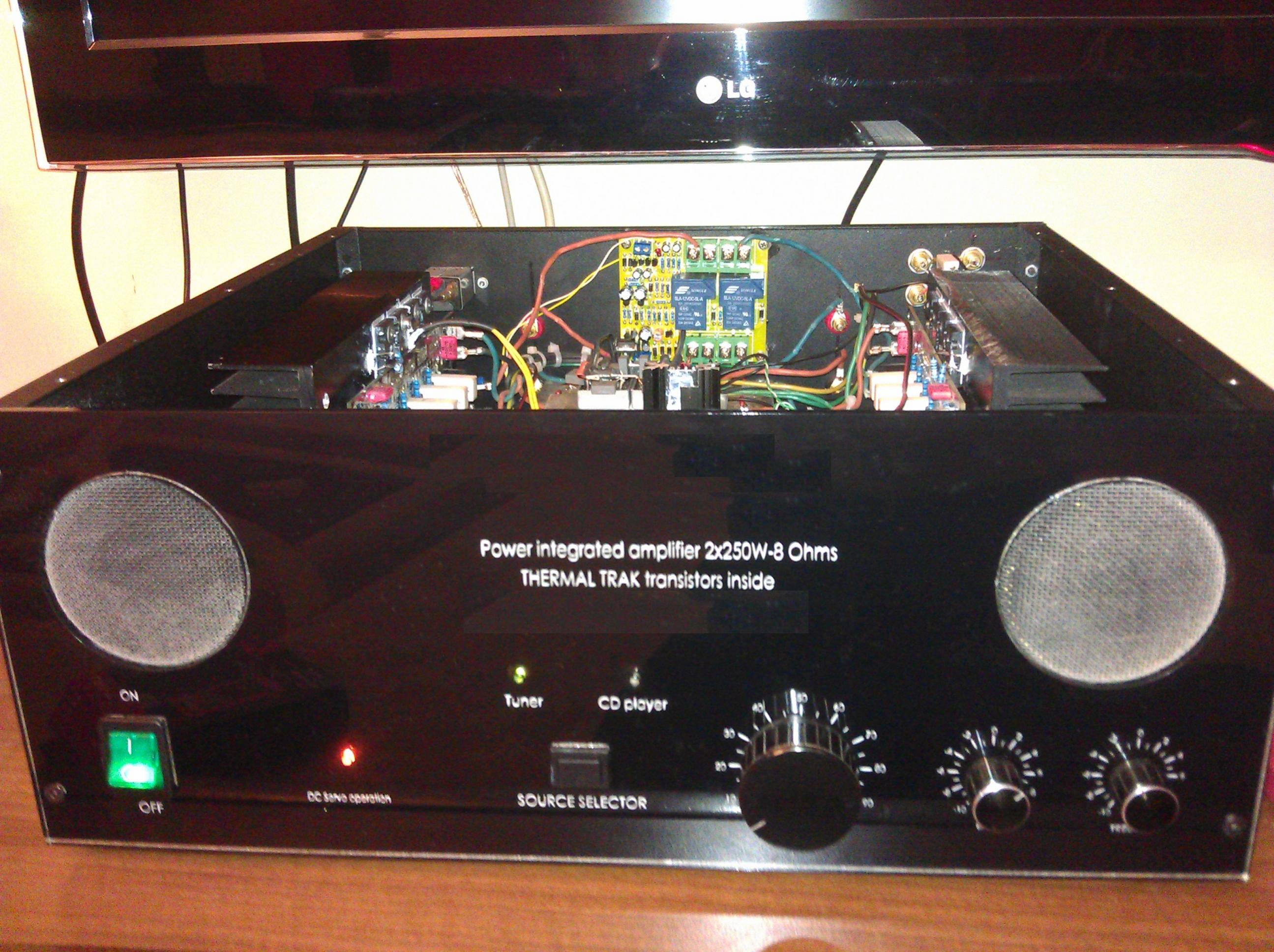

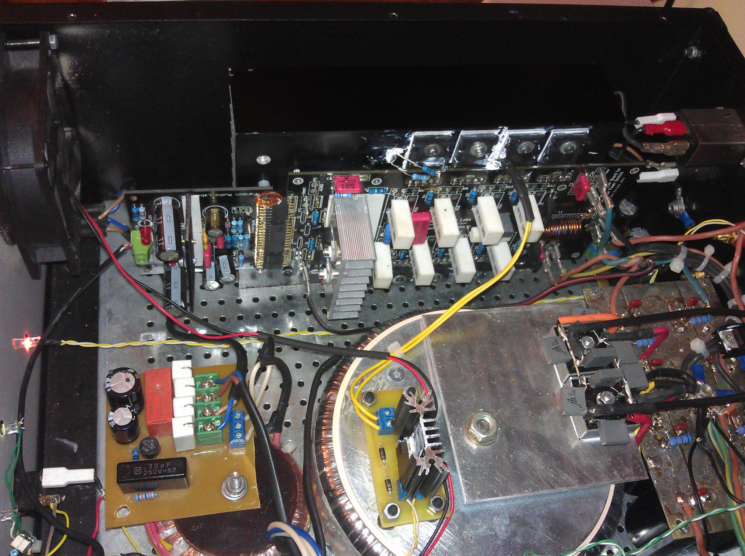

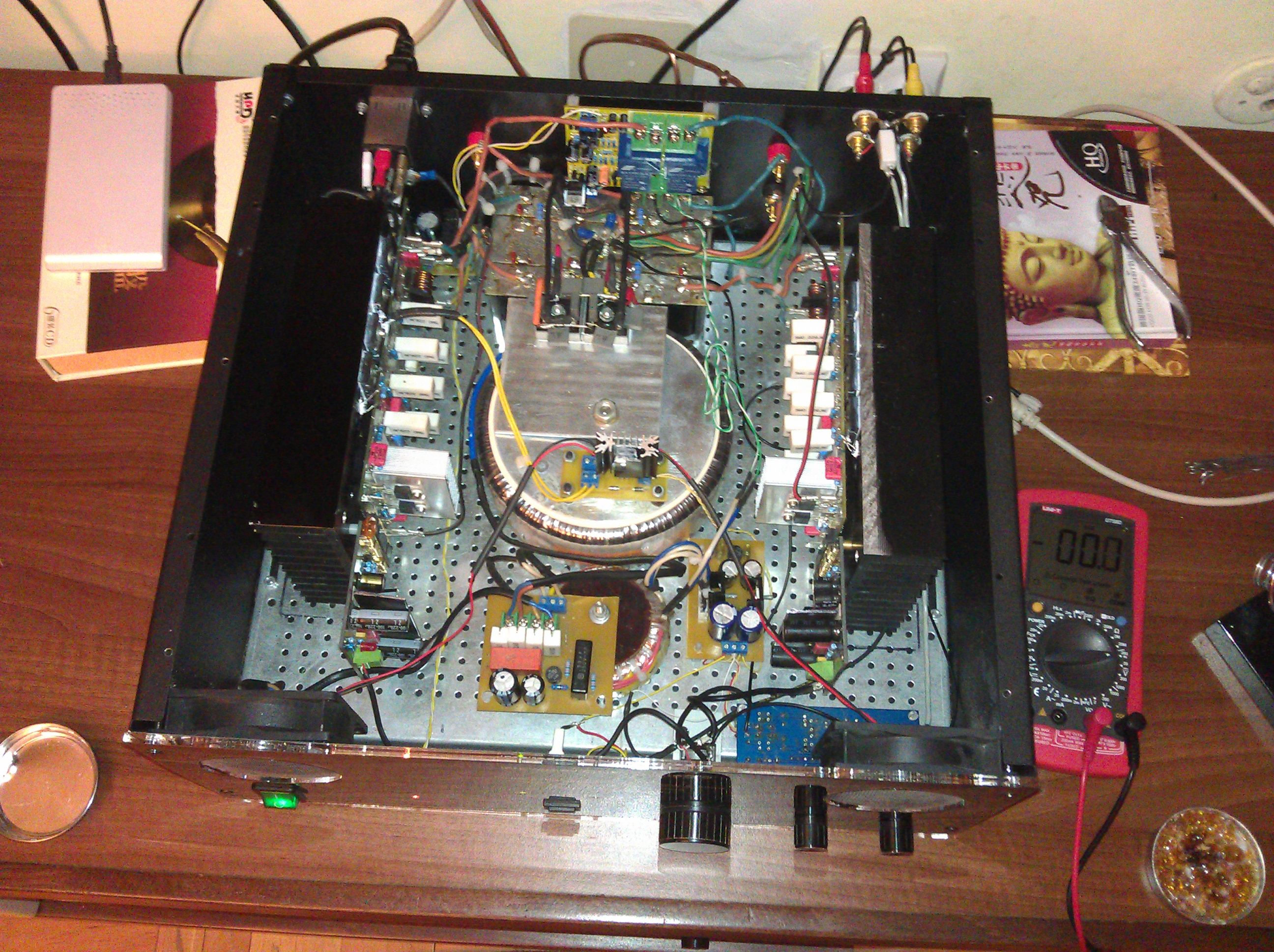

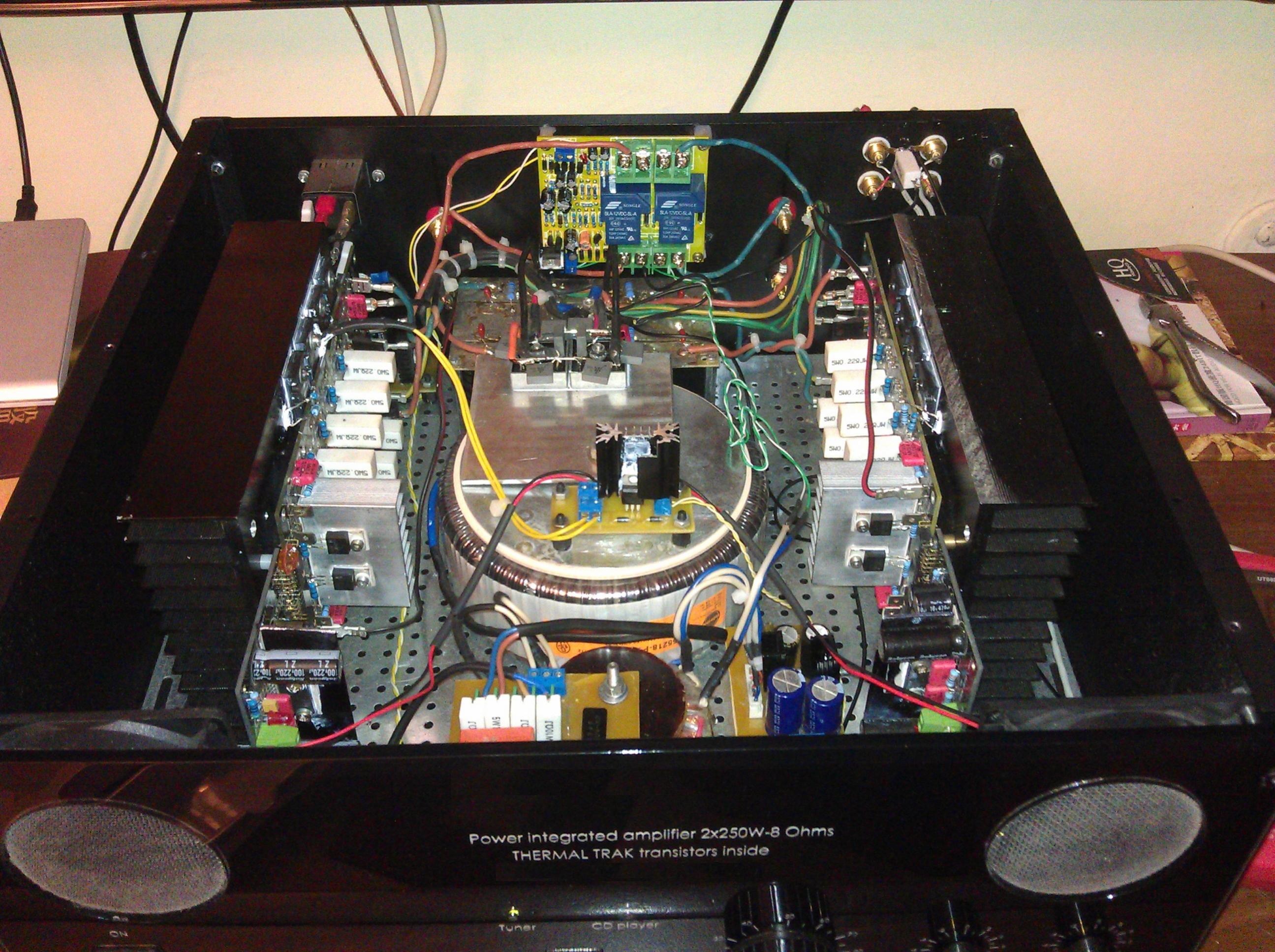

Pictures with my LME49810 amplifier. You can see the wiring which is a big mess but sound is perfect, I do not have any hum or his so I declare myself satisfied. I will rearrange all wires ... in the future. 😀
