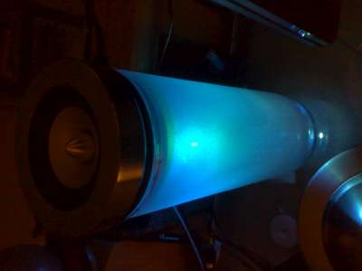

nukaidee said:its just an aluminum cap off some cheap thing i found in my basement. and yes, I need to make a driver screen or whatever you call it, but it looks so cool showing the cone and the phase plug/cap? anyone have any ideas for a translucent / half tennis ball shaped dome?
No (mostly) acoustically transparent cover that you can put over that will keep the most pernicious stuff out of the gap. Gravity (with the aide of the cone's funnel) will suck all sorts of dust right down into the gap and reduce the life of your speaker dramatically.

uh oh. the seal is sticky too, alot of dust i already tried to blow it out with compressed air.. i dont think thats good for it?

oh ugh. now i have to go shopping for acoustic transparent and stops dust. frick. can i use like a pop filter for a mic or something?
ps. I just modded them a little more, they now have RGB LED's hanging in the middle of them =)

You might have to find different drivers that use a dust cap. The MarkAudio that were discussed recently use a dust cap but I think they are 4"ers. Maybe they make some that will fit.

Aura, HiVi, TB, Fostex all make 3" speakers with dustcaps that you could face upwards. Of the ones i've played with the Aura does best sealed. Marl Audio makes a 2" and a 3" -- bezels on the baskets are larger.

I don't think any cover is gonna keep enough of the dust and debris out. If you are gonna have them mounted facing upwards you can't use an open voice coil with phase plug set-up, you gotta use a driver with a dust cap. Your set-up will work for awhile but the gap will wear and damage the speaker.
kk. what is a phase plug exactly? i thought they were the same thing.. shoot! right now its basically airtight, I can do an upwards facing (similar to a microphone cap) screen on it.. i hope it'll save it.
The phase plug is the bullet shaped item in the center of the cone. The thin gap between them is the area of concern. Some speakers have no phase plug and that area is covered with a dust cap which is glued in place. Woofers usually have a dust cap instead of phase plug.
......or lay them on their sides and problem solved. It'd be a shame to undo all your work and such cool looking speakers. Do an upward facing design next using the same bottles.

ugh. can anyone recommend similar drivers then? how fast will these drivers die like that? are we talking 2-3 years or 10 yrs or 1-2 months?
Upside down will work. Might sound real surround soundy and might boost the bass some with the gain off the dest top. You could even try the deflector panels you mentioned earlier. Are you gonna make some stands to hold them up?
yep, acrylic feet =) but for the mean time I just made a screen that's covering the driver, it doesn't look as cool without the exposed phase plug, but I guess it'll have to do for now. Its just speaker screen material mounted to the aluminimum ring. the ring is approx 1.5 mm higher than the cone so nothing is touching and its sealed for now.

Have you tried them down firing yet? I turned some computer speakers to face down towards my desk top and I noticed some of the higher frequencies went away, actually made them sound a little less harsh.

im' still pointing them up, my room is big enough (19 ft celing) that the highs don't bother me. my center channel pair is in stereo, many lower end amps only have 1 center channel. the 100hz cut on mine is based on dolby lisences. so its amp independent. actually im not sure about if its stereo or not, because there is no need for it to be, under dolby pro logic, its just sending anything that sums the same in LR to the center.
