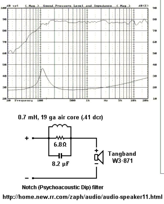

nukaidee said:Alright, my glass tubes/bottles are ready at 1.8L, they're a little over the 1.66 vas of the drivers. I think I'll need a HPF at approx 80hz. what value of capacitor will I need?
Trying to do a passive at that frequency is very difficult as that is right near system resonance. Better to put a cap in front of the amplifier.
dave
dave
Seconded. Harrison labs sells some products for this if you want adjustable/removable.
nukaidee said:you mean put a cap in line with the input signal before the amp?
Yes. I'd try it without 1st.
dave

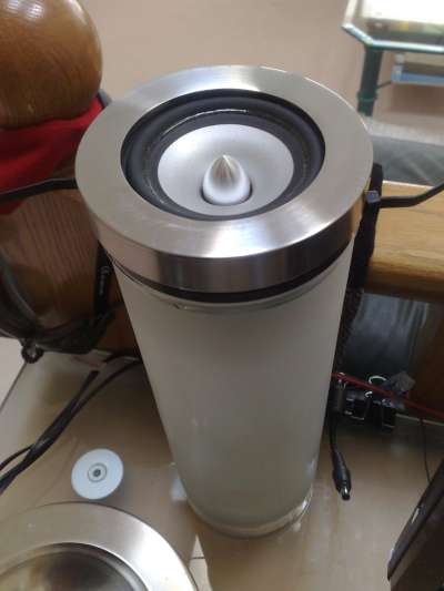

Oh jeez. ran into a problem.. I just realized i cannot run my wires out of the bottle! you think I can lift it with a 3" automotive gasket of sorts?
oh side note, I think I want to keep them standing upright, I think this might have an adverse effect on my high frequencies, I know sometimes people place a cone / V shaped object over the driver to help bounce the sounds? is there a name for that?
thanks
thanks
no no, i planned for it to be a sealed bottle, smaller volume needed. i'll have to get pictures over the weekend. Its just the driver frame rests perfectly on the sides of the bottle and now there is no room for me to snake wires out ><! i tried connecting it to a little bluetooth and battery amp i had.. it was cool, glass bottle making sound without wires, but that is not a feasible design...

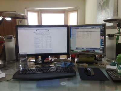

change of plans! i just built one and decided it sounds so nice I'm just going to use it as a center speaker. so now my new plan is to use these and 2 center speakers. (my onkyo sv727 has that feature) .. my setup is unconventional. my mainspeakers and sub are behind me, so its nice to have these 2 little ones on my desk. now im totally surrounded in bliss =) Guess I won't need a cap or anything either, my drivers are facing up so I think the notch filter is not really needed since i'm off axis and in "normal" pro logic mode only 100hz and up are sent to it =)
They look really cool that way except an open voice coil facing upwards risks damage from dust and debris being funneled into the gap between the phase plug and cone. Not trying to rain on yer parade.
What is the metal ring on top of the speaker? Really finishes it off nicely.
