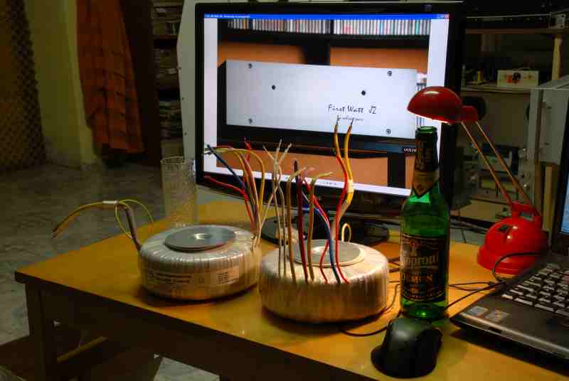

Today visited me sajti.
Brought for me two tranny.
Right, that these not for free, but almost yeah!
So what can I do with these?
I have ideas, but may I count on your opinions?
So the big resolution foto appears the tranny's specifications:
http://i2gofw.bay.livefilestore.com/y1ppi8M6sHGKFYIR3znRhyKc5kpK5JeoFWCVY3i8GCOkvS7clNG7NeVK6EPb07K1bv-4hUAZwCUYRg1CYc1yacQ2TYRkf3cHdM3/DSC_02910001_1.JPG?psid=1
1000VA
2x25V/20A
2x160V/50mA
6.3V/2A
Eh, not so bad?
So this is my question:
I would like to use it these for my F4's.
With something kind of tube VAS.
Mine big quest is:
The expected DC voltage is about 35V.
Will this kill my F4 amplifiers?
Especially the specious JFETS.
I would be sad about this.
Any opinion?

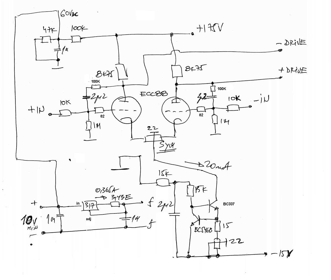

what sort of tube VAS ?
use this - without input fet buffer ( some values need tweaking for your needs and input caps at F4 needs consideration of arrangement , because of voltage , but principle is there) :
