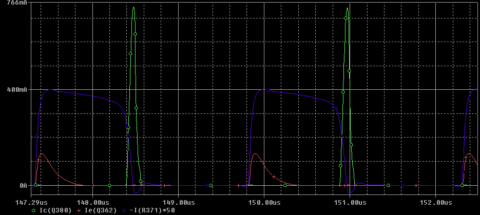

By using some more components, I've been able to get some better results.
Output slew rate is between 2V/ns to 4V/ns with +/-36V supply. The transistors are rated to 5V/ns.
Worst rise time 38ns, best rise time 30ns
Worst fall time 64ns, best fall time 46ns
I believe that the difference between rise times or fall times are due to the output inductor helping or not with the switching. If this it right, the deadtime is somewhere arround 64ns-46ns=18ns. Looking at the waveforms I've spotted what looks like 30ns of deadtime.
Better results can probably be achived by fitting with the zenor voltages.
I've changed the comperator stage a bit, to improve the slew rate.
Schottky diodes has been added to the output stage, to improve current spikes while switching. These can probably be left out, since it dosn't matter that much.
