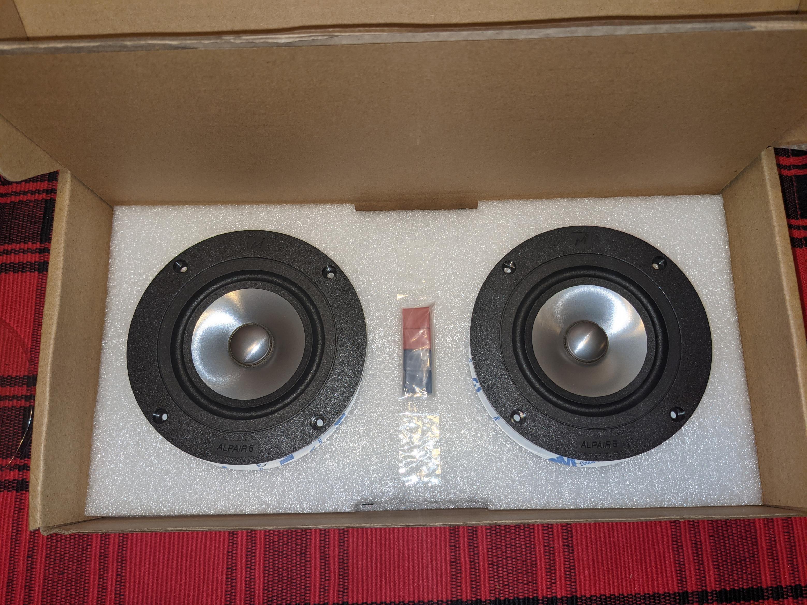

So here is my Alpair 5.3 generation 3. David you never told me how awesome these little gems look. I can't wait to use them. Now for the woofer search? I am very impressed on how these look drivers look. 😁. Am glad I don't have small children around. To nervous all these.years..now I don't have.to.worry. So am very excited.to build the tyson. Jeff

The RS225-8 is an excellent woofer for a FAST system. It has exceptionally wide bandwidth so you can easily cross as high as 900Hz even. But 300Hz is no problem. They are relatively cost effective too for having such low distortion and high Xmax.
I wouldn’t go smaller than 8in for a woofer to help out a full range. 6.5in just isn’t enough IMO.
We have done more than 1 design with 2 x 6.5, they make no excuses.
And if you can use a pair push-push you get huge advantages in terms of reduced box-vibrational-load.
There are too many compromises one needs to make, and far too much variation in driver capability to make the generazation you have X.
dave
