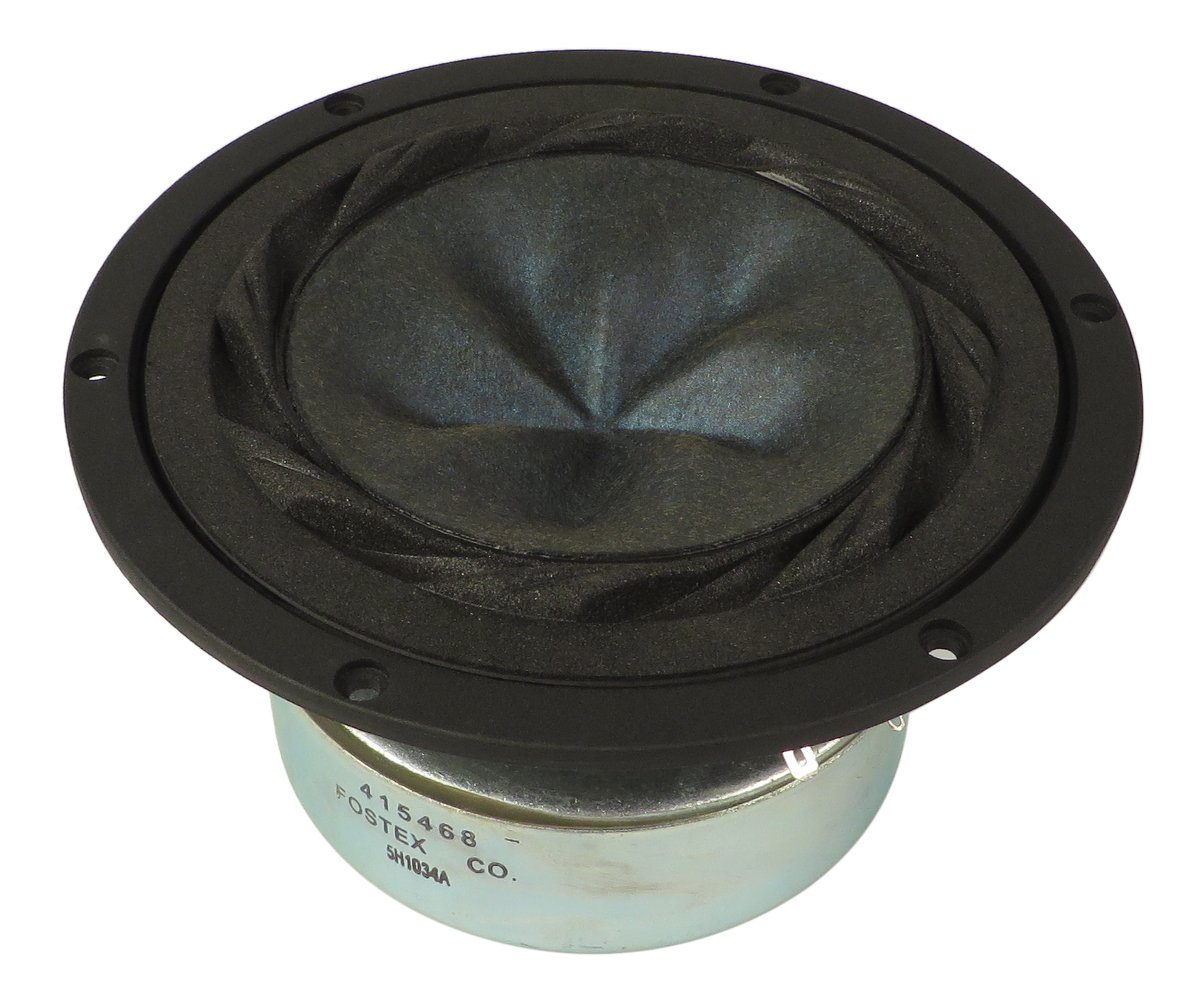

I ordered the Mark Audio Alpair 5.3 drivers in gray from Madisound. I'm looking at a 8 ohm 6 1/2 driver's for the sides that have a paper sound..I will know more this coming weekend to see if they are still available at their sale price? Jeff
I tired to paste a link with my new phone. Ugh. I can send you the link in your planet 10 E mail Dave. Tell me what you think ?Jeff
(Update) I had to use my computer. Here is the link to the driver am looking at? Fostex 8578100100 Woofer For NX-6A | Full Compass Systems.
Might be pulling my woofer tester #2 out to measure these drivers? David please tell me what you think of this driver for the side woofer in the Tyson build? Thanks Jeff

This one:
NX-6A. I assume 6”. These (or similar) were used in a fantastic little 2-way. Even less than the W14. Get 4.
Some sort of measure will be needed as a starting point for getting the right box load.
dave
dave
They com eout of these: NX-6A : Powered Nearfield Monitors
350 x 230 x 334mm (hwd) est 19 litres less the volume of the amplifier.
Given the box, an ML-TL is probably doable.

Thanks David for your help again. Am glade.you have used these drivers before. That helps out alot. so Can I do one driver per..side of the cabinet or do I have to do 2 drivers per..side? Thanks Jeff
I haven’t used them, but was very impressed with the boxes they were in at the 1999 AES in NYNY. Always wanted to play with some.
dave
dave
So here's the update. Ugh so full compass parts got back with me and said they can order more of these drivers for me. The problem is they said that the price is out dated and now are full price. Now that's a bunch of trash. So now am looking at drivers again. Jeff
