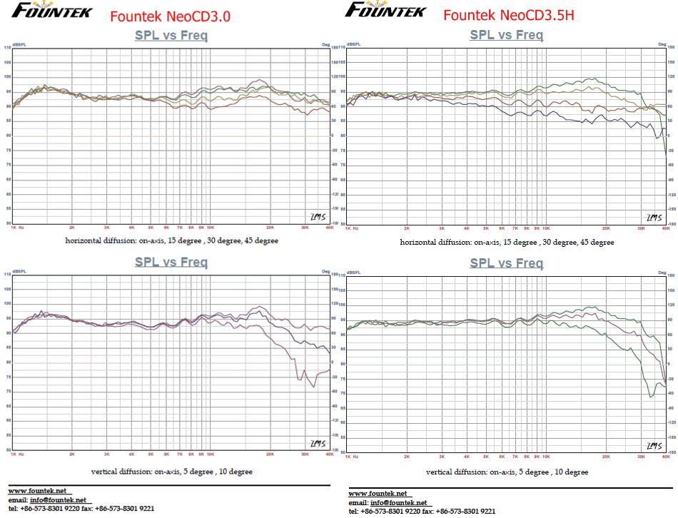

Perhaps it was not fair to compare CD2 to CD3.5H
But here are Fountek's own datasheet graphs of dispersion of CD3.0 and CD3.5.
Any way - I am pleased with 3.5H and it has very wide listening angle! My measurements show that contrary to round/ellipsoid waveguides of Dave and many others - around 15kHz dispersion holds continuity better. Effect of horn termination/edge? It is almost a rule to see a dip at on-axis response of a waveguide tweeter at 15kHz - and see it disappear at 15¤ or more. This dip on-axis is perhaps the reason why many disregard waveguides and coaxials, so sad!

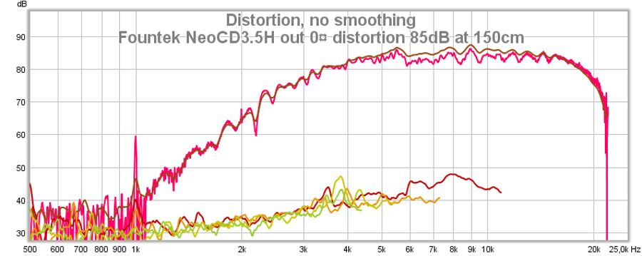

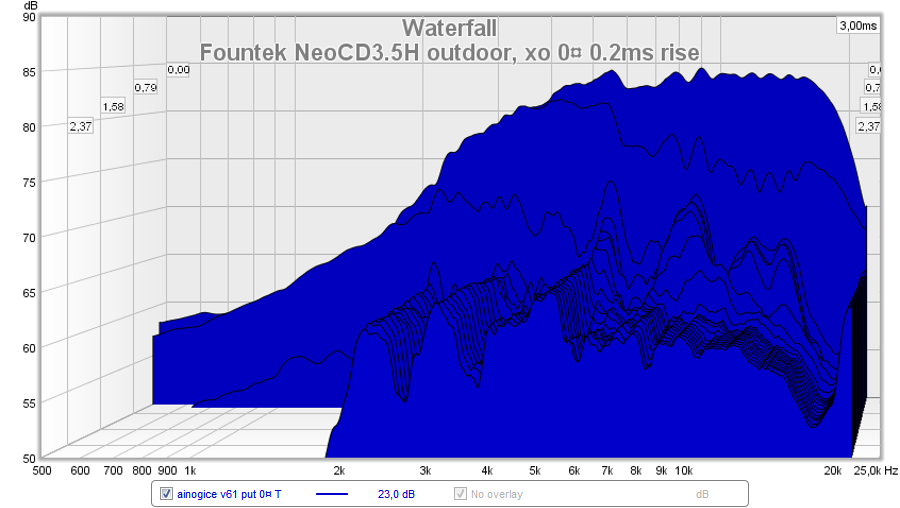

Waterfall plots / distortion didn't look so good with the 3.5H from the measurements from the only person that I've seen post such measurements, could you post those measurements? I'd like to see a second opinion. Maybe I'll try the 3.5H (I already have some Vifa XT25 tweeters and the 6.5 inch waveguides, but I've yet to machine them to fit...) I was also thinking about the D.P. waveguides. $70 for a pair of the waveguides seems a bit too expensive - but, since I aready have the XT25 tweeters, I suppose it is less than buying a pair of 3.5H...
I usually have pretty good luck removing that dip. It really depends on the tweeter. Sometimes there is no dip at all. Other times I can remove it with a step between the adapter plate and the guide. Sometimes a phase plug works but usually it creates other problems. I've been able to remove it on axis then have it show up off axis. As I said it just depends on the tweeter and I'm not sure why it happens. It does seem to have to do with the throat size. If I reduce down so the throat is the size of the dome that will sometimes remove it.My measurements show that contrary to round/ellipsoid waveguides of Dave and many others - around 15kHz dispersion holds continuity better. Effect of horn termination/edge? It is almost a rule to see a dip at on-axis response of a waveguide tweeter at 15kHz - and see it disappear at 15¤ or more. This dip on-axis is perhaps the reason why many disregard waveguides and coaxials, so sad!
Dave
critofur, my Fountek NeoCD3.5H is nude and it is a part of my AINOgradient. I have lots of measurements of it. Here outdoor csd and distortion measured at 150cm. Xo is done by minidsp and if I remember right it is LR2 at3000Hz or like here. The directivity is 10¤ intervals 6ms gating, distance 120cm, xo at 3300Hz LR4.
I believe this is as good as it can be! The horn helps the speaker to maintain low distortion and I have tested it wit 2200Hz LR4 without any problems with distortion, but of course the there is some. A wider frame would make directivity worse I guess or at leas make more diffractions. Here the frame is the driver's own frame w=98mm. The baffle thickness is 12mm+4mm from the driver.

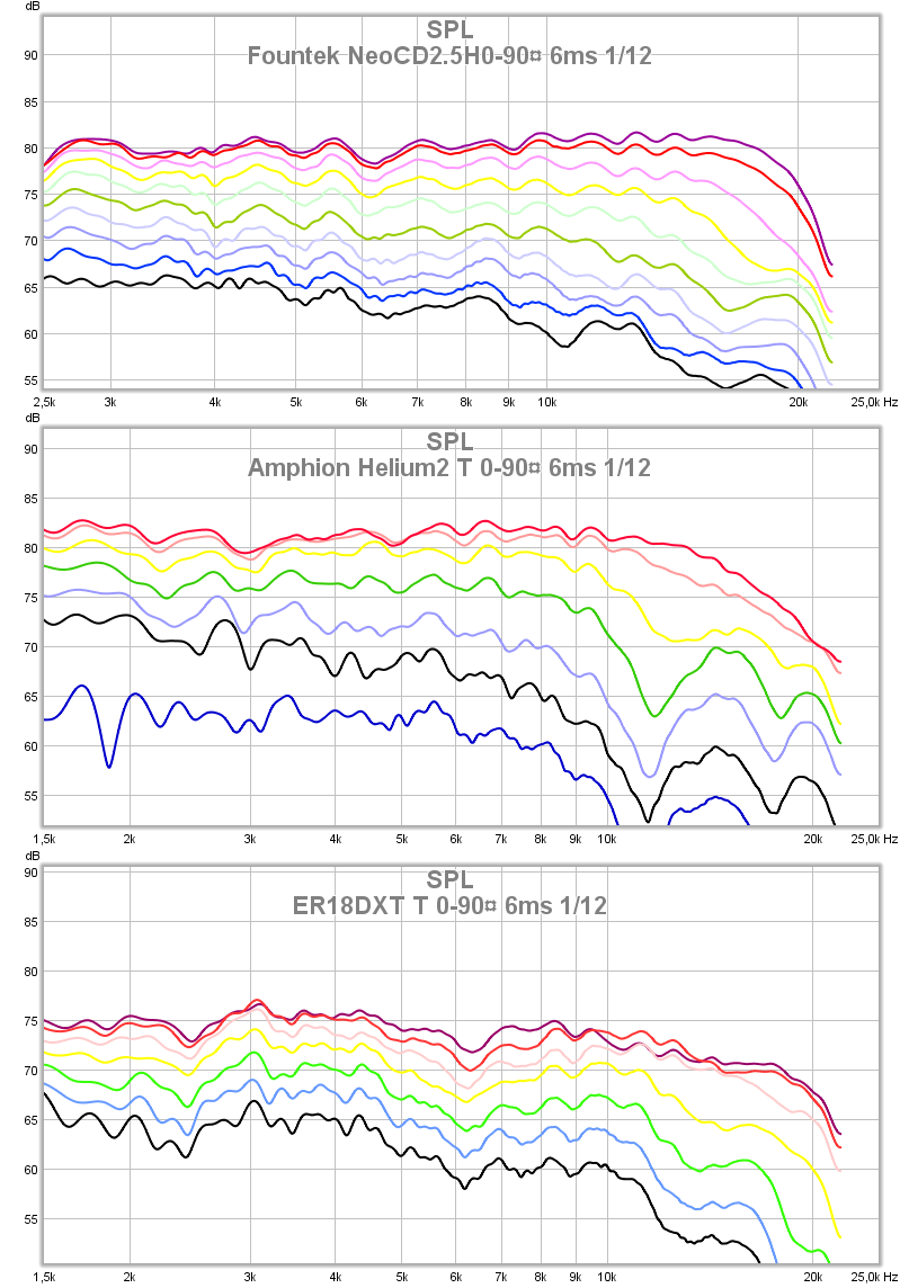

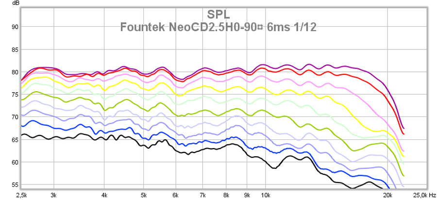

Here are my similar indoor measurements of the Audax tweeter with a waveguide in Amphion Helium2 and directivity of SEAS 27DXT in cabinet w= 195mm driver offset and nude Fountek NeoCD3.5H. The dxt is measured as complete speaker like all directivities) Amphion and ER18DXT speakers measured at height between w and t (T is not on-axis at 0¤!!!)
