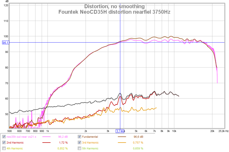

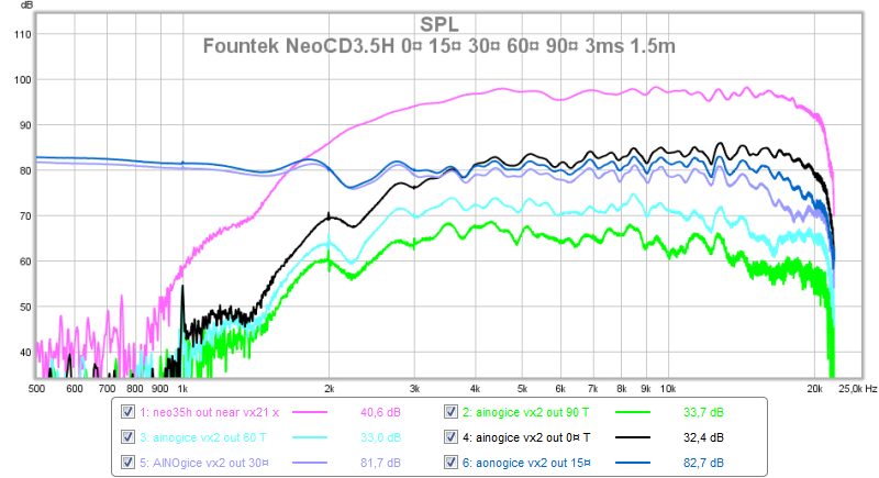

This is getting more out of line, but as to discussion about wg edges and horns - an example of how Fountek NeoCD3.5H performs. It has a small horn with 1.5cm flat edges. I use it as nude, no frame!
My own outdoor measurements. Violet is nearfiel, others are taken at 1.5m distance (5'), 3ms gating. All with 6.8uF cap in series and LR4 xo at 2500Hz set in minidsp. Not bad at all 😉 But distortion rises below 2kHz and we must be careful of not destroying the membrane.

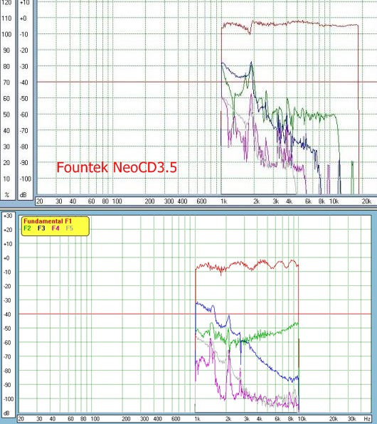

The data sheet shows no loading from the horn other than a big peak over 10K. The idea is to use a big enough WG to load the tweeter so a cap then lowers the distortion while returning the response back to flat. To have lift at 1500 you would need 8-9" of wave guide.
The Fountek CD3.5H has internal cap and propably a coil too (impedance dampening) to make it flat on-axis. Basically it is a CD3.0 with a waveguide. If we compare distortion of CD2.0 (Zaph)and 3.5H (PE forum) we can see what the waveguide/horn contributes.
I'm not seeing any drop in distortion. In fact, the F2 looks worse on the 3.5. On a conventional dome, the WG and cap is a 30db drop at 1k for F2.
