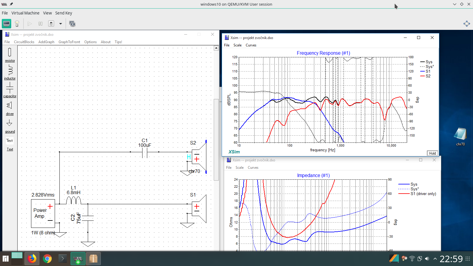

I played with Xsim a little, trying to figure out basic crossovers, and I just found out, I don't have enough info for the Markaudio drivers. I then opened up excel and inserted some values that I read from the official frequency response chart. Has anyone got any good FRD's and ZMA's of these speakers?
Hi, how would this be for a crossover? I only put one capacitor as hpf, just to limit excursion of the fr driver. The lpf, however, is 2nd order.
This crossover is totally imaginary, I don't even know if these values exist nor if they are any good, but the response looks flat enough. I would appreciate opinions.

Trouble is, you are designing a XO not meant for your enclosure and room environment.
There's no zma output from that graph, so, the XO will be flawed as well..
This is just a theoretical xo. An exercise since I never built anything like this is my life. When drivers are in te enclosure, I will measure their frequency response again and work from there. I have no means of measuring impedance, though :S
