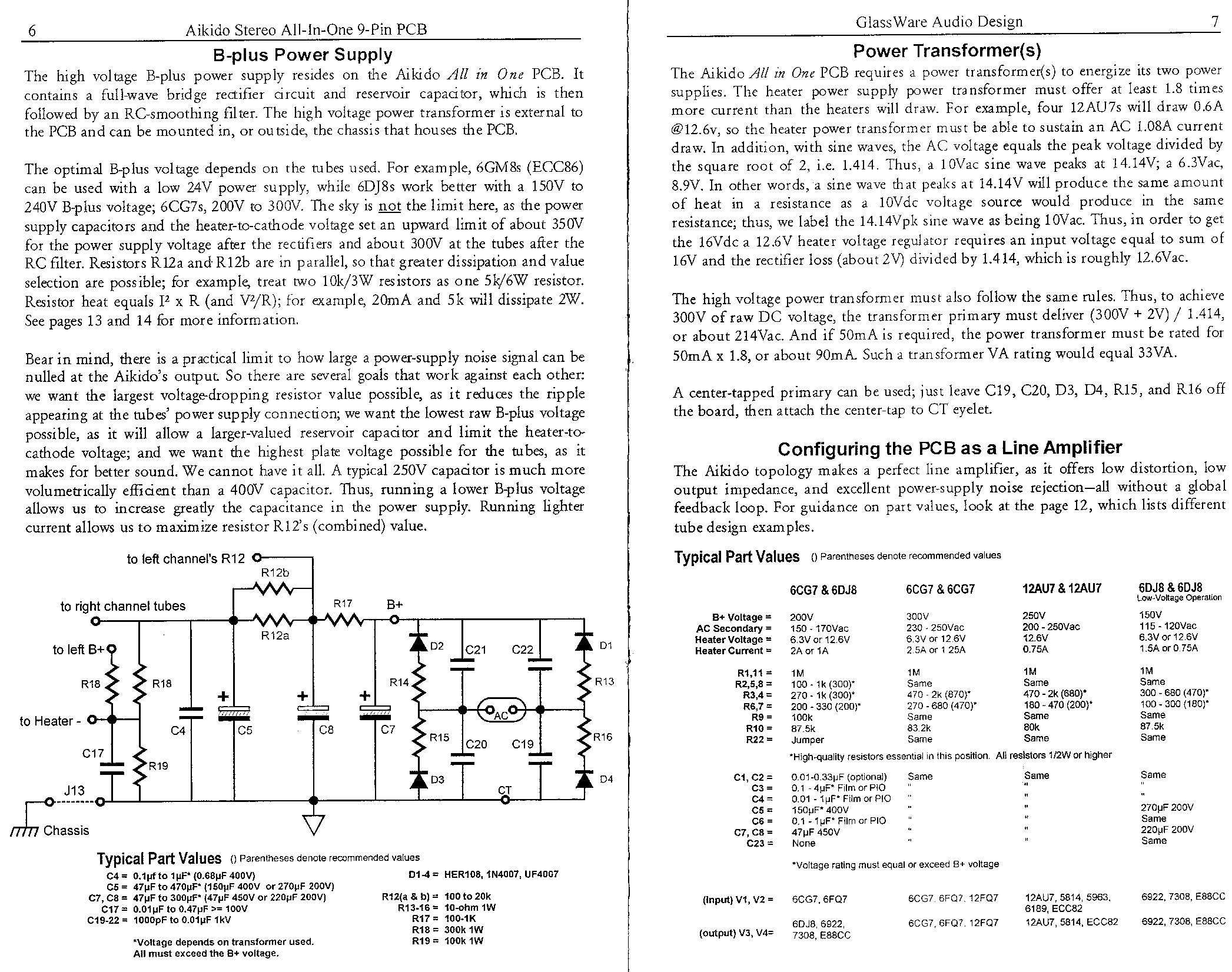

Here is the B+ Page from the 9 Pin All in One Kit Manual.
Look at low voltage operation all the way to the right.
It shows your 6DJ8's for all four tubes.
